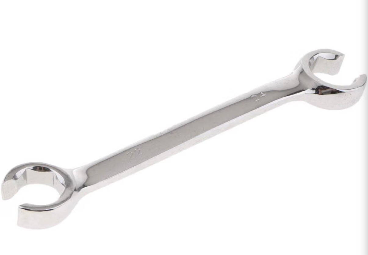

I’ve used a flare nut wrench on my Perkins engine.

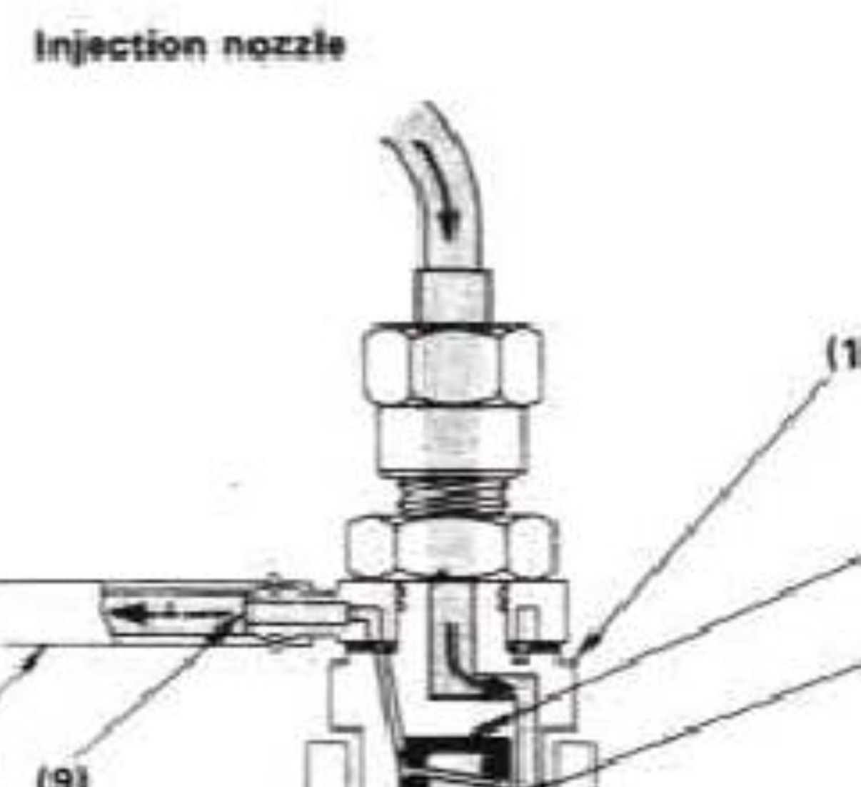

Here is the injector top with the flare nut on top of the injector.
The flare nut wrench fits over the fuel line and is held proud of the bottom nut.
In your case you may need to fit an open end wrench in to hold the bottom nut.

I have one end of the center pipe free so I can fit a box end wrench over both the valve holder and the flare nut. The problem I am having is that the spacing of the three valves is so tight that the wall of the wrench will not fit between them. A thin-wall socket could just barely fit but then you cannot get a wrench on the flare nut.
What I will probably need to do is sacrifice a 19mm box wrench to the special drawer and use the grinder to cut down the wall to make it thin enough to clear the other two valves.
