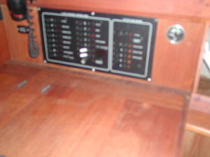

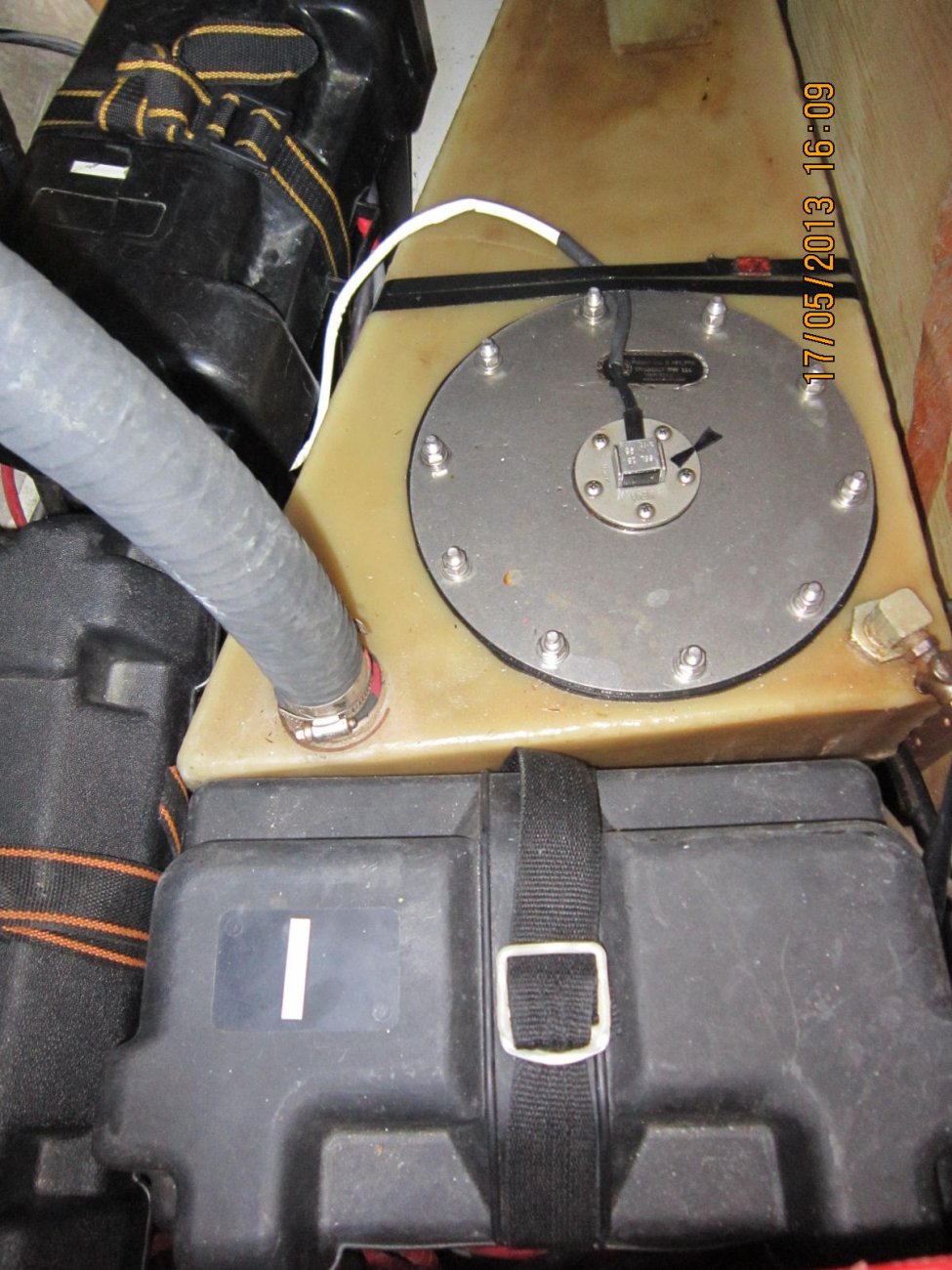

Ditto what Benny said, That is also what I do to calculate burn rate and I generally tell to the fuel pump operator how many liters (or gallons if in the USA) it will take. For ease of a visual quick check when running I nonetheless installed a WEMA gauge when I installed the fuel tank access (http://www.seabuilt.com/) for when I wanted to be able to clean the tank easily and without spills. The gauge itself and the hour meter are installed next to the electrical panel and the sending unit was installed in the middle of the access plate. I feel I have the best of both world !

Thanks Claude for your reply. Looks like a clean installation. I will check this out
