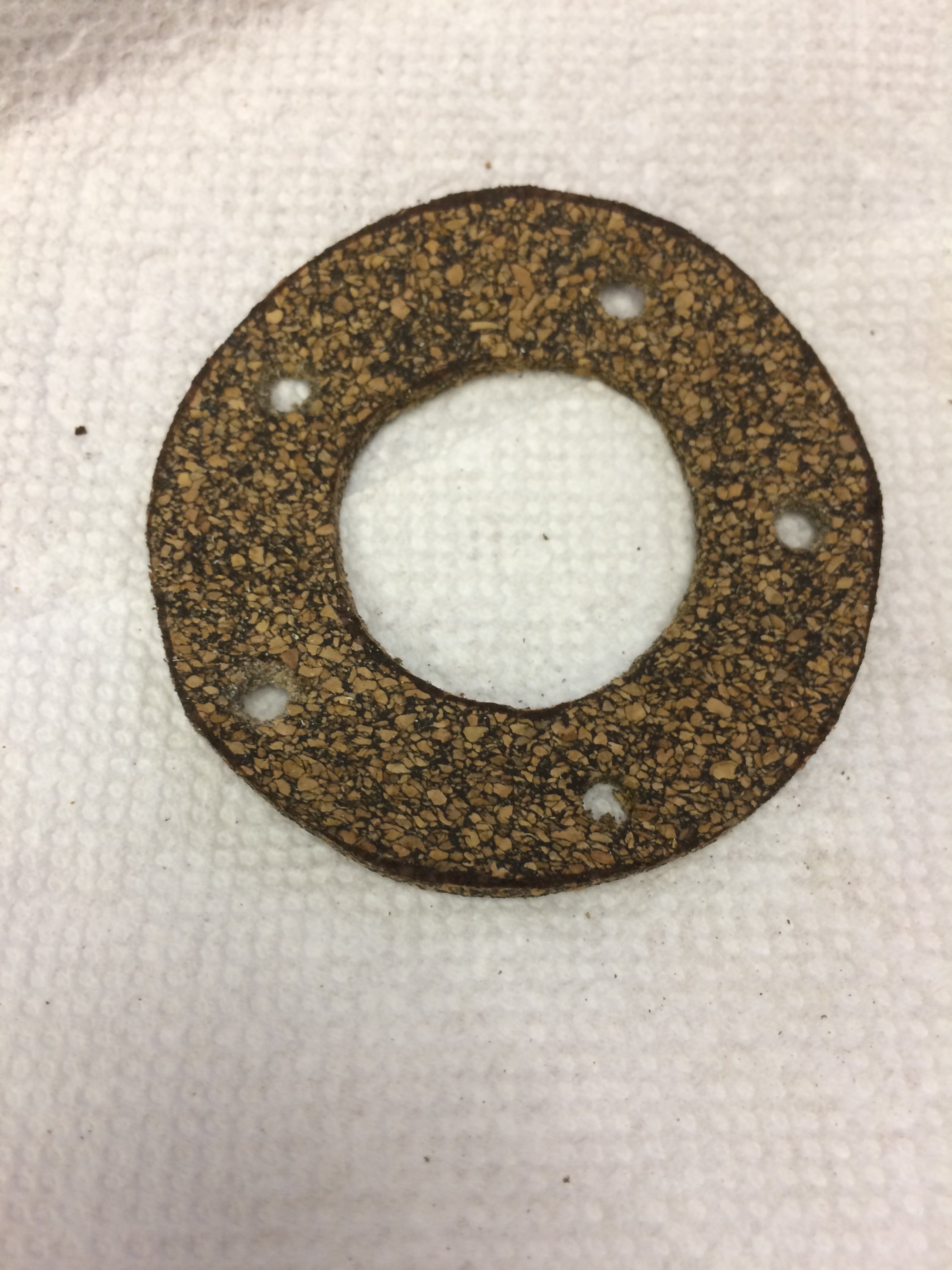

Well. It's now... :). That was too easy. I am going to go back with the same material that got the boat here. Cork.
$6.00 at Napa for a roll. I got a few other projects that can use some cork so they you go

the cork is cheap but is not even close to the best choice, as it permeates and will harden in time... they are almost always a one time use, and do not always give a 100% barrier from sloshing fuel.
