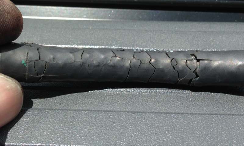

It's in case you haven't checked your fuel lines. This is a little incentive. This is off my mower not my boat. I poured gas into its tank and noticed immediately that it was dripping from the hose.
This little length was downstream of the in line filter before the carb.

Yep....That crap tore up the lines on my dinghy outboard. I need to have them replaced now because of this.
