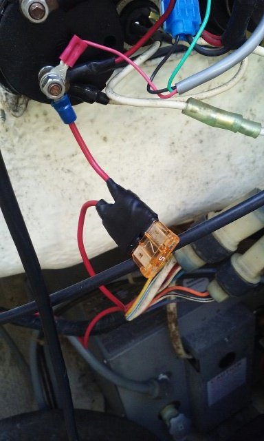

Well I managed to fix the fuel gauge, turned out to be easier than I thought. The fuse holder had made a very poor contact to the fuse. There was no voltage at the gauge because of the fuse. I tried cleaning up the contacts on the fuse & holder with the brass brush but I couldn't get a good connection. So I just built my own fuse holder using a couple of female spade lugs (see attached picture). I do need to replace the fuse with something smaller, 5 amps is a bit large for this application.
Turns out I have nearly a full tank of fuel!
Thanks for the moral support guys!

Sir Michael,
Very clever work around on the fuse holder! I'll have to remember that trick!
23,548
Agreed ^^^^^^^^^^^^ :worship: Well done!
I have the straight glass fuses, but have some of those on board anyway, good trick to know.
