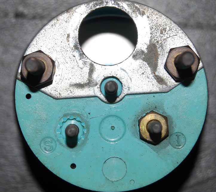

I'm still working on getting all my gauges working. Right now, I'm struggling with my original fuel gauge. The tank sender was shot, so I ordered a new Wema unit; however, no matter what I do, I only get a full reading when on and empty when off. I'll attach a shot of the connections at the back of the gauge. Based on the original connections (and logic), it seems the center post is 12V in, the left post, marked "S", goes to the center, and the right post, marked "I", goes to ground. I've tried this with the original wiring (which all tests good), and on the bench at home. Regardless of whether the sender is connected to the "S" post, the gauge pegs on the full side as soon as power is given to it (I've slid the float up and down, with no change). I'm grounding the other sender connection to the same point as the gauge.
Time for a new gauge, or am I doing something wrong? The pointer moves in a very nice, dampened way, toward "E", when power is removed, so I thought there was hope for it.

"I" usually means ignition, and, thus, (+) power, not ground.
Here's a Teleflex tach wiring manual: http://c34.org/manuals/S024.pdf
Try Googling Teleflex and find more diagrams and instructions.
I had thought that "I" was power initially, but when I connected my DMM to it and the unlabeled post, I got a negative voltage reading. I'll try it the other way, just in case (again, I got these results with the original wiring, untouched, except for the sender wire going to the new sender).

You were right! I just reversed the connections, putting power to the "I" and ground to the unlabeled, and it works perfectly. It's good, I guess, to be the one guy everyone else can feel smarter than!

"I" is ignition switch ON and is +. "S" is the sender from the WEMA gauge which is a pink wire. The grounds are the two nuts touching the metal plate that grounds the light bulb which is missing... Where are you wiring the ignition/12V wire too?
The WEMA gauge does not and should not have 12V flowing through it. They read resistance 33 Ohm's to 240 Ohm's.... Only the gauge gets 12V power through the "I" terminal. I hope you did not toast the sender or the gauge but the gauges are cheap...

Luckily, I don't think I ever ran power through the sender. I just (and I think the PO) had the power and ground wires reversed. All is working perfectly. (I've got the bulb pulled to test it.) Those Wema folks, BTW, were very helpful. I'd misplaced the instructions and they sent me .pdf replacements pronto. Those say, oddly enough, that the pink wire is the ground and the black goes to the sensor, the opposite of what I'd thought. I'm looking forward to needing something else from Wema in the future.
