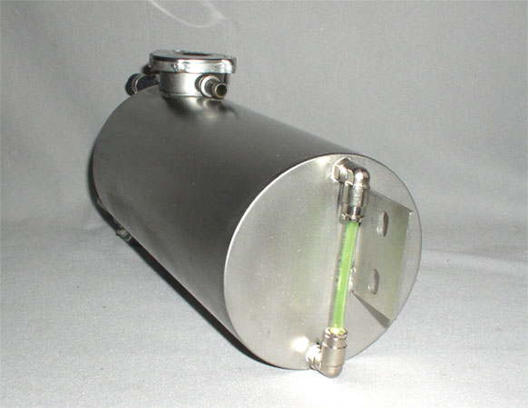

Fuel gauges are notoriously inaccurate regardless of the manufacture. Sometimes greater accuracy can be found by removing the sending unit and bending and or straightening the float arm so it falls closer to the bottom, or rises closer to the top, but ultimately giving a greater range of movement. Some panel gauges can also be adjusted (compensated) to read the sender more accurately. But realize that voltage has an effect, so its never going to be 100% reliable no matter what you do. The best suggestion is to use a dip stick in the tank like were taught to do with airplanes, or install a sight tube in the tank allowing you to see the actual level. Second is to know the average hourly maximum fuel consumption and keep track of the time and always top off the tank.

As Stu said, a sight gauge will not work on a Catalina 30, or most any sailboat, because you can only view the top of the tank, where the existing gauge is installed. Although I was thinking of cutting a sight hole in the wooden coverplate where the tank is located at the aft end bunk board. I only view my fuel gauge about once a month, because it is so friggin hard to access the gauge, since you have to remove everything placed on top of the tank to see it.
