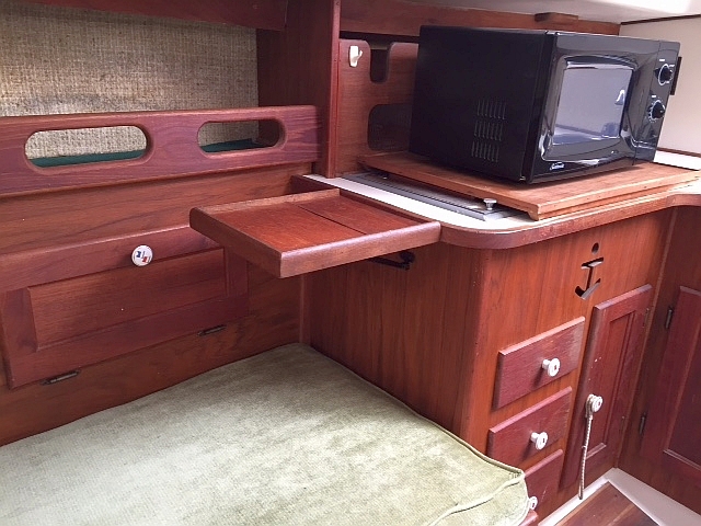

So I've posted a few simple questions about my "new to me" H30C. The response from those contributors on SBO was awesome...and now I need to ask another chucklehead question. Today I was able to go through the boat without the PO. I discovered this incredibly clean cook top (stove) underneath a cutting board with a microwave on top. The stove is a two burner, gimbled, piece of art in my mind. My simple question is what fuel to pour into the stove. I discovered a fairly aged (surfaces rusted) can of Coleman Fluid (camping stove white gas) in the starboard lazerette, but nothing associated with "alcohol" for the "Alcohol Stove". What are the cooks within the Hunter fleet cooking with these day?

you have shown us a photo of the microwave and the pop-up counter space, so why dont you show us a photo of the stove?...
