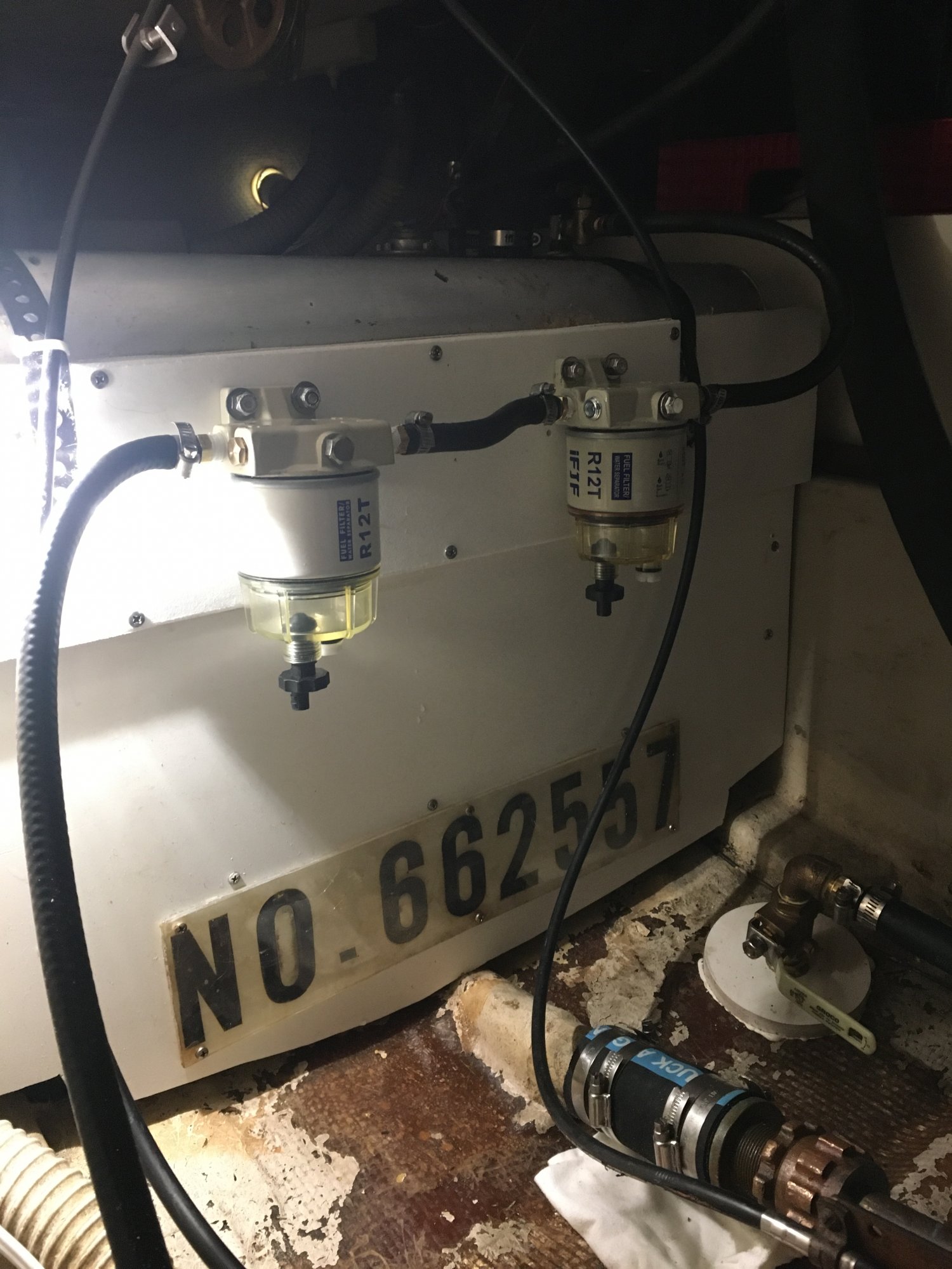

I installed a purolator 35gph in my 30' Oday.
Set up from tank to engine is tank>30 micron > 10 micron> Fuel Pump> Engine mounted Napa Gold Filter> Engine. (this picture shows two 10 microns, its since been changed)
OVERKILL you say? Yes, however after multiple fuel/water issues, I'm playing it safe.
This little pump is working great and I have a spare ready with quick disconnect on the wires, should I have to swap out while out on the water. Its affordable and worth having, if not just for peace of mind.
Pump runs with no fuel starvation at all.
If you main issue is water, the series filters won’t help. The first filter will fill up with water and block all flow (water or fuel) to the second filter. Your better off putting the two in parallel and going with either 10 or 30 micron filters.

Prior to me purchasing my boat, the boat sat on the hard for three years.Within three months, I got it so I could splash it and get it a mile up river to my slip. My first long trip to check out upgrades on my engine, I ended up being towed back to my slip. (1st water in tank related fiasco). I decided I was going to remove the fuel via the electric fuel pump. Parker filter, (non serviceable) was filled up with crap, growth and water very quickly. (2nd water related fiasco). Using a manual siphon hose, I emptied the tank into multiple fuel containers. Took the fuel home and polished it. While the tank was empty (just a little fuel, crap, growth and water still in there) I decided I would pull it out and clean it thoroughly. Yeah, right!. Tank could not be pulled out through the lazareatte. Filler neck was one inch too big. So I tilted it to empty the remainder into a plastic wash basin. Out came some really disgusting stuff. I rinsed it out with some fuel tank cleaner after letting the cleaner sit for a week. Then let it air dry. In the mean time I built my tank holder frame and put it all back. As a maintenance and precaution task, I changed out the o ring on the cap. Said to myself " Self, where the hell is the o ring?" No bloody wonder there is water in the fuel tank. Three seasons of winter snow and ice melting plus all the rain!!!!!
I hear what your saying about a bypass system, and I'm considering making it happen. Just need to figure a design that's simple and I can incorporate some parts I have in my "ONE DAY I'LL NEED THIS" box.
Boy do I know that experience. Since putting "O" rings on my fuel filler caps, I have been "WATER" free and less fuel filter issues/changes..
Such a simple concept. Regular maintenance.
Darn, Previous Owner deferred maintenance.

That CG document number won't pass muster. It is not permanenly attached. I removed mine and put the letters right on the hull, then several layers of varnish(I think it was) or maybe epoxy.
Aug 11, 2011
973
O'day 30 313 Georgetown MD
No worries. The authority's that handle document numbers have been notified that the vessel has been registered in MD. I requested that the number be decomissioned. They said that the number will always be associated with the hull number, however in cases where I may be boarded, my MD registration is sufficient.
