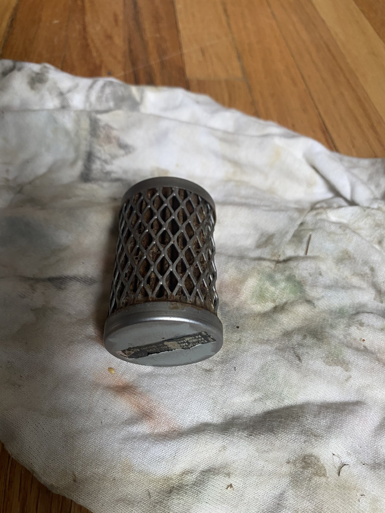

I am trying to find a replacement part for a fuel filter element installed as my primary fuel filter/water separator on my 1984 Catalina 30. I have no idea when this filter was last changed as I have had the boat only a short time but the filter looks very filthy. It is installed past the fuel pump but before the secondary filter on the engine. The engine is a Universal M25, 21HP. The boat information that I had suggested that it should be a Racor R24T filter as the primary fuel filter but when I came to replace it, I realize that this is not what is installed on the boat. I am not sure what the brand of the filter assembly is but it is attached to the bulkhead and I needed to remove four screws to remove the plastic transparent bowl where the element is sitting.
I found what I thought was the part number indicated on the part: '55440-1299, Fabricated in South Africa by Donaldson Co', however after I could not find the part on line, I contacted Donaldson and they told me that the part does not show on their system, so it is likely an old part and the number on it is the postal code of their headquarters.... The filter element is approximately 2 5/8" by 1 3/4" diameter. There is room in the glass bowl where the element sits to go a bit larger if this is an acceptable way of replacing the filter, but i am not sure if this is acceptable or what to replace it with. I don't mind using a part from another manufacturer either. I looked on several sites and on different forums but I don't seem to be able to find this setup. Has anyone have any information on a replacement part?
Here is a picture of the filter element.
The correct order should be tank>>primary filter>>fuel pump>>secondary>>engine. This is to prevent the fuel pump being the first filter in line from the tank.
Many if not most Catalinas did come with those Racors. Who knows what a PO may have done.
A picture of the housing would help. I do not recognize the guts of that filter, some others here may be able to do so.

ONCE AGAIN STU STEALS MY THUNDER.... The order that Stu has passed on is imperative ! Best advice that I can give you is to install a new Racor filter and water separator. Don't waste your time trying to find something that might not be available. While there, you might want to replace ALL of the fuel hose too.

Like Stu indicates, the location of the filter is incorrect. Given this and the fact that it seems like an old filter which may be out of production or very hard to find, I would suggest you purchase and properly install a new filter. Something like a Racor Turbine Series 60 or the less expensive Racor Spin-On Filter Kit.

I know the adventure of tracking something down and the excitement of success in capturing your prey, but Stu and Benny are correct. Re-rout the hoses and get a new easy to find filter and housing.
