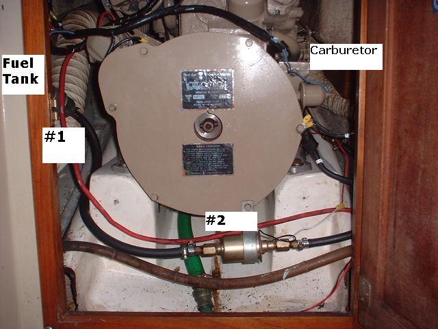

I have a 1982 27'Catalina equipped with a newly rebuilt Atomic-4 gas engine as shown in the attached picture. I am having trouble with condensed water accumulated in the fuel tank. I am not sure if I have the water separator connected in-between the fuel lines. Can some one tell me what are the bronze color devices (#1 and #2) shown in the attached picture, #1 fuel filter and #2 water separator? Where can I buy these fuel filter and water separator? I read something about Racor water separator. What model of Racor water separator can be used on the Atomic-4 gas engine? And should I install it between Fuel tank and #1, or between #1 and #2, or between #2 and Carburetor? What attentions should be brought up if I try to install it by myself? Or is there any instruction document about installations for fuel filter and water separator?

I'm guessing, but it really looks like two filters to me. If so, a Racor filter/separator could replace #1. I don't have the Racor link on this computer, but you can find it easily with a Google search (which will also turn up some sources). They have the specifications that should help you select the correct unit. There is a A4 user group on Sailnet that is reportedly pretty helpful and I'm sure an archive search here or there would turn up something if you can't find something quick.

They look like filters to me. Water separators/filters are usually mounted vertically on a wall, hull, bulkhead and are clear so that you can if there is water present. They also typically have a drain screw to drain off the water. Something you might want to install.

Leon: What you have are in-line filters....They only filter out debris and do nothing for your water problem...What you want to install is a Racor Gasoline Fuel Filter/Water Separator-Spin-On Series.... I use a S3227 Filter and it works just fine....Living in an area of in excess of 120 inches of rain a year I know all about water in fuel...This filter works just fine....Good Luck...

Thanks Dave, I assume that the Racor Gasoline Water Separator should be installed between the fuel tank and #1 fuel filter, right? I checked Racor website and I got confused with models 320R-RAC-01(S3227) w/ See-Thru bowl and 320R-RAC-02 (S3228UL) w/ Metal bowl. Should I use S3228 w/metal bowl which is designed for Inboard engine? And, any special attention that I should have for installing the device? Leon

Leon: I would suggest using the one with the metal bottom....USCG likes that one for gas engines. As for placement, I would take the two in-line filters out of the system...The RACOR is plenty big to filter sediment as well as water. I have mine located on the starboard bulkhead aft of the engine. It is a bit hard to get to a times, so I would say looking at your picture in the front of the engine on the starboard bulkhead would work fine. That way you can get to it readily to "drain" the water from the bottom of the filter. I would suggest not using spliced hoses...hose is cheap and splices always have the possiblity of leaking. Other than that you should be all set to go...Did you get your other problems of smoke and transmission etc. solved.?..DAVE
