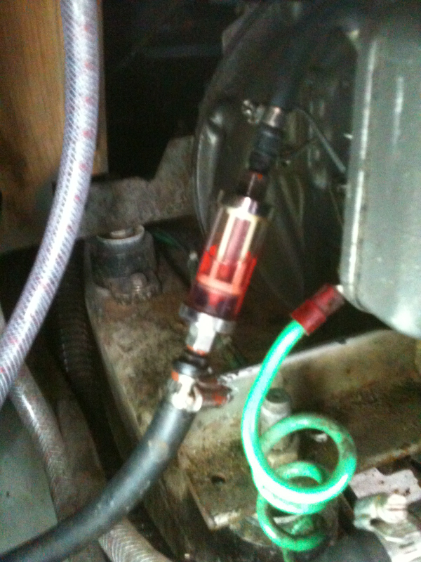

Had a cruiser on the dock today who wants to keep some spares on board for his trip to FL.
We got on the topic of filters and he didn't really know much about the fuel filters on his Yanmar 2Q15. Took a look at it and the inline one looked
Nothing like the one on MDD's site. He has no manuals on board and no part numbers. Can someone ID this for me so I can point him in the right direction?

That looks more like a gasoline style in line fuel filter. Is that acting as his primary filter? Dont think it would do anything but filter out algea maybe and clog up real quick. Normally you would have a primary like a spin-on style (think racor) and then a secondary which could be spin on or drop in filter type, but normally I dont see that style he has unless its a gasoline engine.

It is his secondary. He has a Racor with this one on the engine side. On the Torrensen site I saw the one Tim posted but they look nothing like the one he has. And it is the 2QM15....I checked the ID plate for him.
He sailed to AC non stop from RI for 7 straight days with no spares of anything on board. I don't want him to move on and get jammed up out there without backups.

Not a 'filter' its probably a 'strainer'
Looks like an in-line 'strainer' from a hydraulics shop or 'fluid power' distributor. I cant see from the pic, but it probably has a 'cylindrical screen' made of woven polyethylene or polymer. Typical 'retention' for these are at 100+µM but due to extreme small surface of the 'filter media' become quickly blocked even by much smaller µM particles.
Even if it 'really' is a filter with proper filter removal efficiency .... it too damn small (surface area) to be of any value, other than to totally and VERY quickly shut down flow during a particle 'storm'.

Attwood makes these....This is what I have been using on the fuel line for my 20 year old Nissan outboard for years. If you have the one that has the plastic filter it is easily cleaned and or easily replaced. It works great in helping keeping the main filter on engine to last a lot longer. I found mine at the local wal-mart some 20 + years ago. I have seen them also at academy,O'reallys and other local stores that carry marine supplies. BTW...I have never had it clog to the point were it shut down engine.

Looks like an aftermarket inline filter. Being connected after the Racor it is likely not doing much. I would carry a piece of metal tubing so that I could eliminate that filter in case it ever got plugged. A replacement could likely be found in an auto parts or truck and tractor supply store.

I had one of those things on a Harley years ago, and it about drove me to drinking. Now that I think of it, it did. A piece of crap if there ever was one. I kid you not, I wouldn't take a free wheelbarrow full of them. Do ANYTHING else but that thing.

Got that right Ron. I know they sell these things at "marine stores", and they also sell a lot of other junk that's worthless on a boat as well. Some people can't take advice from someone who has already fought the battle. I was attracted to the silly thing years ago on a bike, because it looked cool, I could see the fuel, etc. But look at it. A THIMBLE full of trash will stop it. And it's made of GLASS. Making it seal correctly was another whole nightmare, and I am a first class mechanic.

Looks like the same one
It's made by Attwood. Replacement filter screen is Attwood #11821-7
http://www.canadiantire.ca/AST/brow...ine+Style+Universal+Fuel+Filter.jsp?locale=en
It protects the fuel lift pump. At least let you see debris before the fuel pump.
The engine mounted fuel filter is after the fuel lift pump.
I bought one for an old Yamaha outboard at west marine years ago, but could not find it. This one at Bass Pro shops likes the same one as well.
