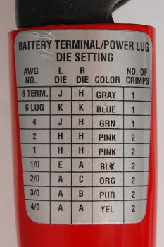

I've been using an FTZ 94284 crimping tool for the battery wiring upgrade project I'm in the middle of. It's been working well, until I tried making some crimps on #4 wire yesterday. They are power lugs, with "J" and "H" and gray markings on the lug. The table on the FTZ tool says:
The color shown there is green, but it's definitely gray on the lug. Oddly, that's also the same die settings and color as a #6 terminal. When I crimp with the J and H the lug pulls off easily. So I switched to K K and didn't fully close the crimper. I know that's less than ideal, but not sure what else to do. I rechecked the calibration of the tool and it's good (16"). Even more odd is that I've used it in the past for #4 power lugs and it worked fine. So either the lugs are completely different (they are not flared starter lugs), or the K K dies have shifted, or I've lost it completely.
Any thoughts about what happened, or what I should do?

Who's power lugs are you using? Are they FTZ branded lugs from a reputable FTZ supplier???
If you go down a size in dies partially crimp to just where a "flag" is starting to form then rotate 90 degrees and partially crimp again. Repeat until you are satisfied and you may even be able to get full closure without any flagging.
Terminals vary from source to source as a lot of companies are importing from China these days. Frustrating but true...

Are these flared stater lugs or lugs with color codes? Heavy Duty 1/0 "Power lugs" should use the dies E & A. 1/0 flared Starter Lugs use dies H & H..

I think I’ve discovered that sometimes the dies don’t come together smoothly, and the crimp ends up offset and looking over crimped. If I hold the adjusting bolt in tight when first closing them it seems to work fine. I’ve got 10 1/0 heavy duty crimps to make tomorrow to finish this project. Boy will I be glad when it’s done!
I'm using the heavy duty 1/0 power lugs with the E & A dies. The dies for 2/0 lugs worked better but I don't think they were tight enough so I spent some time on the phone.
I called genuinedealz and asked who made the lugs they were selling. They switched over to NSPA lugs and feel they are just as good of quality. They admitted they were behind on updating their website to show NSPA as the manufacturer and offered to take them back.
I tried calling FTZ Industries. They blamed it on the non FTZ lugs and said to try different die settings. They asked where I purchased it and when I said Amazon they said it could be a knock off crimper.
I spoke with Maine Sail who gave me some tips on how to make it all work. He also suggested I try calling the seller on Amazon who he thought was legit.
I did but the person I talked to didn't want to confirm the crimper was made by FTZ, just hinted it was. Their suggestion was to return it via Amazon and they would inspect it to see if it was defective because it should crimp the lugs fine. They would let me know what they find.
After all this I considered Maine's question from above.
The crimper is going back to Amazon, the lugs are going back to genuinedealz and I ordered a new FTZ crimper and FTZ lugs from the SBO store, a known reputable supplier.
With something like 30 lugs to crimp and with what I've invested in this project trying to do it right, I'm willing to try again to see if I can get better crimps.

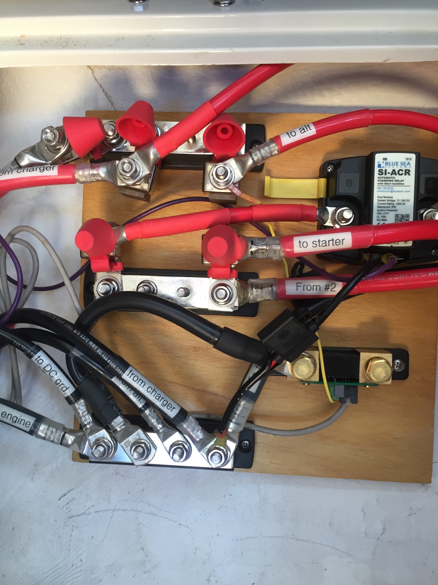

@marchem
Almost done? Any pics?

Looking good! Nicely done on marking all the wires.
I too am trying to cram a lot into a small space. Without a lot of experience to know the tricks and things like how tight can 1/0 wire bend to make a 90 deg connection, it is hard to get it as neat as some do.

You probably should have a fuse on your yellow wire from +12 buss bar to shunt (smaller than the mrbf)
Agreed! A mix of origami and jig saw puzzle! I learned to wait to tighten anything until all the wires are run, because I kept moving them to different studs on the bus bar.
Maine Sail taught me the labeling technique. It’s my wife’s job on this project. She’s being very patient with my obsession.
Mahalo
It’s there, hidden under the “From #2” cable. I know yellow isn’t the best color for it, but that’s the ATC fuse holder I had.

Real nice job @marchem. I liked how you put the little yellow wire above the BIG red alternator wire.. Some error and put it underneath.
It is a tight space and the fit and finish makes sense.
Ok I see the top retainer. Can you get at it without pulling the mrbf?? You can use red tape on the yellow wire.
Looks nice!!
Good ideas. I will reroute the wire. Hopefully never have to replace the fuse, but worth making it easier to do.
