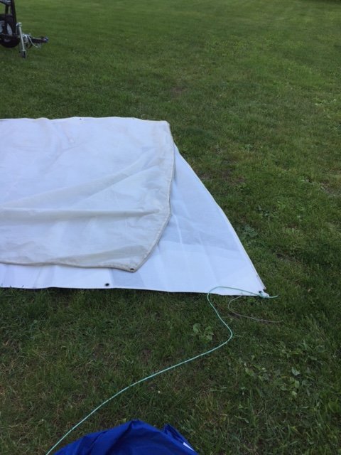

So I took the old sail and laid it on top of the new sail (photo attached). What a difference at the foot. In the photo I have the head, tack, foot & luff aligned perfectly together. Hmmmmm?
Apr 25, 2015
282
Oday 26 Oscoda, MI
Looks like Intensity Sails are designed to fit original set up DS's and not ones with the mast converted to the tabernacle system. Lovely!

something is very wrong with what you've got - John may be onto something, and you've got a pieced together rig. The DS has had essentially the same spec's it's entire life (I've owned and raced 3), and the boom is high for a 17 footer. Your old sail has a very strange foot shape, too. I've attached the DS1 assembly instructions from O'Day, and part 3 of the class rules which shows the rig dimensions.
