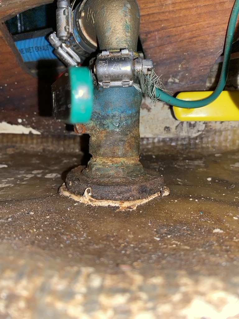

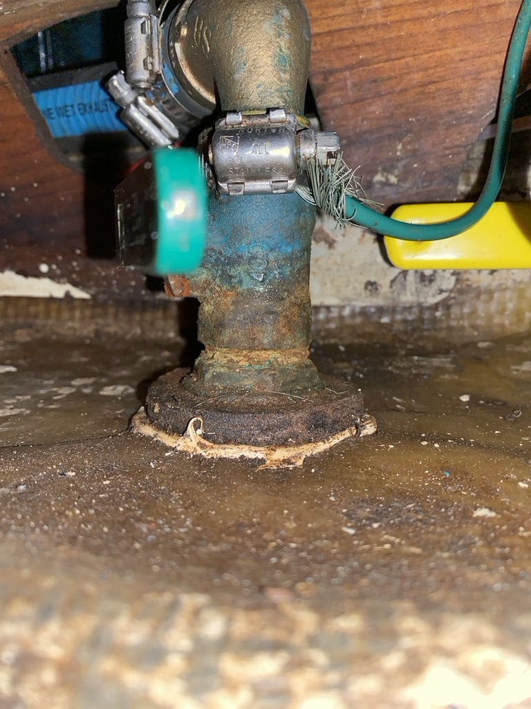

Here are a couple of pictures to show what I mean.
This one shows the old thru hull and valve in place.
It is functioning normally. OPENS AND CLOSES EASILY.
I note that the base, looks suspect. That would be the thru hull not the valve.
So I thought I needed to remove the valve and replace the thru hull.
Then I could reattach the valve.

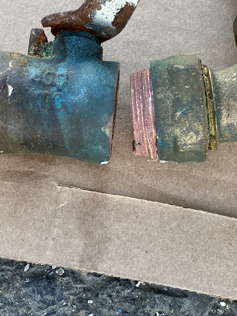

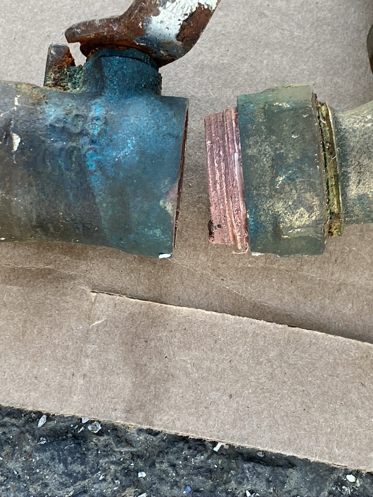

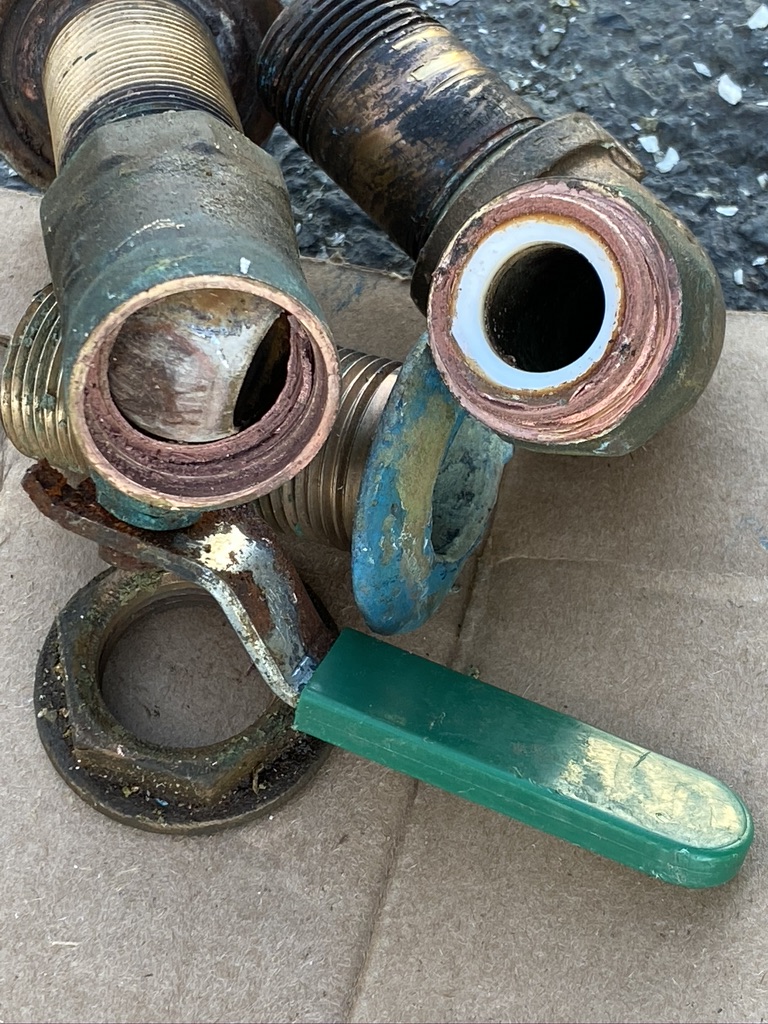

This is the valve that I thought was good. The valve had internal corrosion.
It was ready to fail. Even though the valve was opening and closing,
the upper portion was total gone. It came apart in my hand as I tried to turn it.
I was very happy to be out of the water when this happened.
Be careful with this project. I got lucky.
