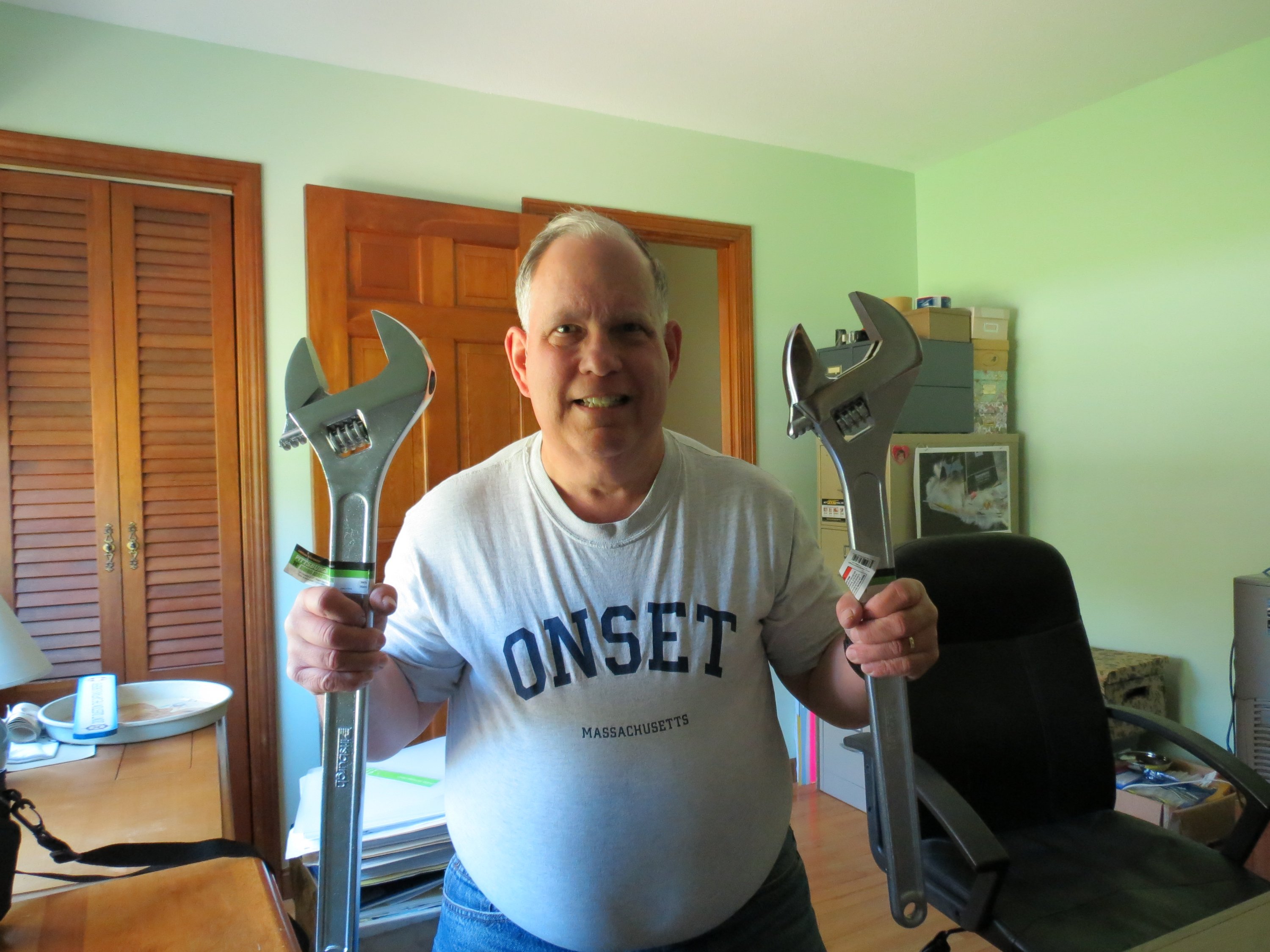

Use PB Blaster. Go to Harbor Freight. 24" Giant adjustable wrenches. Size matters. The wrench pictured above in post #6 works if the nuts aren't frozen, but they are only 10" long.

I'm with RR. Go to Harbor Freight and buy two big crescent wrenches. Every year this thread repeats. I know I am responsible for at least one of the "stuck stuffing box threads" I am sure if you search "stuffing box" you will get a wealth of information. Read them carefully and make sure you don't get any PB Blaster on any rubber parts or seals. Best of luck.
