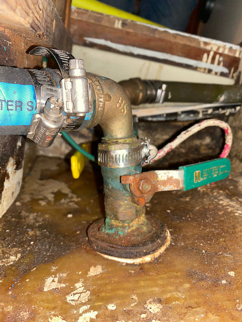

My experience.
This valve worked smoothly from the time I bought the boat to the day I felt I needed to change it. No reason, just a feeling it was time to change. I had a bit of "unexplained water" in the bilge area where these valves were. Just a sponge soak up amount maybe every 45 days.
Looks aged and perhaps the handle could be changed, but the handle worked and the valve worked.

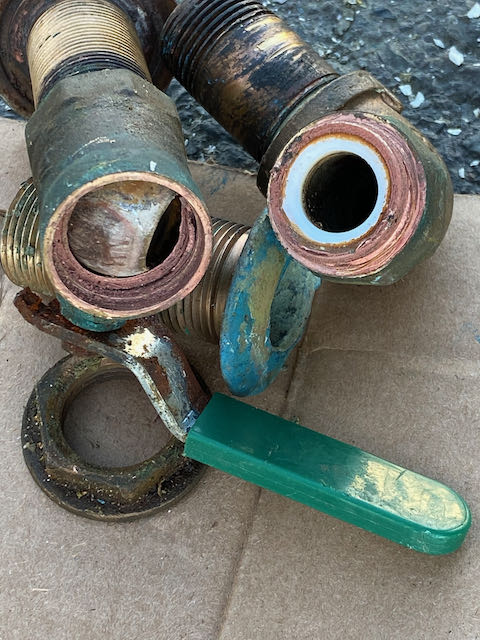

When I decided to pull the boat and replace the valve. With the boat hanging in the sling, I was inside the boat. I reached down and started to turn the valve (unscrew it from the thru hull). It broke apart into two pieces.
The pink metal tells the tail of zinc corrosion from the metal valve.
It broke into my hand, not wrench needed. I was chocked and pleased I had decided to do the replacement.
