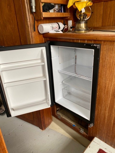

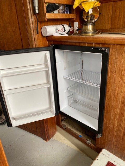

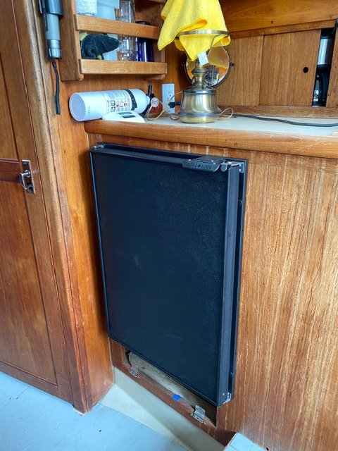

I just installed a NovoKool F3800 in my boat..
It will serve as a cold re-fridge (33-35F).:beer:
We will see how the energy budget goes. I am hopeful it provides good service. They were sure easy to work with, answering questions in prep for the install. Almost looks like original equipment, thanks to the assist by @LeslieTroyer carpentry and work shop.
