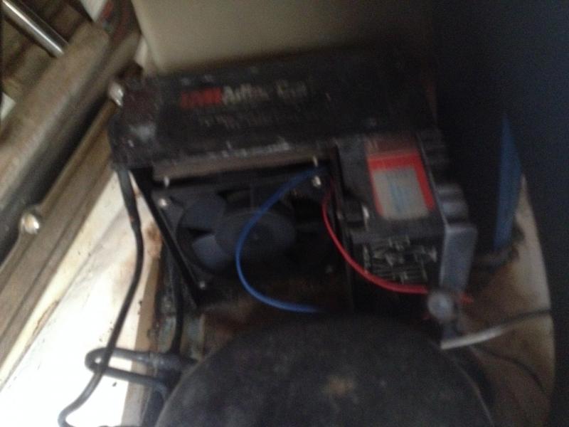

Have a small refrigeration unit on my 1984 H31, which up to now has been outstanding, making ice and working like a Trojan. In the last day, it has stopped working properly. About every 45 seconds the fan comes on for a second, then shuts off again. Any ideas out there?

Thanks Benny. Was going to go over my wiring today. Checked batteries yesterday and they are ok.
The compressor starts every 45 seconds or so, then the fan kicks on for a second, then the whole thing shuts down for another 45 seconds. Does that sound like a capacitor? If it is, how do I get that replaced ? is it something I can just remove a circuit board from somewhere, or do I need a refridgeration guy to come and fix?

IanJ, Generally a simple problem you can correct yourself, compressor microprocessor see a problem that must be corrected and will not allow compressor to run. Do not allow anyone to tamper with refrigerant or connect gauges to your unit.
Troubleshooting 4 pin Danfoss modules consists of the following:
1. Place jumper wire across thermostat terminals, Compressor still does not run.
2. Disconnect black fan wire from electronic module, Compressor runs replace fan. Compressor still does not run after fan ground wire is disconnected. If one of the 10 transistors in this fan fail it can cause module to prevent compressor from running.
3. Run correct size and correct polarity fused jumper wires direct from a fully charged battery to module in order to bypass all boat’s wiring. Volt meter readings are of no value, Compressor still does not run electronic module needs to be tested on another unit.

No if the compressor kicks in is not the capacitor. Sounds like it is getting a signal to shut down from somewhere. Like Richard indicates run some jumper wires to by-pass the thermostat in order to rule out it being faulty. He also suggests to by-pass the boat's wiring and connect the unit input leads directly to a known good battery. This would eliminate the possibility of too much resistance having built up in the wiring. Follow his recommendation and test the fan, if the fan is faulty the control module will shut the compressor down to avoid it from overheating. If it does run without the fan just shut if off quickly and get a replacement. If all fails Then you may really need a new control module. When old units start breaking down there is the possibility of it becoming a long series of part replacements so gauge the cost of a new unit against the cost of repairs and the expected service from the unit. Good luck.

Thanks guys. I am going to run Richards tests this weekend, although according to a manual I downloaded, it seems characteristic with being in "protective mode". I did incorporate an on/off switch about eight months ago, and will bypass that and see if that is my problem, although it has been fine up to now. Otherwise, I am going to be asking you Richard how to dismantle so as I can send to you for diagnosis.
