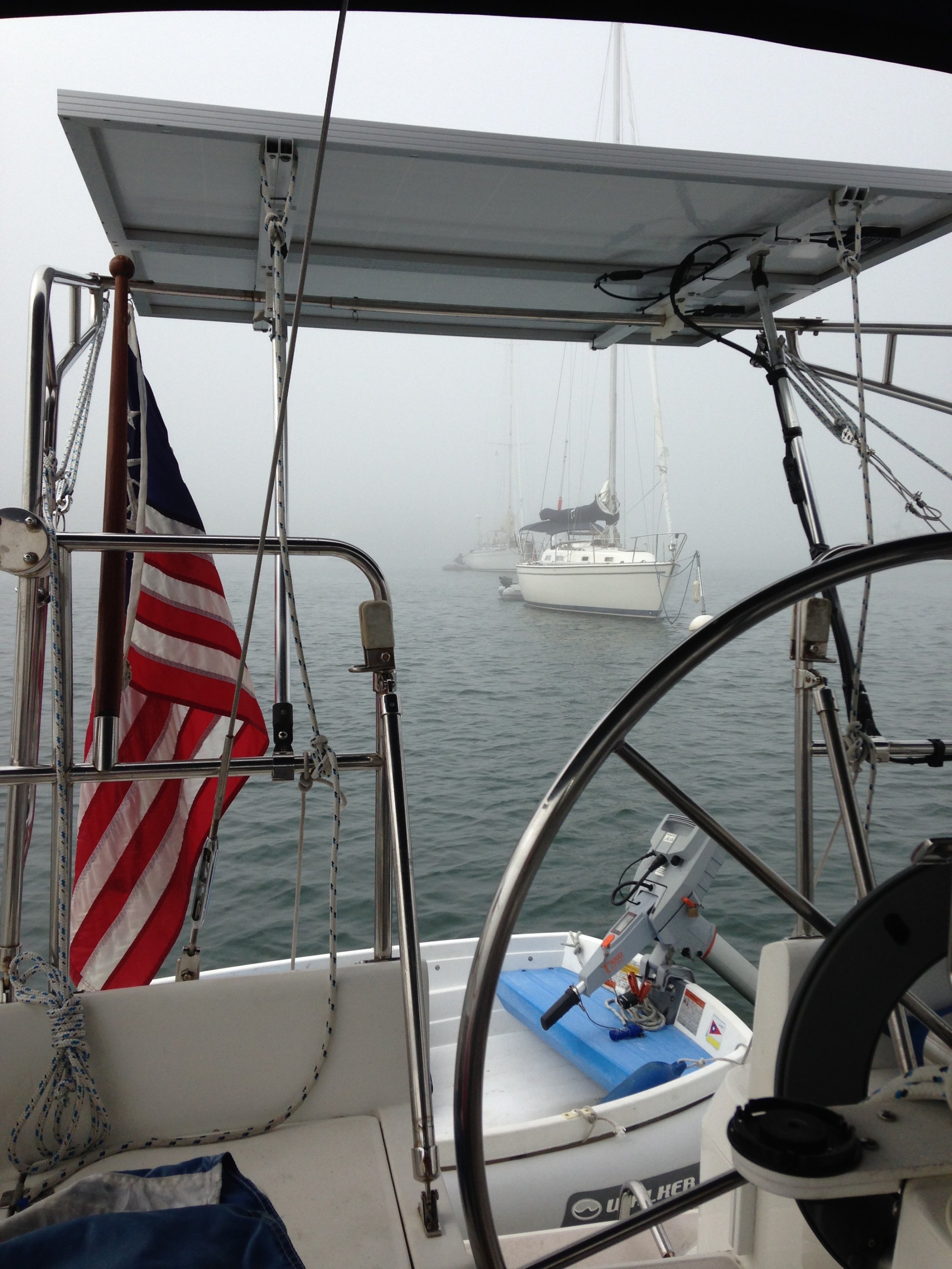

Sorry, I don't have a picture available, Rob, but what I have is two 160 watt panels mounted on davits. I upgraded from a single 135 watt panel. The new panels are from Hamilton Ferris Marine in Falmouth, MA, as is the MPPT controller. The Ferrris controller moniters the batteries and charges through the proper cycles: bulk, absorption, etc. The on-board charger pretty much just maintains a constant voltage.
Part NOs. are: panel KD-250GX, controller PB200. If you call Eric at 508-743-9901, he can set you up with panels, cables, controller and anything else you might need.

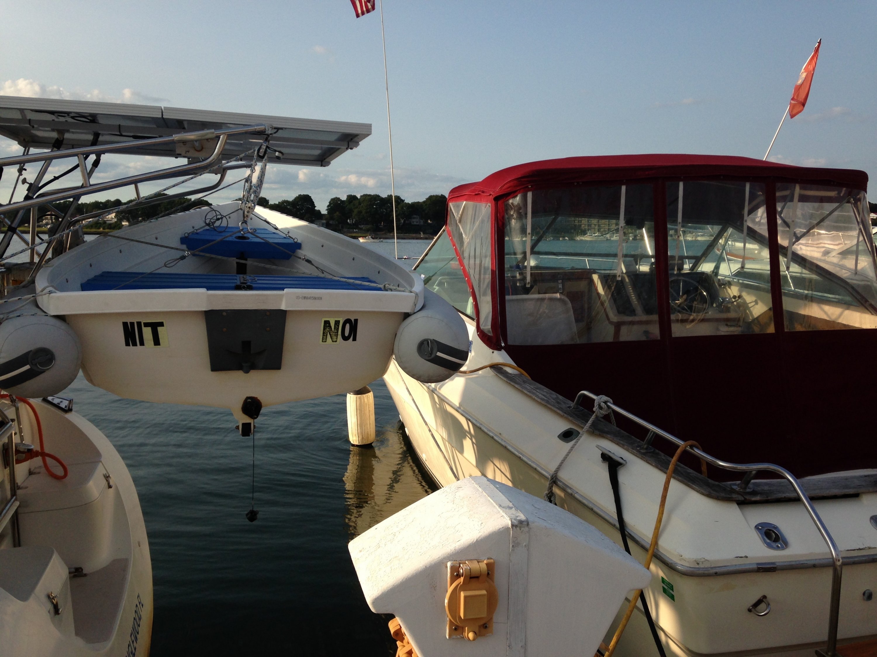

Bob, we have the Walker Bay 8 with a Torqeedo electric outboard. We carry it on davits (see previous post with solar panels) usually, or on the foredeck for extended runs offshore. Its a great dinghy for rowing, carrying people or supplies, or sailing (we have the optional sail kit).
When stowed on the foredeck, it fits nicely upside down just forward of the mast, with the bow of the dinghy resting on the anchor locker hatch. I put old seat cushions under the transom, and a pad under the bow, and tie the bow eye to the forward cleats of Andante and the aft quarters to the shroud chainplates. I would further secure it with lines over the hull in the case of foul weather.
If I need access to the anchor locker or the cabin hatch, I attach the spare jib halyard to the bow eye of the dinghy and lift the front of the dinghy up to level or higher. At that point, I might tie the painter off to stanchion bases to stabilize the dinghy. To launch the dinghy, I again use the jib halyard on the bow eye and lift the dinghy straight up and swing it over the side. My WB 8 has the inflatable collar, so it is an easy matter to set it right side up in the water without swamping it.

Looks like a good option and of course you have davits just like innthe picture! But even without davits stowing it on the bow is a good option I do not have because my inflatable is too wide to fit on the foredeck. Anyway, good to know about the walker bay 8.
