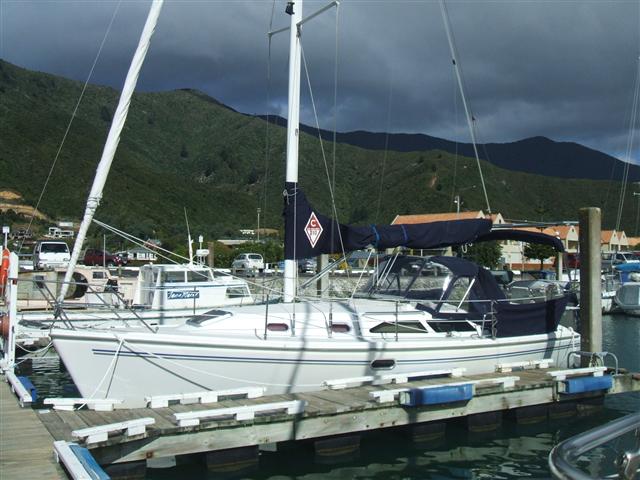

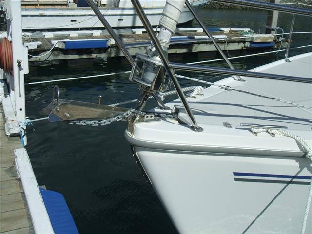

Stu, where was this in New Zealand?
I wonder if this was home port for of Oceania?
Interesting solar cell panel mounts, welded directly to the existing railing. The dink arrangement would help some by putting the weight a little closer. I wonder where he keeps his motor. Looks like a big grill as well?
23,320
It was in a harbor right outside of Picton, north end of the South Island.
