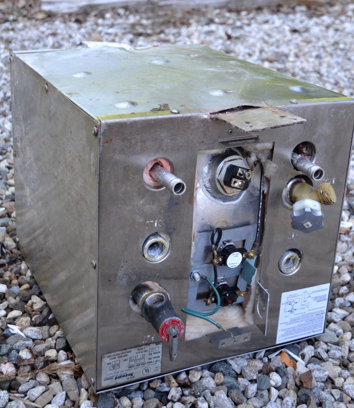

Because the proper protocol for winterizing a hot water heater is to:
A) Drain it
B) By-pass it
There is, and should be, no AF in the water heater...
Why do we do this?

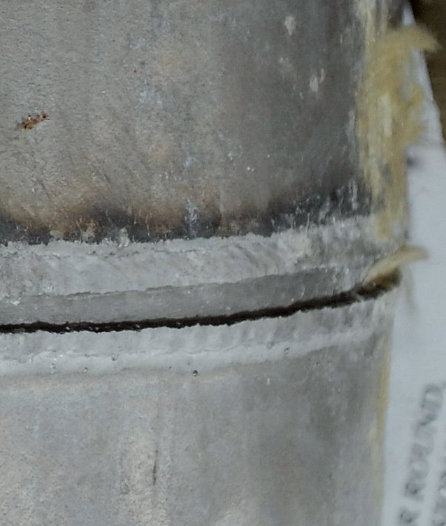

Because it is nearly impossible to properly freeze protect a water heater by pumping AF through it. It would require so much AF, to not get diluted, as to not be cost effective...
Course I get customers who have tried an improper winterizing almost ever spring..
Not bypassed & drained = Cha-Ching $$$$$$: (owner claimed he sucked in 6 gallons)
Here's another water heater that was improperly winterized. This is the actuall pressure vessel... Cha-ching $$$$$

The 10 gallon water heater on the Tartan doesn't seem to have a drain tap as on the Seward you show. As mine is installed, there appears to be a bypass installed, with a valve on the input, one on the output, and a hose connecting them together. At the bottom one, there's a petcock pointing down. I opened it, and water drained, but I'm not sure I drained all of it. At the top, opposite where the petcock would be, there's a fitting that looks like a hose barb, and inside, a ball and spring. Could this be a pressure relief?
Any advice on making sure its drained, how to tell?
Thanks,
jv
Feb 6, 1998
11,704
This is one reason I don't like pre-installed valved water heater by-pass kits. In order to properly drain the tank you need to let air into it, preferably from the near the top, so water can drain out of it.. When you manually disconnect the hot water outlet supply feed from the tank, to bypass it, this breaks the air seal and the tank can then drain out the cold water supply/inlet..
Breaking open the T&P (temperature & pressure relief valve) in many, no make that most cases, it destroys the seat/seal in the T&P and it will likely not re-seal again as it originally did. Only break the T&P as an absolute last resort.
Once the tank has manually drained blast a bit of air into the cold water feed to force as much out the drain valve as you can.
Unfortunately the cheap aluminum vessel water heaters are most often inadequately plumbed as they ship and require custom piping, including a drain valve and thermostatic mixing valve, when you install them.
