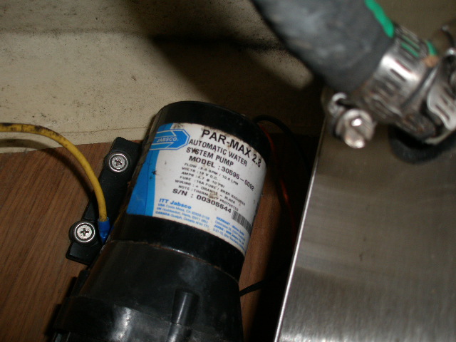

I was commissioning the fresh water system on my 29 ft. Hunter and the pump seems to be noisy and weak and I don't remember it acting like that in the fall. It is a Jabsco 2.8 and I think it is time to replace it.
I see different sizes and types and I can't decide which would work for me. Can I put in a larger one that pumps 4 gpm or will that be too strong? How about a Variable speed? Do I need an accumulator tank?
I have a starter battery and an additional bank of two large marine batteries on board, and do not really use the shower systems very often.
What do you recommend?
Thanks.

Well I just returned from the boat. I put a new faucet in the salon sink..had to remove the sink and reinstall both. Checked all strainers and they were clean. I put an access plate in the water tank, rinsed and vacumned out the tank and cleaned the pre-pump filter. Ran the pump and flushed out all the antifreeze from all the lines. The pressure is still low and slightly more than a trickle at the stern washdown but the flow is continuous. I checked the fittings between the tank and the faucets and no "apparent leaks", but how do I tell for sure. Also, how to check and correct an airlock?

Turns out there were two problems, one of which I wish I found two years ago. First, there was a partial clog at the point where the water leaves the tank..got this out by vacumning from inside of the tank to the valve. Found soft crud in the vacumn tank after. Next I did find a leaky conncector before the filter before the pump. After that the water flowed freely but not like at home. Still think a new pump is in my future. Now why I wish I found this before...two years ago my batteries were going dead and when I got to the boat..not enough juice to start the engine. I replaced them all with Marine AGMs for a total of about $750. Now I think the reason the batteries were dying was the bilge pump was running frequently from the water leak..Duh. If you're gonna be dumb, you gotta be tough. Thanks again for the suggestions. Now I'm on to replacing the engine stop cable. Morse 48702 is what it says on the cable, about 13 feet long.
