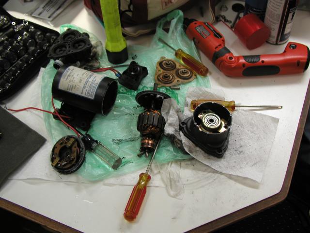

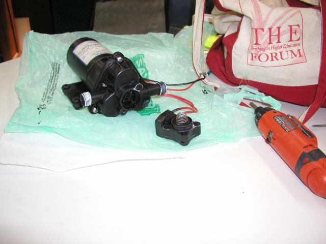

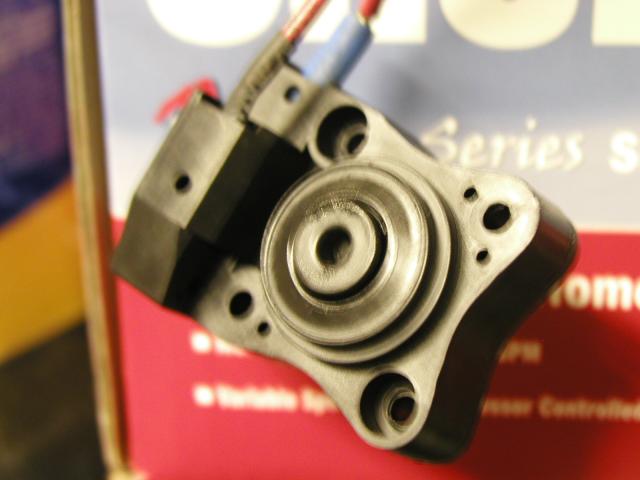

Dave, the pressure switch can be checked and cleaned and the pump check valves can be cleaned .. Rick has the most probable cause, a little trash in the check valves. If you disassemble carefully, you can re-use all the parts unless something is found broken. First picture is pressure cut off switch removed. The wires should have continuity as it sits and the connection should go open when you push on the rubber diaphragm . If it does that, the pressure switch is OK. If not, you can replace the "Microswitch" with same type and model. (Radio Shack?) There is a lever and spring behind the pressure switch diaphragm that you can get to and clean.. Next open the triangular cover and carefully remove the diaphragm rubber and pistons.(triangle piece by the screwdriver in top center of picture 2) Inspect carefully and wash clean. (the part just to the left of the flashlight in left top center) Next look in the case where the check valves are and clean those carefully.. remember, you may be drinking the water that goes by those parts, so make sure everything is clean when you re-assemble.. Good luck with it !
