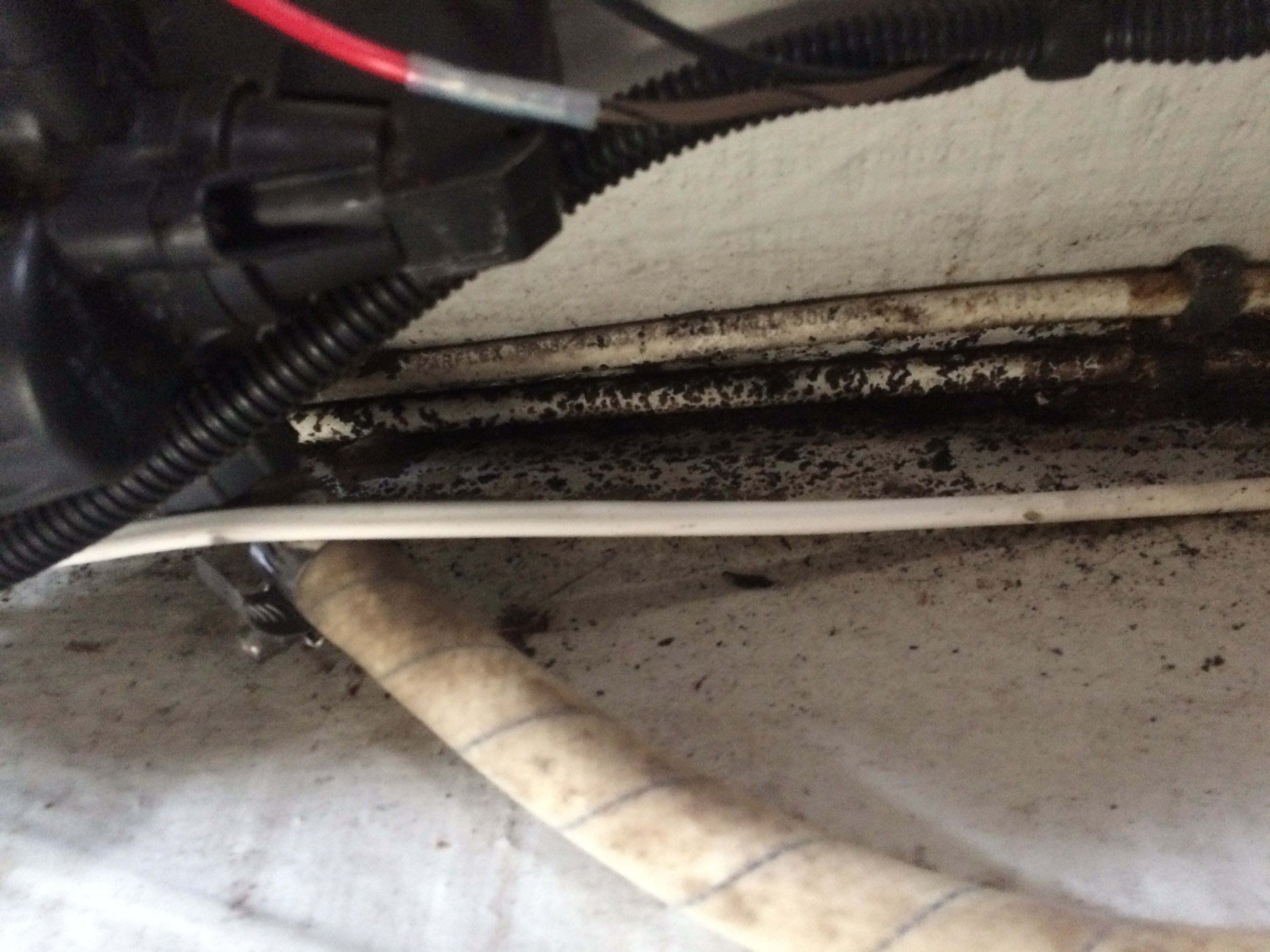

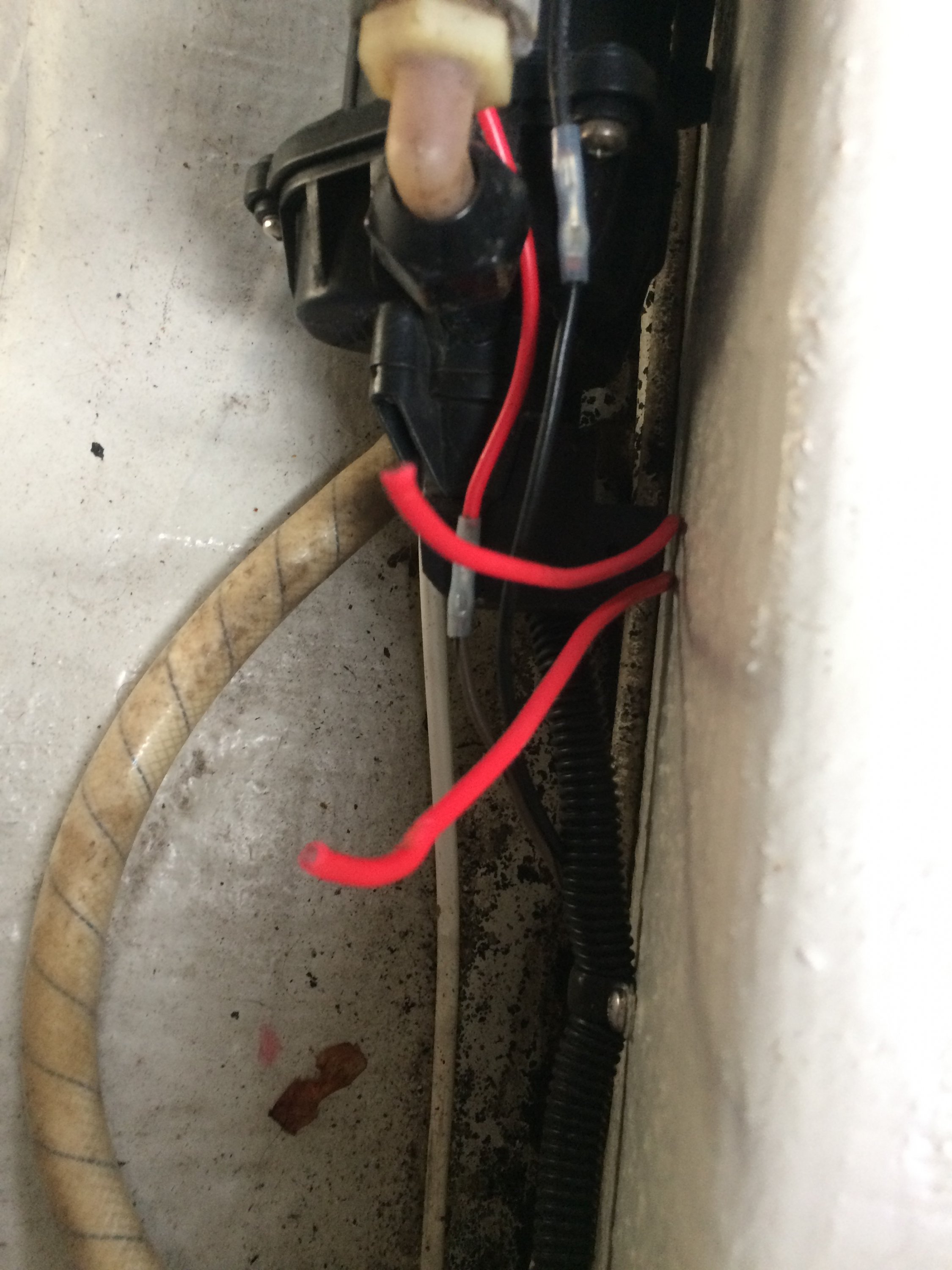

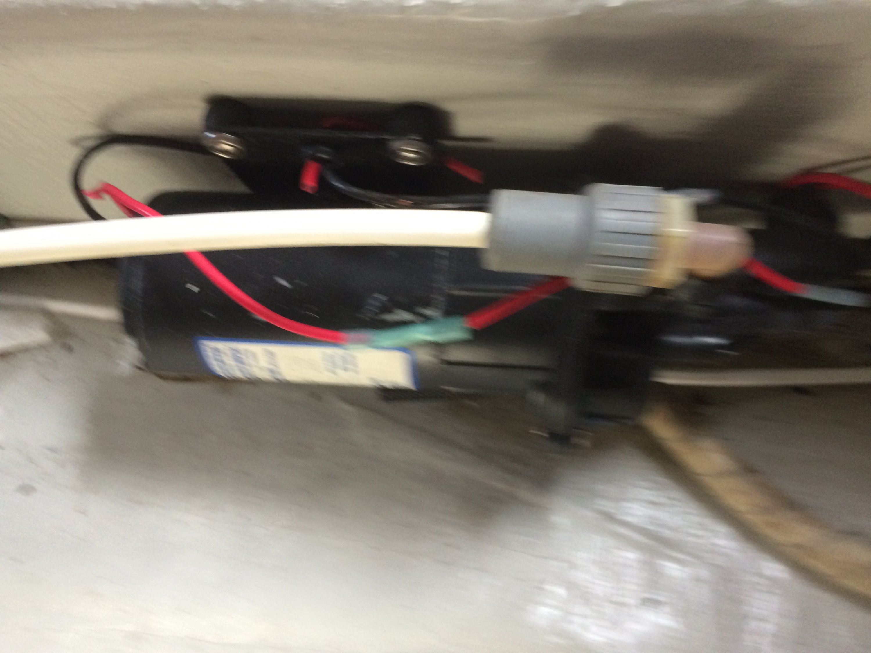

7,981
I found the pump! So, I don't think it's wired correctly. So far I haven't found any wiring diagrams but since I didn't get a picture of the pump label I don't know the exact model. But there are two red wires coming out of what I think is the pressure switch and they aren't attached to anything. The positive for the pump motor are wiring directly to the 12 v system, through the panel. I think the positive from the panel should go to the pressure switch red and the red coming out of the switch should go to the pump motor. The black can stay as is. I think if I rewire it so the positive goes thru the switch it should work. Any comments?

It does seem like some jackleg decided to bypass your pressure control switch rather than remedy a problem with the pressure control switch. Wire it up and expect the pump to not work, or work badly. Then the question: Is the pressure switch available as a part?

Yup, Hot to pressure switch, press switch to pump motor (red). Black as is.. If it does not work, you can take the pressure switch apart and take the trash out or clean up the port.

7,981
Thanks for the responses everyone. I'm going to rewire it Wed. and see what happens. I'll file a report. I hope it will be positive.
The story of finding the pump is worth telling. I've been looking for it since I got the boat in June. I could hear it but couldn't tell where it is. I stuck my head under the sink in the galley, and the sink in the head, and the engine "Lack of" room," but no pump. When I told the PO that the pump didn't shut off, he said "I guess that's what those other two wires are for." We talked about a number of issues and I knew I had to come back to that. While anchored Sunday morning a guy on a jet ski came by and told me he has the same boat and has for 31 years. I think I had the question out before he finished "31 years." I asked "Where is the fresh water system pump?" He told me it was under a bunk and you have to remove a plywood panel to access it. Thank you and that's how I found it. Not all jet skiers are bad people.
