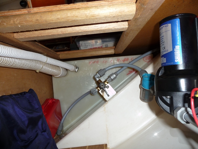

Water Pump
I went to one of the variable speed pumps and find it to be MUCH quieter than my old pressure switched pump. It runs very slowly most of the time (when it runs).. It is essentially the same triple diaphragm rotary as my previous pump but because of the variable speed, makes a lot less noise. It is mounted on rubber feet on a wooden block which is screwed into the grid. I think the mount is original Hunter. Picture shows the pump on the right side; that is the port locker, looking aft, under the cushion just forward of the nav station.
