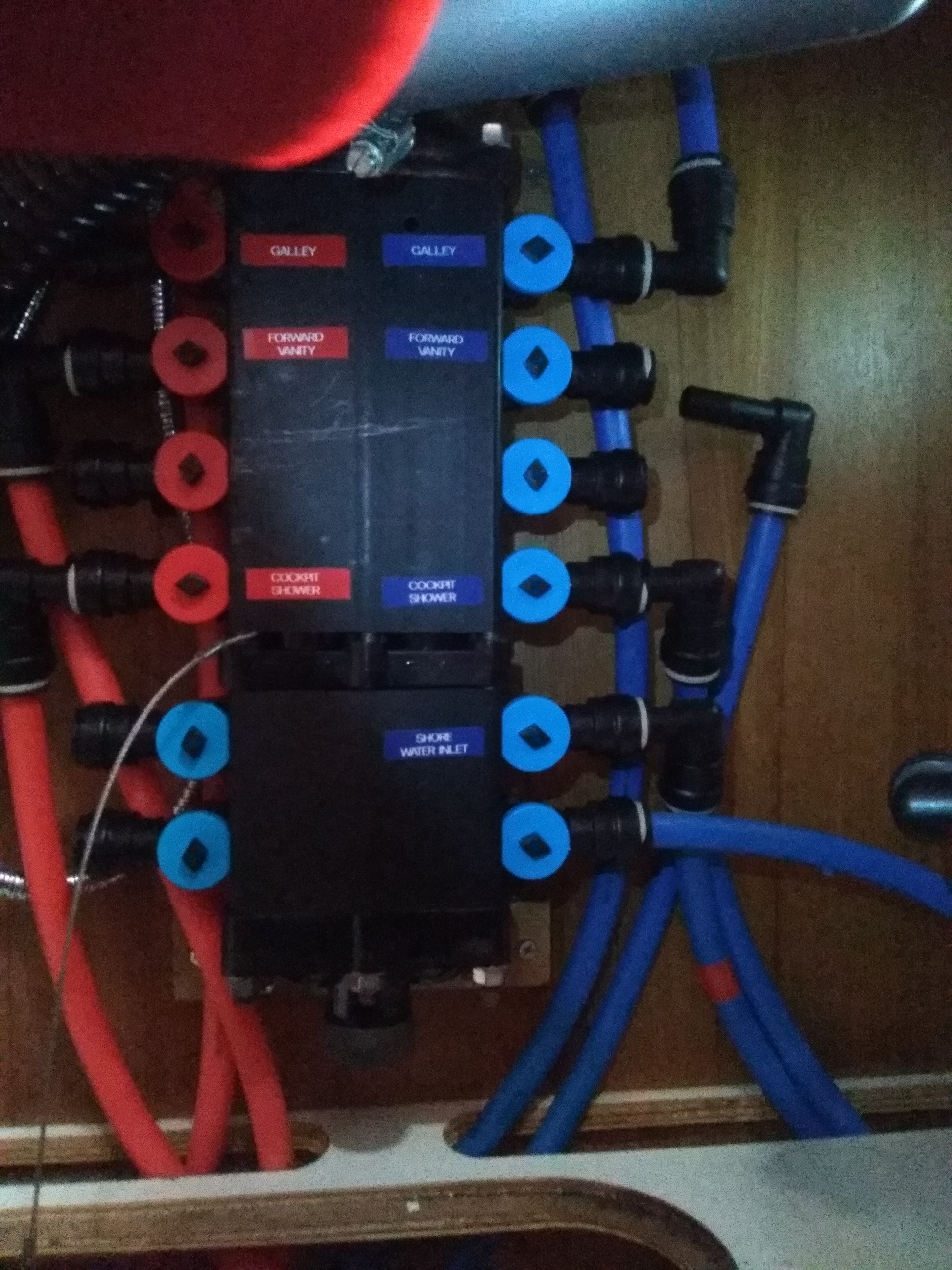

My 2007 Hunter 38 fresh water connection for the vanity has come loose from the manifold. I pushed it back in but it doesn't lock. How do these lock? What is the purpose of the small white ring on the fitting? Thanks

They hold by compression. Push it in as tightly as you can. Look at the other ones that are still connected and you can See where the white ring goes.
Notice that the white ring slides between what looks like a collar and the manifold body.
That collar is actually what holds the tubing in. When it's pressed in towards the body the tubing can be pulled out. When it's out the tubing can't come out.
And the white ring is what keeps the collar from being pushed in and therefor the tubing connected.
I hope that makes sense.

Thanks so much for your help. The collar assembly failed - I found a small plastic piece with a metal barb fall out when I removed the white plastic ring! I moved the connection to a lower unused valve put in the plastic ring and compressed and I'm back in business!
We were crossing the Florida Bay from the Everglades to Marathon when it broke and ran our tank dry so no harm done. It would have been worse if it happened when we were anchored in the Dry Tortugas.

Glad you are back in business. I was installing a water heater bypass for winterizing one time and had something similar. Except that it was caused by the O ring getting slightly askew. It leaked and wouldn't stay connected. When I straightened the o ring out all was well.
The do sell the manifolds here on the SBO site so if you need parts to effect a repair I'd bet you could get them here.
