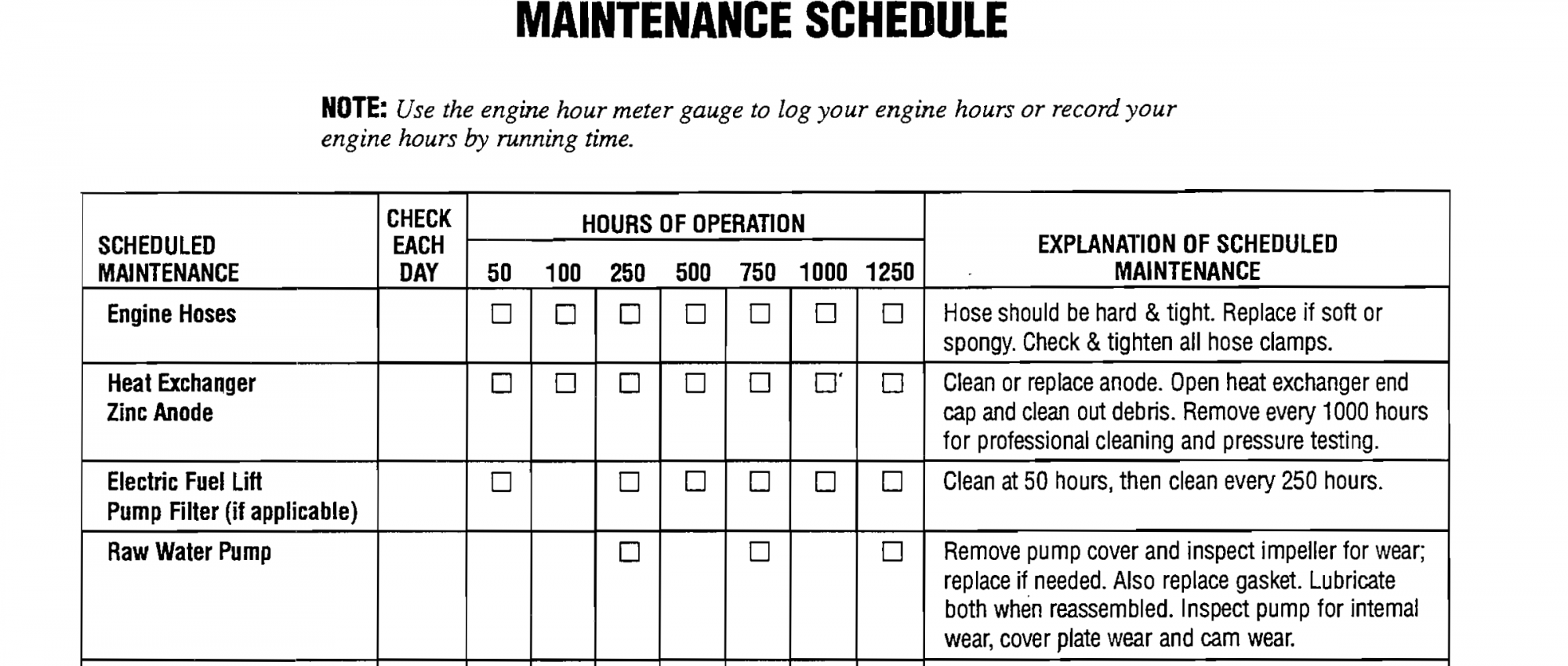

Years ago when I bough my O'Day 30 I was told at a diesel class to replace the fresh water pump impeller once a year. After looking at the condition of the impeller I went to every other year. Now owning a Catalina 350 I think replacement should be based on the number of engine hours. I have heard 200, 300, even 500 hrs. Any thoughts?

Would that be an M35? Many skippers change them yearly, by taking them out before winter layup. Many do it by engine hours. On my M25 I've had it in for a few seasons and is due for replacement, I'd have to go look up the hours, probably around 250. Don't buy Globe impellers and if you don't have one yet,put in an Oberdorfer. I have a link to the swapout of a Sherwood, not working right now, but I'll get it to you fi you need it. Let me know.

I replace mine every other year. That would be about 200 engine hours. If you are unsure about the condition of your impeller and want a quick test: remove the hose on top of the exhaust elbow and watch the water flow with the engine on idle. If water flow is robust you are probably OK.

I usually replace it every alternate year (around 225 hours or so) and have not seen any wear on the impeller. It may depend on what's present in your water. I'm thinking areas with glacial flour in the water for example would get way more wear.
