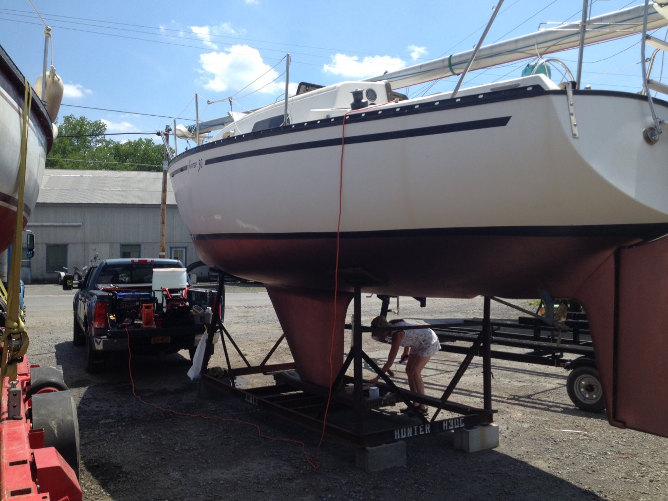

:plus: On the VC-17M. Build up is negligible, rolls on easy, dries fast, looks like a gigantic copper kettle before launch. Post season slime/algae is minimal, zebra mussels only attach in the gap behind the rudder skeg and power wash out easily. It takes about an hour and a half to apply, oxidizes fairly quickly to a matte brown finish once launched. We put on a new coat every other year. Two quarts to cover a H30C hull to the waterline. I can even get the Admiral to help.
