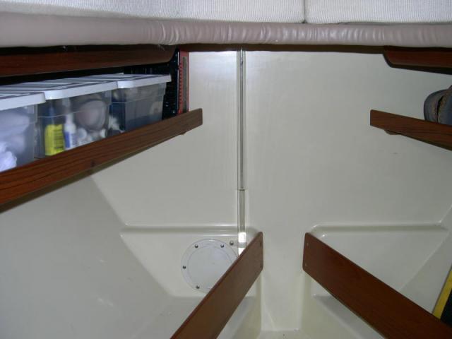

I have a Pearson 323 with 3 fresh water tanks, bow, port and starboard. When I run off the bow tank the system works fine but when that tank runs out and I switch to one of the others the system air locks and I have to physically prime it. Most of the time I have trouble whenever using the port or starboard tanks. I've replaced the original pump with a surflo and it is mounted about 6-inches higher than the highest piont in the system.
All of the vents are clear and the tanks run freely when I disconnect the outflow fitting.
Has anyone experienced this problem and found a solution?
