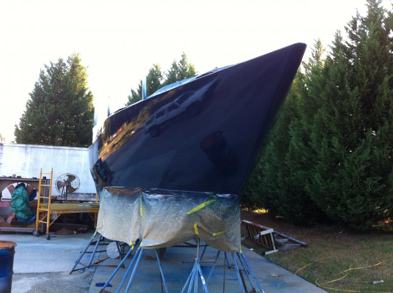

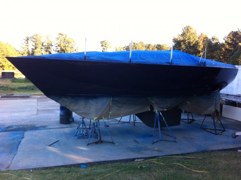

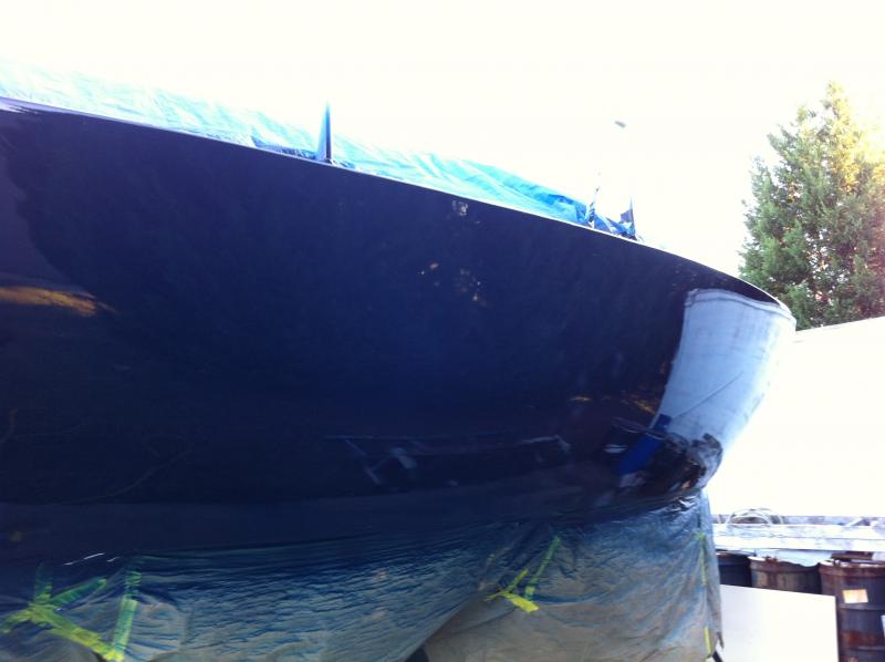

....on this 32 year old S2...just painted my top sides today as the weather was just right for the single stage polyurethane enamel (Delfleet Essential)......i sprayed it with a Bink's 2001 suction qt cup gun at 50 psi in 70 deg weather with 58% humidity......this is PP G's version of Emron.....
it sprayed very well ...and i only had 2 small sags about 1.5" wide....these pics are about 1 hr old and the paint has been on the boat about 3 hrs now so some curing time will make it even smoother as it self levels over the next week and hardens up...it has three parts 1 the paint its self 2 an accelerator 3 the hardener ...hope you like this out come....this is not some thing i would recommend for everyone but if you can spray enamel and are good for the prep work its well worth it IMHO.....you will see i didnt win the total battle as some lady bugs landed on the fresh paint...you can tell where they are in the reflection shot I took (030.jpg)......
