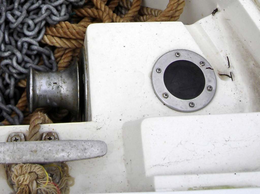

I have a Maxwell 500 that only has a capstan and no chain gypsy. I typically pull the chain section of my rode by hand because it doesn't work very well on the chain. I recently replaced my chain and anchor with sizes and they now total about 70lbs so I am looking for a way to use the capstan for the chain. One thought was to use a French Hitch cover the capstan in order to improve the grip and reduce the abrasion of the chain and capstan.
Have any of you seen or tried this idea? https://www.netknots.com/rope_knots/french-whipping

I have already contacted Maxwell and they no longer have the conversion available. The only way to get a chain gypsy is to replace the whole thing. I will get the VW10-8 which will mount horizontally in my anchor locker.
https://www.wmjmarine.com/vw10812v.html
I am hoping to get by with a modification to allow me to continue using my old 500 until it dies.
