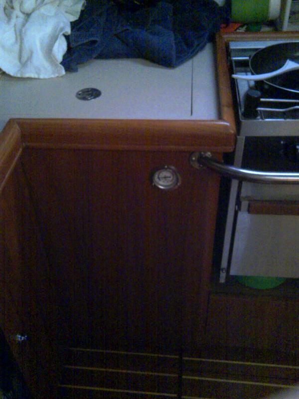

I tried the digital wireless before but the sensors would freeze and batteries would explode at -10 to -15 degrees. Then I saw this commercial type gauge on a friends boat. So I had to have one. Why because it looks so cool. And better yet no batteries! If anyone wants one. Found on ebay at the restaurantparts store. Make sure you verify you want the surface or flush mount model, with the color face. The ad only showed the surface model. So I sent him an ebay message with my cell number. And he actually called me before he shipped to verify what I was looking for. Made the adjustment right then and there. Tell them I sent you. just for the record. I don't own the company and get no kick back.
Oh almost forgot to ask do you also have the adler barbour cold machine or something else just wondering?
