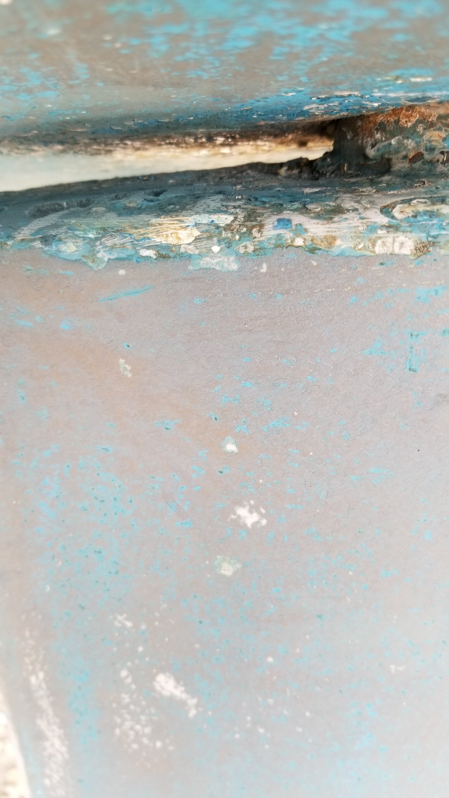

Hi all... After pulling my h34 out the other day I noticed (see picture) that the fiberglass is fraying at the top of the rudder..... Do I need to drop the rudder? can I simply seal it all with epoxy? Any thoughts would be appreciated....

It doesn't look like fraying fiberglass to me. It looks more like marine growth. Clean it up well to see what's really going on.

From the picture, it looks more like marine growth to me, not fiberglass.

I agree. That's a notorious area for marine growth since it's hard to clean. I would get in there with a spatula, one of those broad putty knives or even a hack saw blade and see what you can do. Turn the rudder to get it away from the hull. Wear gloves - barnacles will cut the hell out of your fingers.

There's a tube worm that makes a white calcium based case that would look very much like fraying FG, I agree it looks like growth.

I will take a closer look... I pulled on one of those "threads" and it appeared to be fiberglass strands. Thanks for the quick replies, I'll update after I've been back in the boat yard tomorrow... Thanks... Jon

If it's glass and it's fraying, then it will pull a tad and then essentially stop pulling. That picture looks like glass, but the hockey pool is stacked against you.

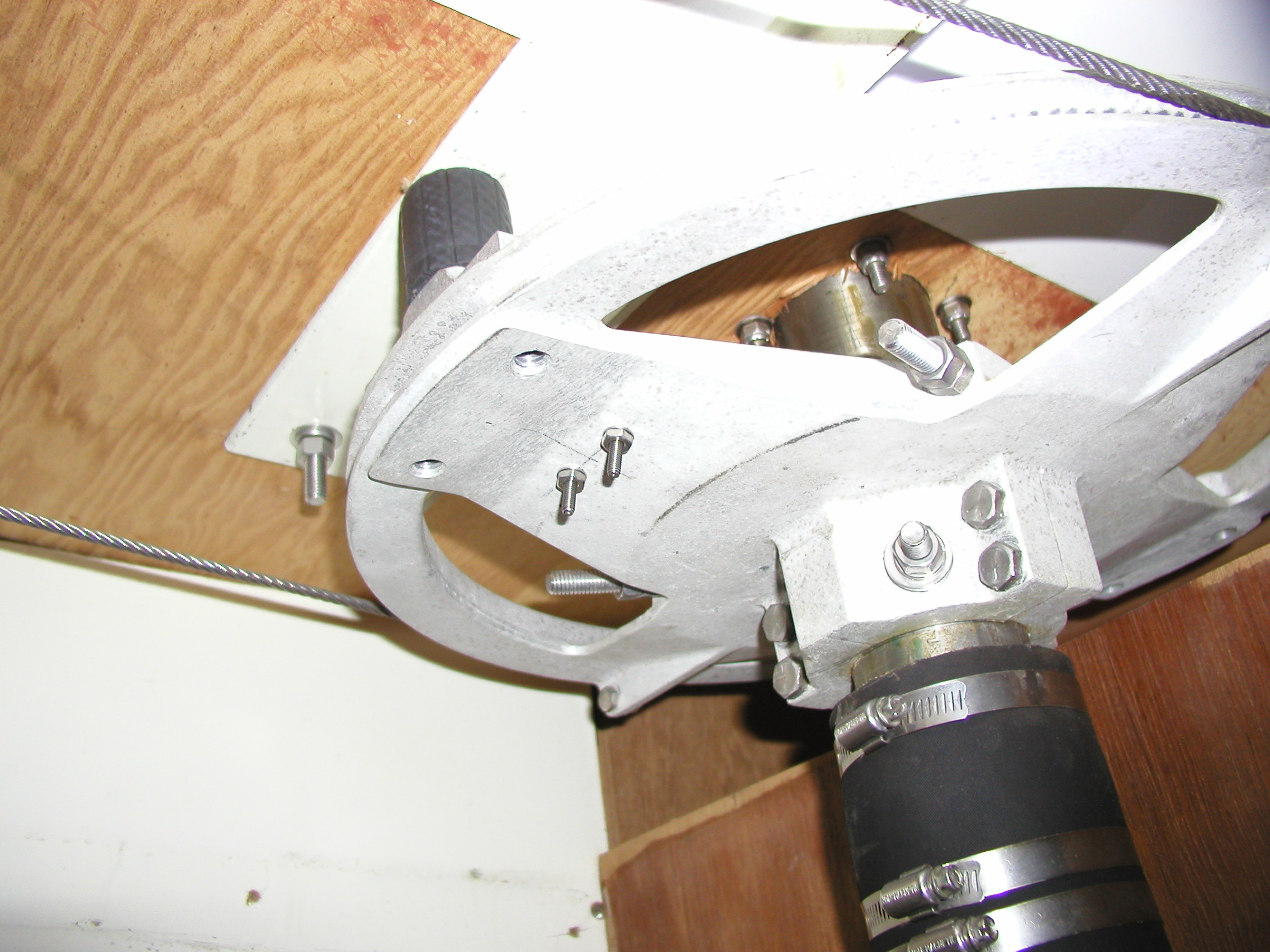

P7100344.JPG Jon, the process is kinda straightforward.. The thrust collar inside the Lazarette has to be loosened and any burrs smoothed.. then the wheel that the steering cables attach to has to be loosened and the rudder should slide down until it hits the ground.. it should be supported so it doesn't drop.. it'll be heavier than you think it might be... Concept is good, but there have been reports of the cable wheel being very hard to loosen and the one through bolt in the wheel that goes through the rudder stock being hard to get out.. Maybe let it hang on the thrust collar until the wheel is free and the bolt out.. I have not done it, but those items are what hold it up in the boat.. Good luck.. Pictures !

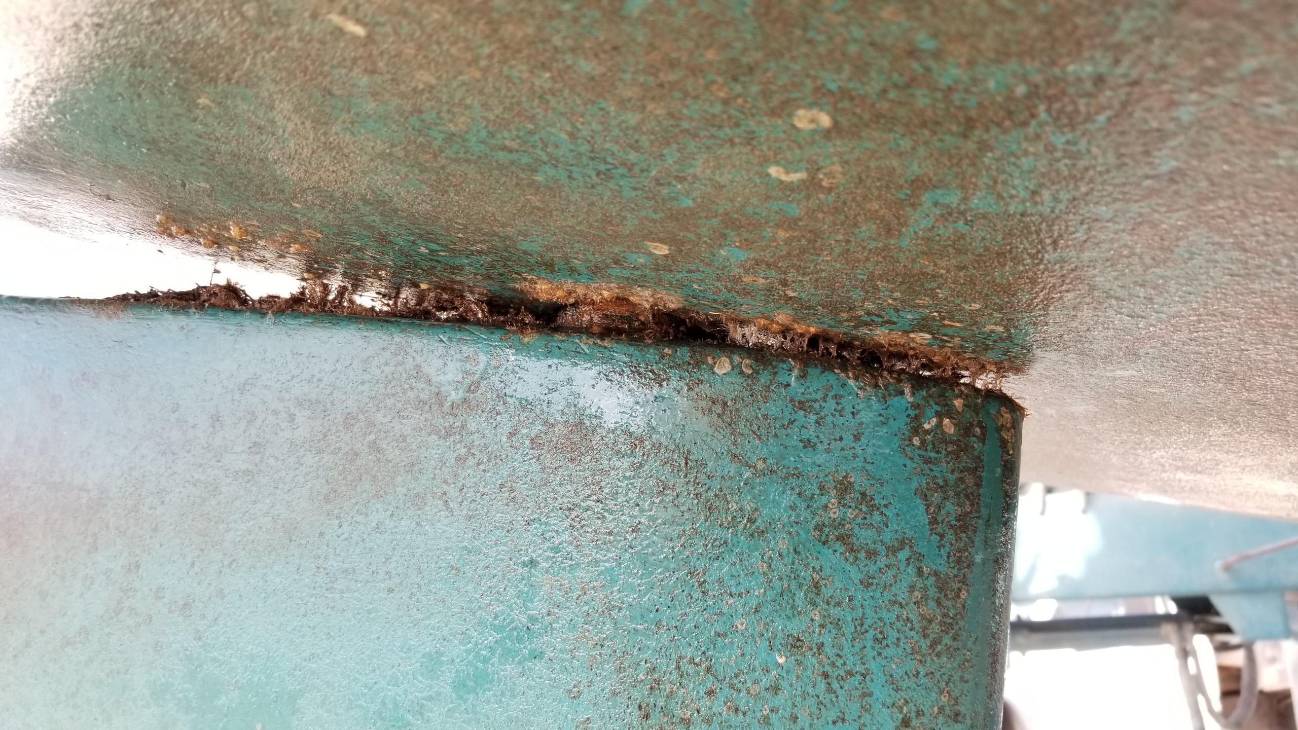

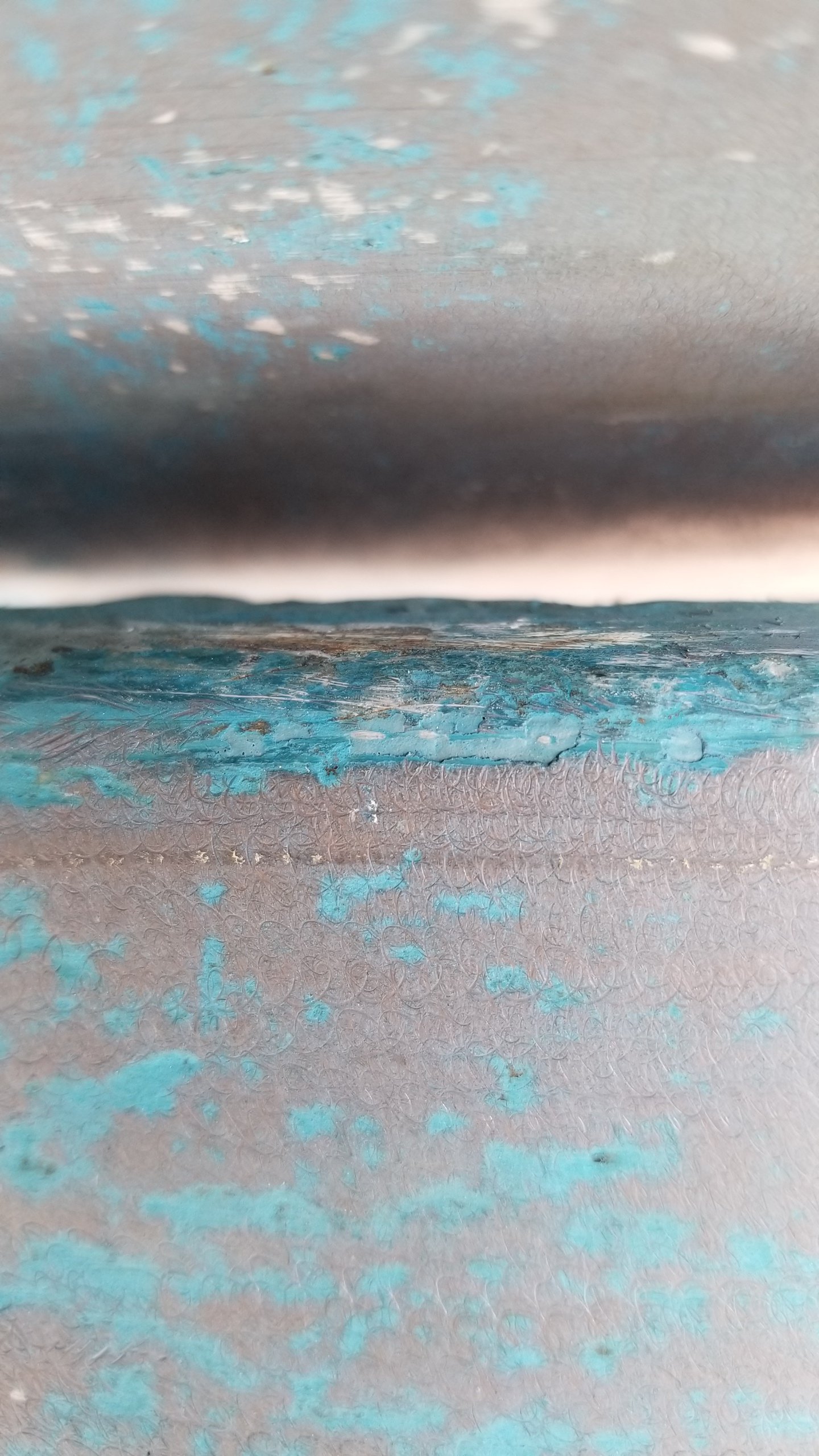

After a good cleaning, the fiberglass was simply marine growth and most of you stated.... however, as you can see there are a few areas where the fiberglass is showing... that will be covered with a barrier paint or epoxy before painting.... So, I'm not going to drop the rudder... for the moment.... Thank you to all who responded... -Jon

Once repainted, just make sure you or your diver keep an eye on that location. it is easy to miss when scrubbing the bottom. I ended up with an oyster growing there that I had to chip out.
