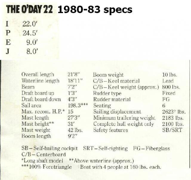

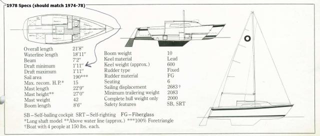

The fractional rig (taller mast) 22 was introduced in the 1980 model, the 1973-79 models all had the shorter masthead rig. The 1973-78 models had the shoal-keel (1'11" draft), the 1979-83 models had the K/CB, there never was a swing-keel model of the 22.
I agree with Joe on replacing the forestay NOT fixing it, yes...maybe the rest of the wire is fine and a new swage at the top will fix it, but I consider that "penny-wise and pound foolish", aka..... why risk it? Replace the entire stay and consider replacing all the standing rigging sooner rather than later, replacing all the standing rigging will give you more confidence in the rig.
My guess is that htis boat has been upgraded by a previous owner, remember though..... the newer (1980-83) models also had more ballast, this was partly offset by their shallower draft, but 200# more lead i nthe 1980-83 keels (even considering the shallower keel) would still seem to better balance the taller (and more sail area) rig of the newer models. Did the PO also add more ballast? Rudy can give you the dimensions of the taller rig to compare to what is on your boat, that may help to tell whether this is rig is one from a newer 22 or if it came from a different boat. Any good rigging shop can replace the stays using the old ones as templates.
