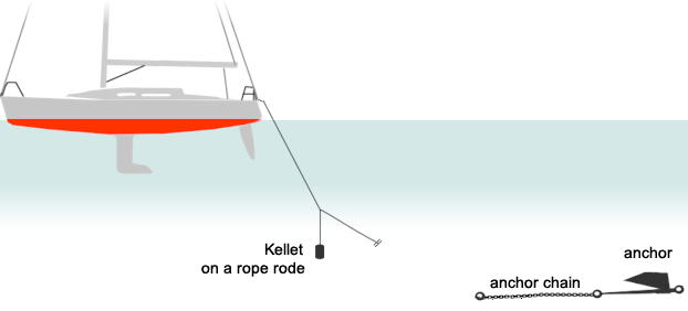

A kettle maybe a help in the situation you described. Here is what it looks like. In this image the rode is tied to the stern. It can also be the bow.

+ 2 for the kellet.

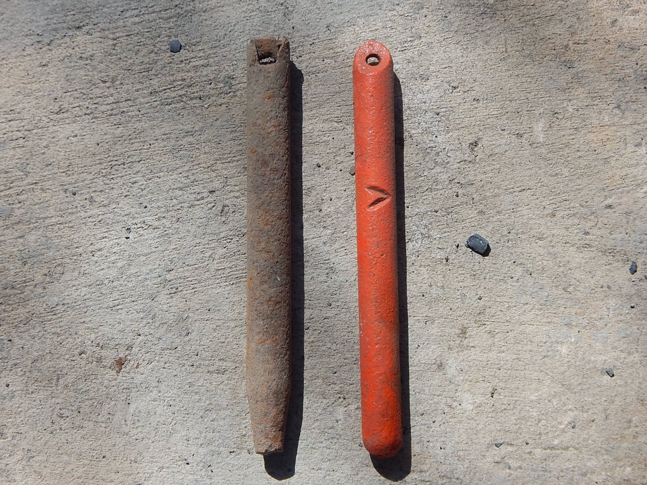

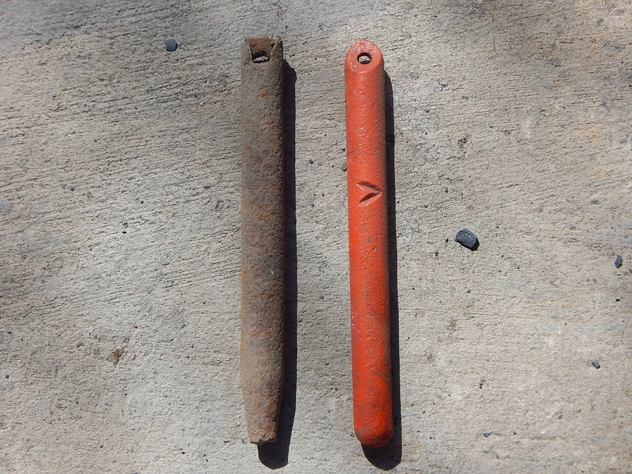

The picture/drawing that jssailem posted does not show a line attached to the kellet to lower and retrieve it along the anchor rode. That line is vital to keep the kellet just below the bow of your boat. Without that line the kellet might slide farther along the anchor rode as the bow of the boat pulls on the anchor line. We have used the weight system frequently. In our case I made the system using a 5 pound window weight. Since the weight was a cylinder that is about 1.5 inches in diameter and approximately 15 inches long it never caught on obstructions under water. I usually set the weight at about the depth of the water below the bow of the boat. I tied the line for lowering and raising the kellet to a cleat or even to the bow rail at times. A bright colored line helped me or anyone else retrieving the anchor to realize that the kellet was there. A carabineer (sp?) was used to attach the line on the weight to the anchor line. It needs to be large enough to allow the weight to slide up and down freely. The extra line and weight stored easily in the anchor locker.
Admittedly, working over the bow pulpit did present some challenges, but far less trouble than trying to unwrap the anchor line from the prop, the keel, or the rudder. How do I know? Been there, done that twice before I built the kellet equipment.
I would say that there might be a few who have never seen a window counterweight, do you happen to have a picture?
Aug 2, 2005
1,155
Thanks for your observation All You Get. At 70 years of age I never thought of that! I like to believe that others know at least as much as I do. I'll post a picture later after I find the ones I have in the garage.

The counter weights were used in old wooden double hung windows. Two cast iron weights per sash. Helped raise the window and hold the sash at the height you wanted. One is in original condition and the second is painted to be used as I described in the earlier post. After we replaced the windows in our old farm house (32 years ago) we had many of these weights available. Although I no longer have a complete set, I made sets of the kellet arrangement for people at our marina. Low cost equipment that worked! I'm keeping these in case I (we) buy another cruising boat. BTW.....I would have a difficult time walking away from an IP 35 K/CB model!!!
