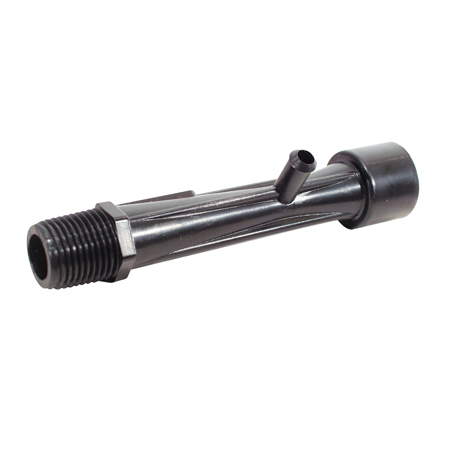

fyi....another hint...To keep my 3 a/c concendation pans dry with a 20 dollar venturi screwed to seacock at discharge fittings.

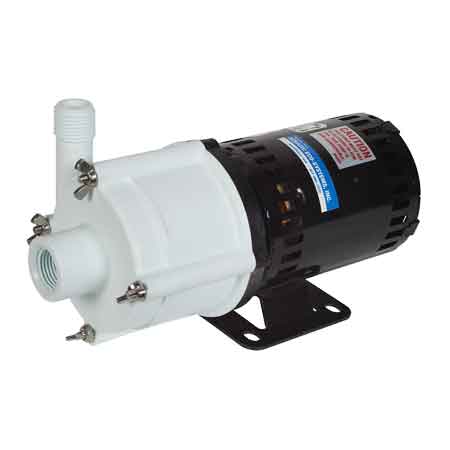

Well your almost right...I wasted 250 bucks once on that fancy condensator thingy...worked for about 10 months and then it died.. Then a friend turned me onto one of these. Please read posting number #5 ...I got mine online from a salt water aquarium store. I would also like to add not get to far off keeping drain pan dry topic..I also discovered the little gaint raw water a/c pump is the way to go....I have one little gaint pump that is about 10 years old....will suck the chrome off a buick and has required no mantenance.

Onecoolair- I purchased the same venturi that you are showing in your link- 3/4 inch- to use on my mermaid ac. I haven't hooked it up yet, because when I tested it on a garden hose it created a lot of back pressure. I'm worried it will over burden the water pump. Does your pump have to work overtime now to support the back pressure. Also, the venturi didn't seem to create much suction.
