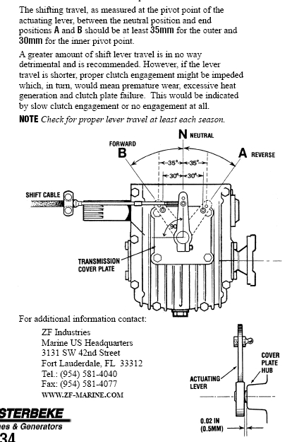

Check this out
As stated it should be a simple adjustment. Here is an excerpt from a Westerbeke manual that should be similar.
