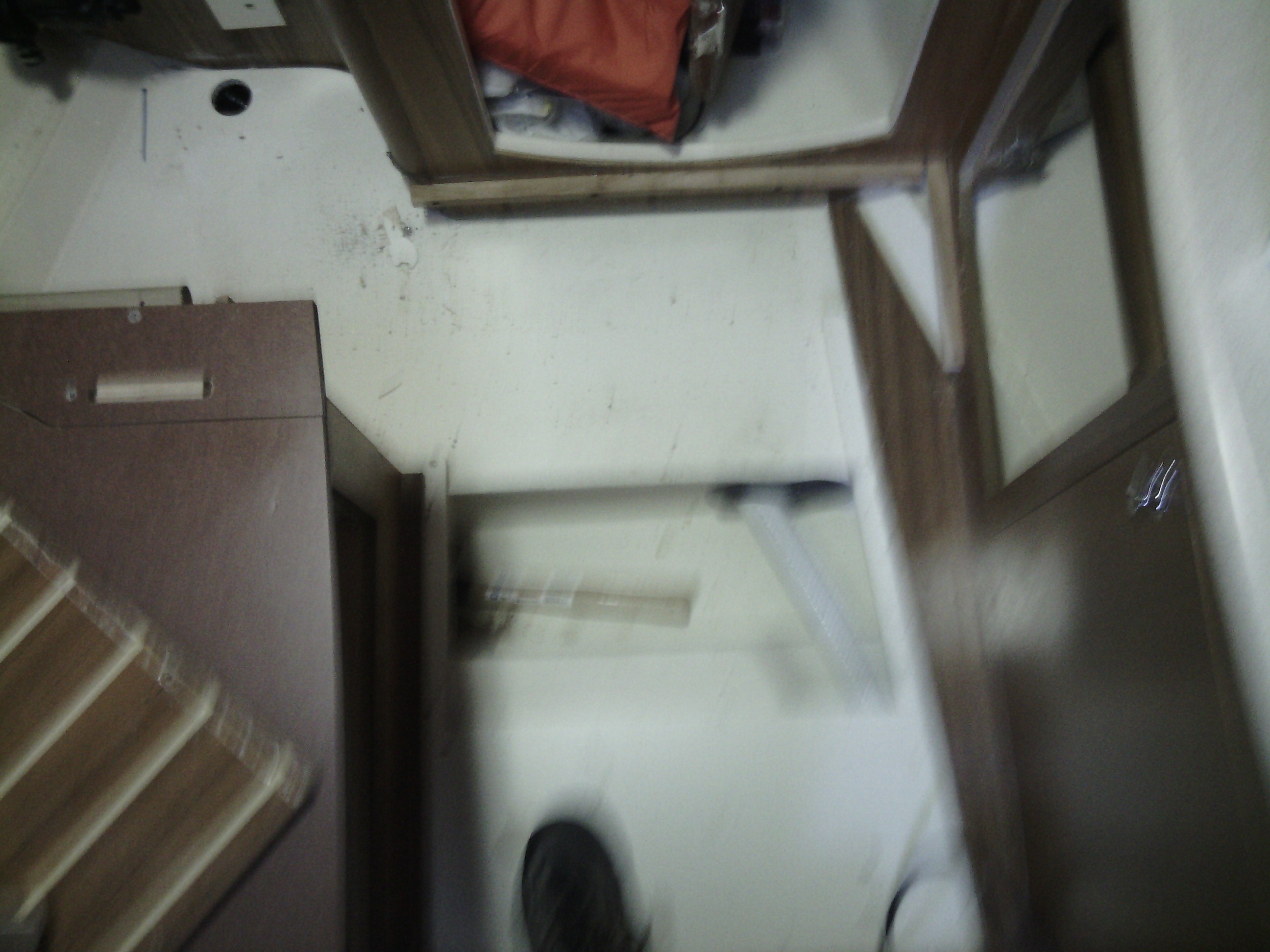

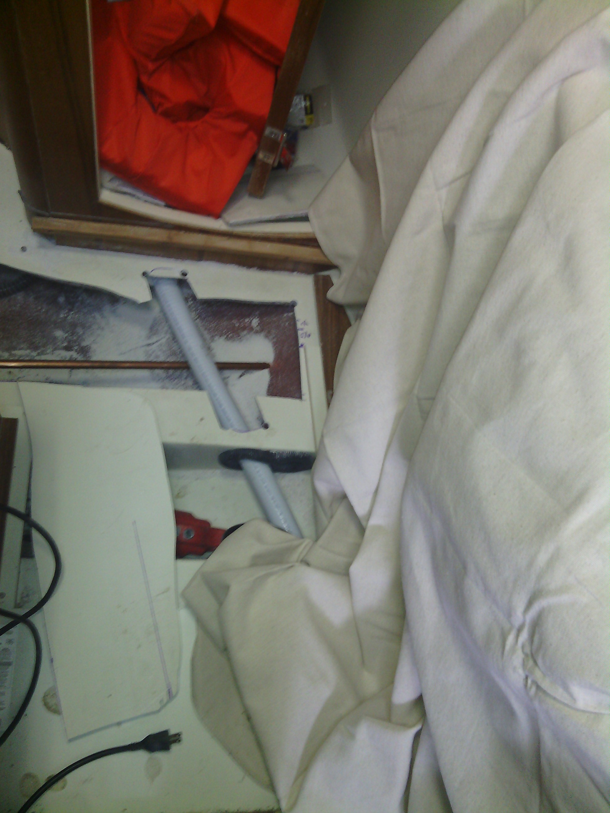

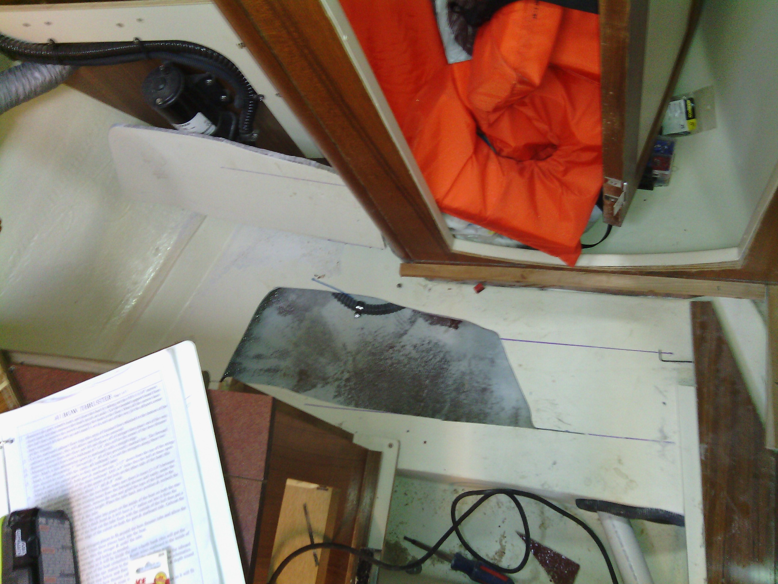

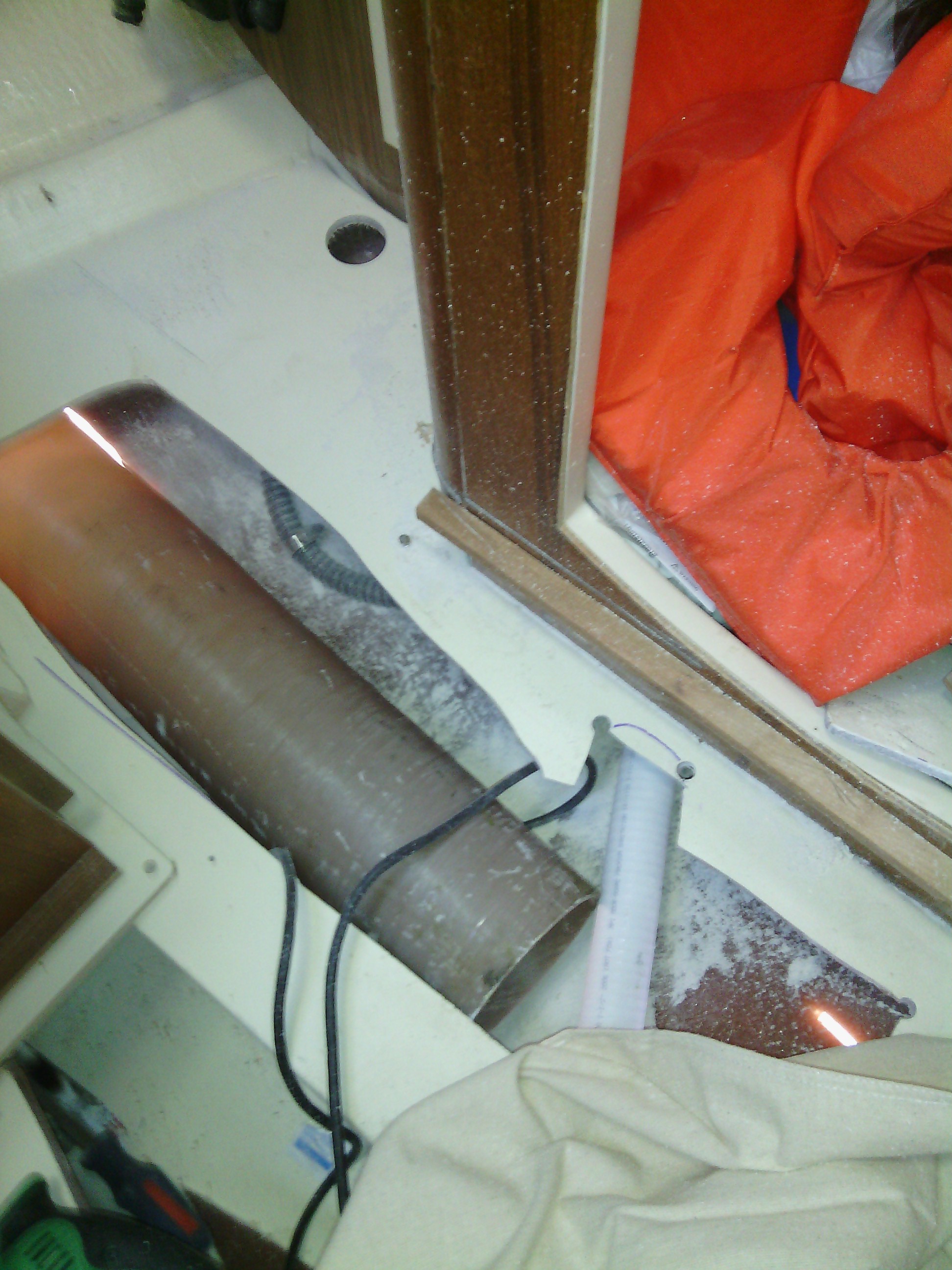

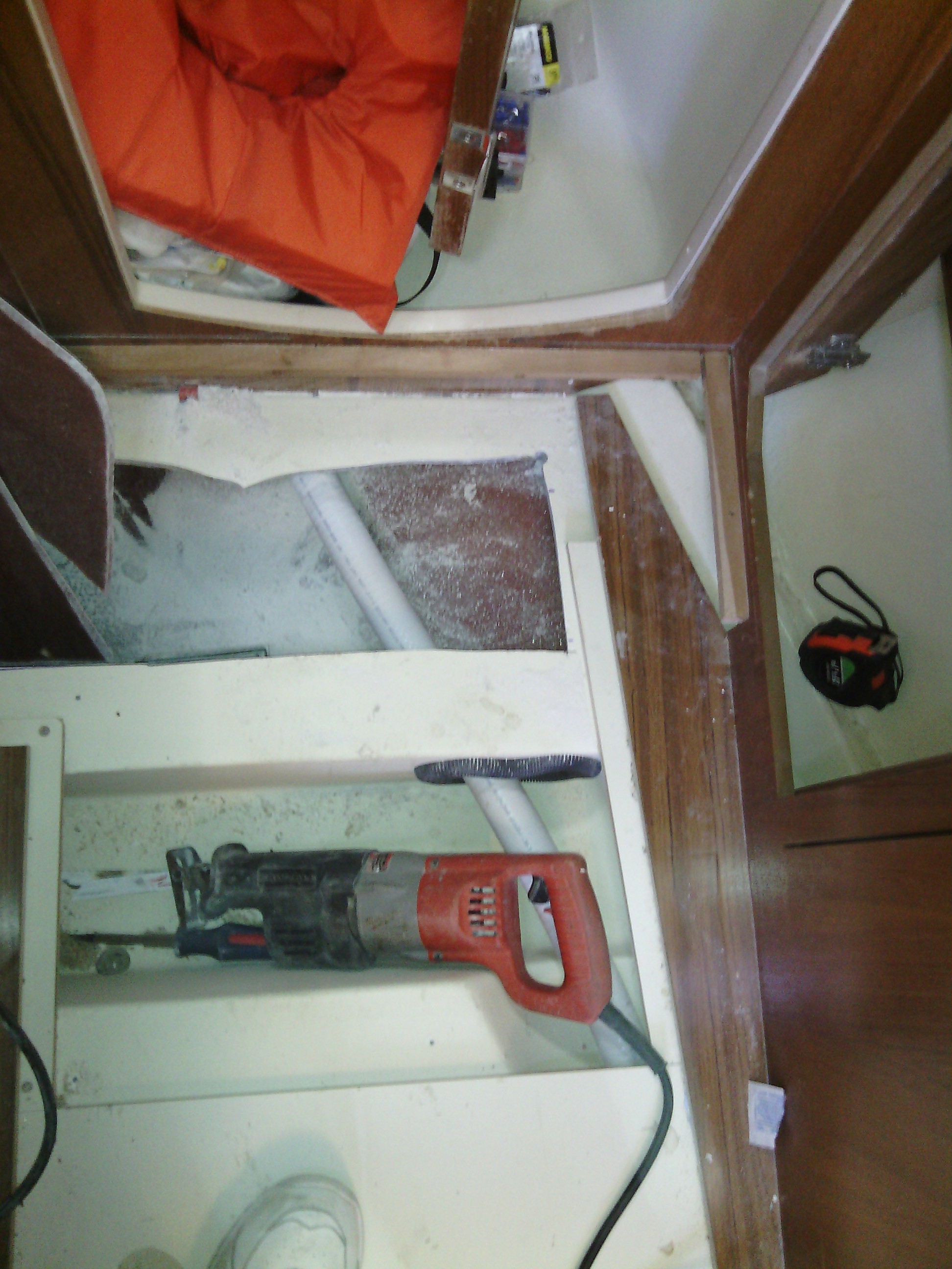

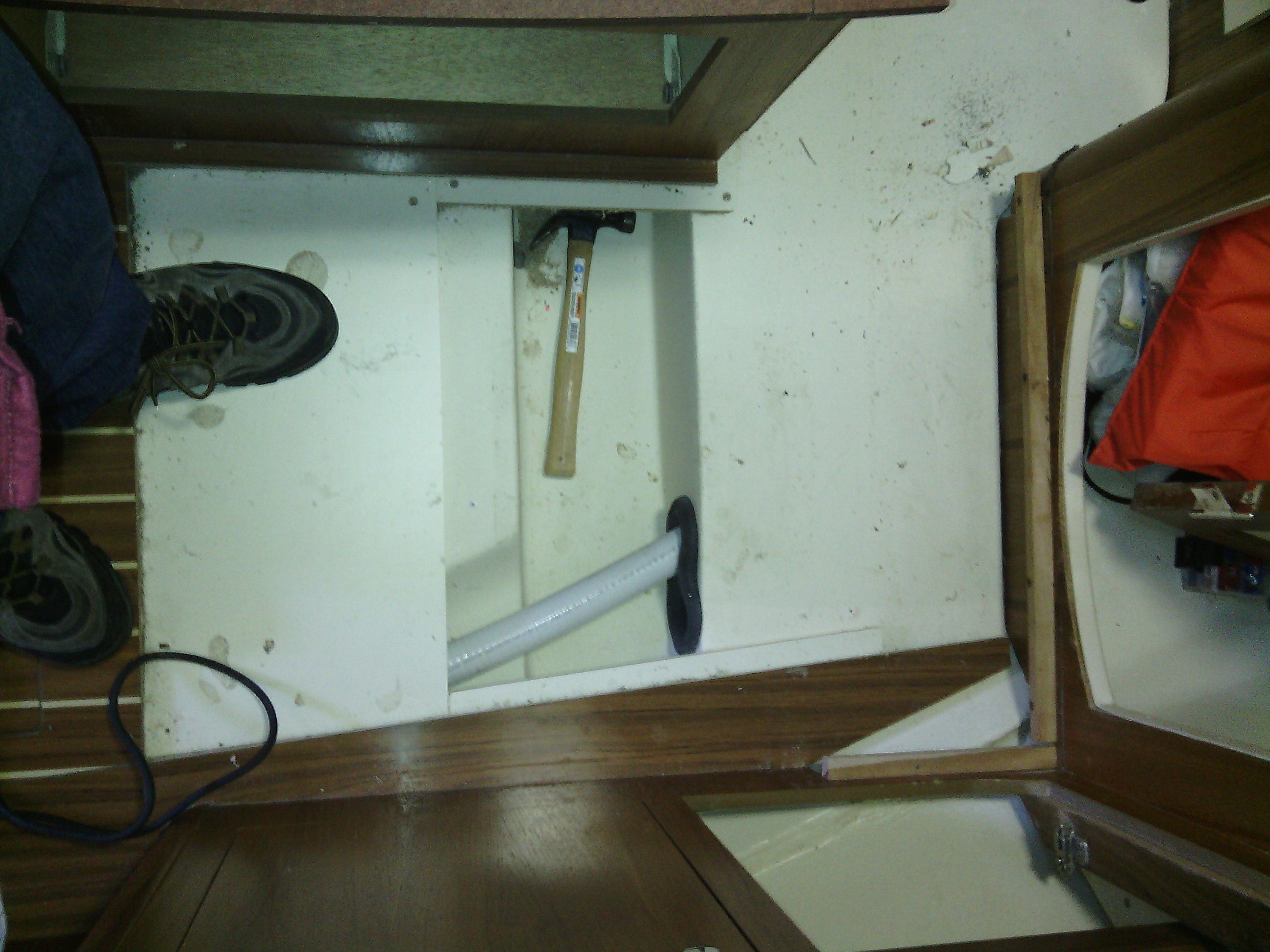

Jun 15, 2012
719
BAVARIA C57 Greenport, NY
Joe, I have attached some pictures I took when I installed a Bow Thruster in my 2007 41DS. The pictures show the finish floor removed and the "subfloor" that had to be cut. As you can see I had to remove the forward portion of the berth. I think once that is done you can remove the finish floor by unscrewing.

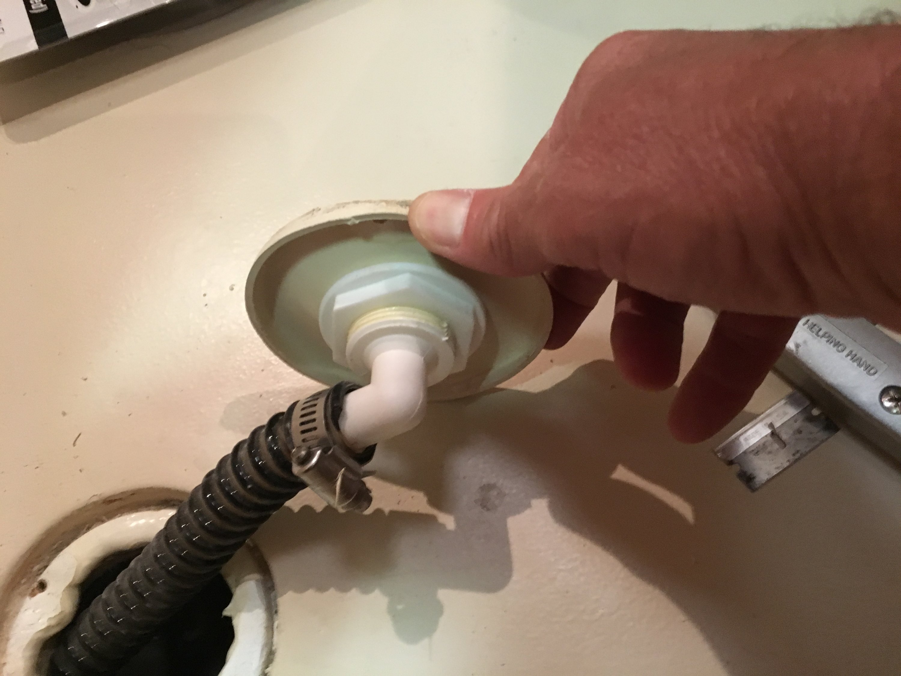

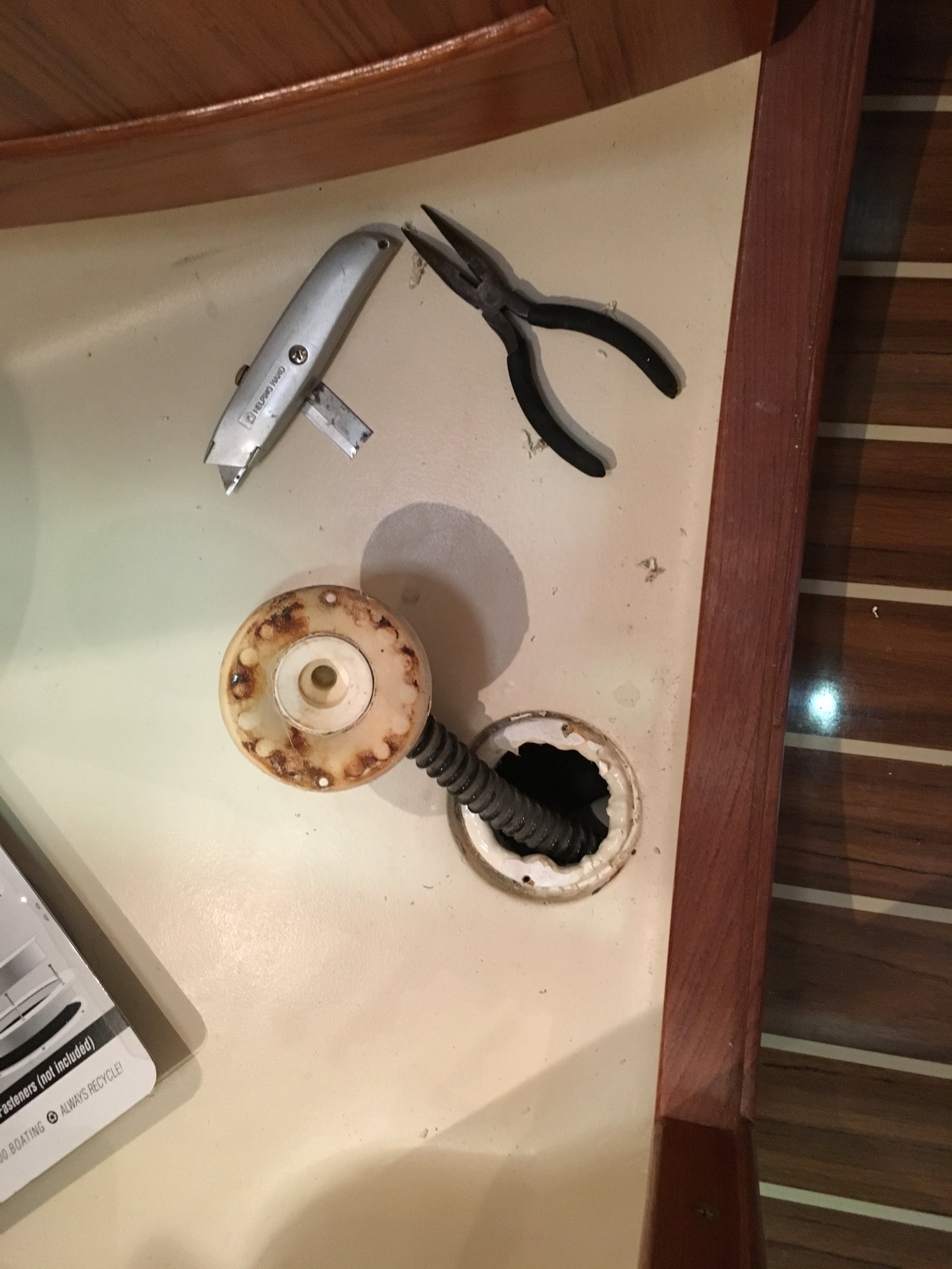

Jun 8, 2016
16
Hunter 41DS Punta Gorda
These pictures help a lot. I did not know the sub flooring was all one long piece. I working right now to see if the drain in the floor of the shower will come up. I noticed there was some caulk around the edge of the drain. If there is a place to seperate there I can pull the drain up and the hose should come with it. Your picture tell me to continue on with trying to get the drain up. Removing all that cabinetry would be a real pain.
One question the step just before you go into the head it seems to be glued and screwed. When I took the screws out it still would not move. How did you get that apart?
