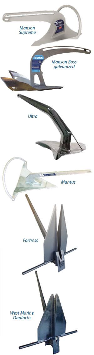

This is a very good discussion. It all started when I reviewed the article in Practical Sailor "Anchoring in squishy bottoms" detailing the test conducted near Solomons Island which showed the Danforth style at 45 degrees held the best in a direct line pull. I purchased a Fin Delta riding sail (late last year from Bacon Sails, Annapolis) but didn't get to use it much, so I have yet to see if it will decrease yawing, but it won't help holding power. I have anchored in the Miles and Little Choptank with my delta in 25kn winds without problem using a 10:1 scope (I have 30' of 5/16 HT chain and 3 strand nylon rode). However, I didn't sleep very well those nights. I appreciate everyone's advice.

Just to be clear - the Practical Sailor test was in Solomons Island Maryland, not the Solomon Islands in Oceana.
Yea I was thinking Solomons Oceana for sure... ops. Interesting article & perhaps I need to modify my thinking. if anchoring in a swamp with bottomless mud I need ahhhh dare I say Danforth style... :) .. (feels like a mono owner saying he needs a cat) Interesting article and clearly a topic with room for much debate. I will Ignore the fact Manson Supreme dont make a 44lb one as listed and the 45lb one listed is relative to boat weight and the FX 37 is for a bigger boat. But very hard to actually measure an anchors performance, but also I can't logical defend/support the Supreme when the reports notes 650 pounds verse 1500 pounds for FX16. I will keep my eye out for an FX16 owner as he drags it astern at full power trying to bed it in while Im having a beer. All joking aside yep it would seem one needs to consider their typical anchoring environment more than I had thought.

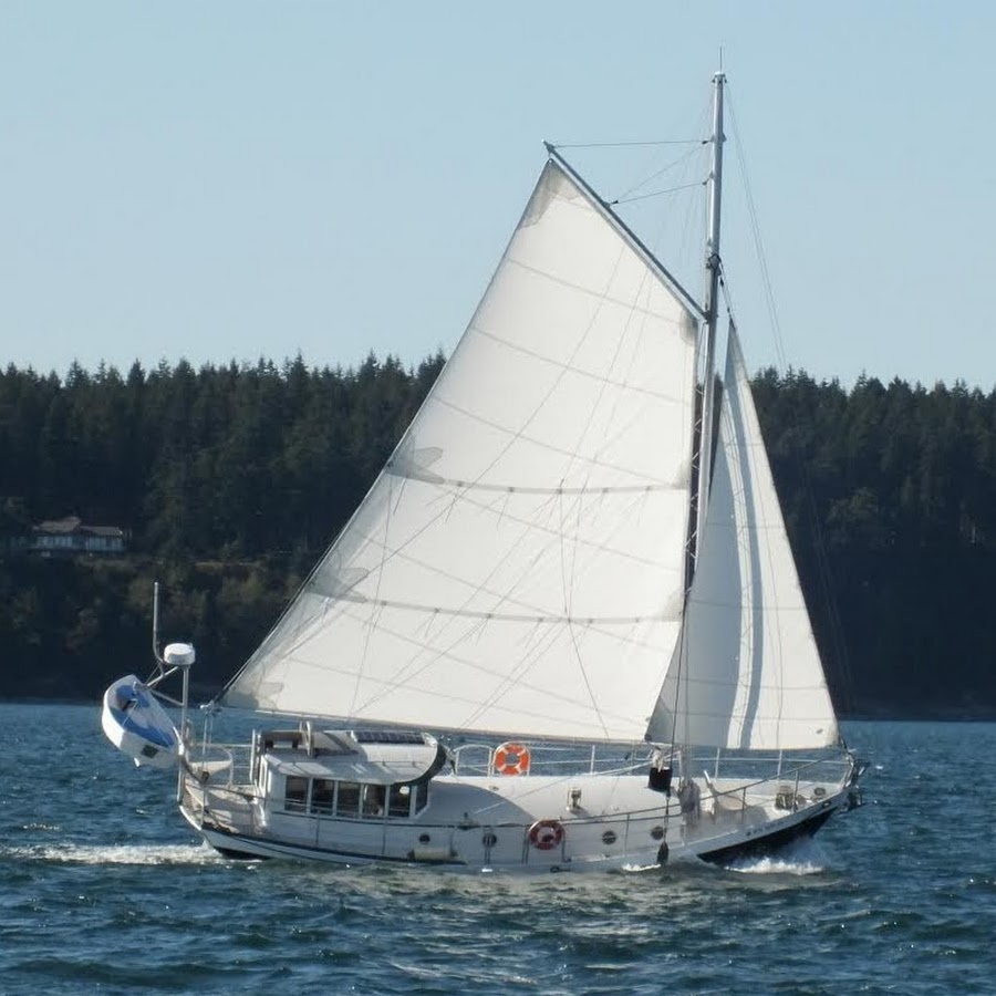

23,593
Yes. As with so many things sailing, your environment should influence the selection of gear/boat you choose.
If I was planning a circumnavigation I’d look more to a Cape George Dory or a Rustler 36 than a Hunter or a Catalina.
Himm we moved from anchors to boats.
I don’t quite agree with implication that your two boats of choice are necessarily better than another or a Hunter. I met and sailed with Mike Harker the first Hunter 49 to circumnavigate the world and mine has now done the equivalent miles of 3 circumnavigation, seen 8m seas and 75 knts and I do not have to many complaints. I just punched into Google “Rustler 36 problems” the first thing that came up was mast position adding weather helm, for H49 first was about AC and 12kw generator and for the Cape Dory it seems many many builds never followed the design, along with timber decks. Perhaps a good question for another post is how many would change there current boat, for what, and why ?
