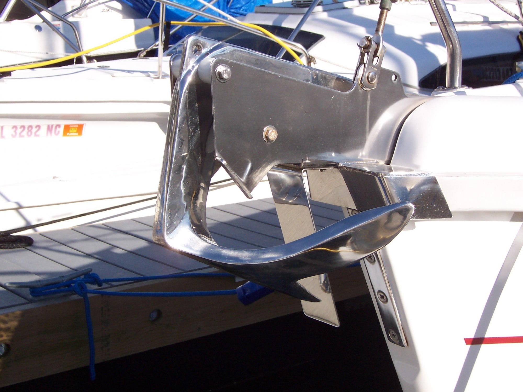

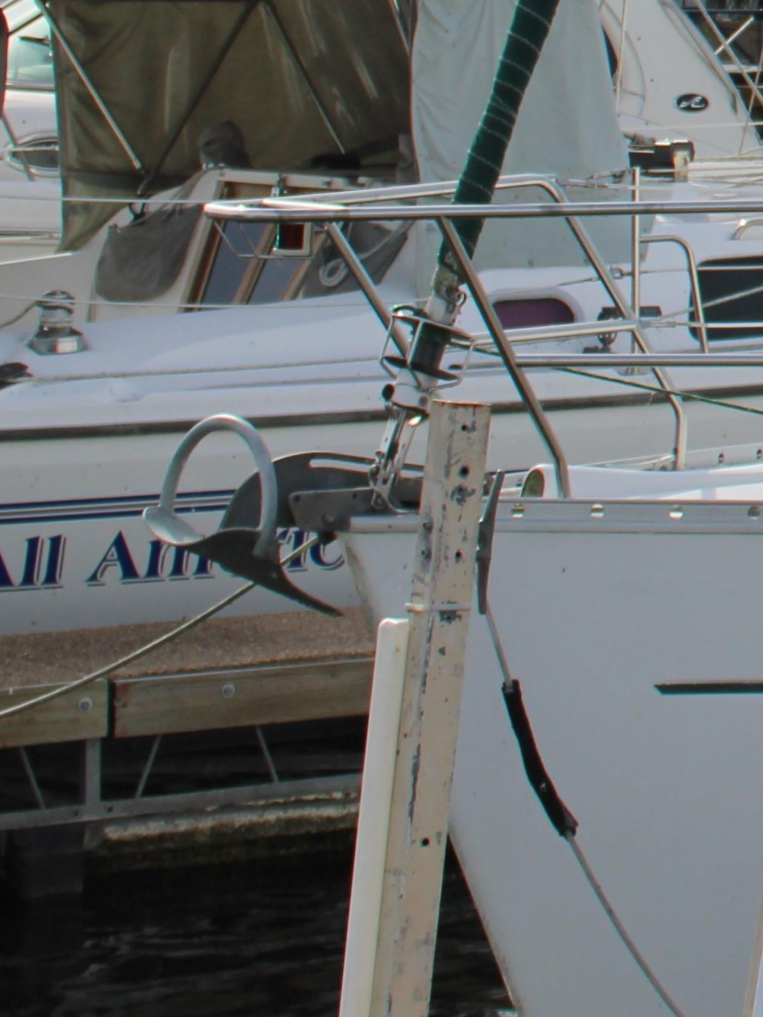

I currently have this anchor on my 2002 Beneteau 331 (see picture). It is a great anchor and I do not have any issues with it breaking loose but I do have two issues with it;
1. I do not have a windlass and it is very heavy to pull up. I end up pulling this anchor 3 times in one day sometimes. My kids like to swim at a few different places and we usually anchor for the night in a different location.
2. It has a tendency to bang into the front of my boat, below the bow roller, as I pull it up. They should have extended the bow roller a few more inches forward in my opinion.
I’m thinking of switching to a fortress FX-16 (I had this type on my previous boat). I’m wondering if anyone has one on their Beneteau so I can see a picture of it? I am a bit concerned that the bow roller design is not far enough forward from the boat causing the flukes to rub against the boat hull.

You have a Mason Supreme now..... great anchor. My Rocna will hit the boat if my wife powers too much while lifting but I am willing to take a hit every now and again for the security it gives me while at anchor. I also have a Fortress as a back-up however never have used it.

Get busy and install a deflector plate like this to protect your bow.
You will eventually need a windlass if you carry 400 ft. of rode as we do. Your time has come.
The anchor you now have looks like a Manson Supreme, and as such, you could not do better.
Get to work and enjoy it now.

I do like the fortress, as I said initially I had this anchor on my previous boat. My question is not “is this is a suitable anchor“ my question is “will it hit the boat when pulled in and stowed on the tiny Beneteau bow roller”?
I want an anchor that is light and easy to handle as well as one that is not hitting any fiberglass surfaces when used. My mason supreme is a great anchor, I’m not disputing that at all. The problem is that it hits fiberglass surfaces EVERY TIME I pull it up, and I’m a pretty careful guy (Bad design).

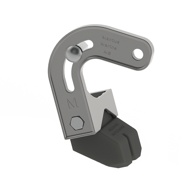

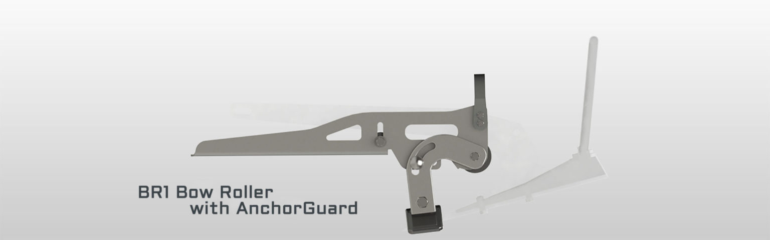

I bought the Mantus for my boat. To hold the anchor off the boat and secure should a wave hit the bow, I installed their Anchor Guard.
It attaches to the bow roller and when the anchor is retracted it contacts the anchor tip and holds it in place.

Good idea! I guess I could get one from Amazon and return it if it’s not working. I was hoping someone could post a picture of it on their boat..
