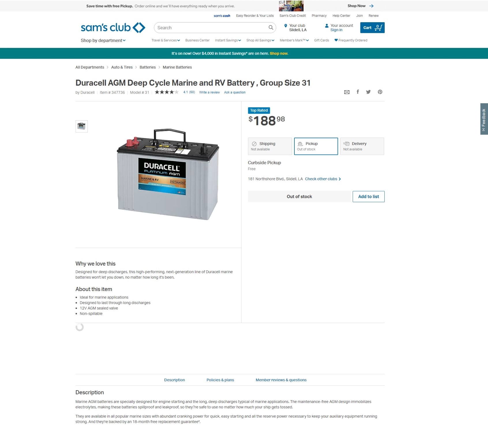

So I opted for the Gp 31 AGM batteries from Sam's club (appx $200ea)....supposedly the same manufacturer that West Marine sells for substantially more. My battery compartment is under the aft berth area; I didn't want the hassle of having to take things apart to check / add water and I didn't want a flooded battery venting into an unvented space that contains the charger and open to the engine compartment. My last set of Duracell's from Sams lasted seven years and I fried them at least four times.
