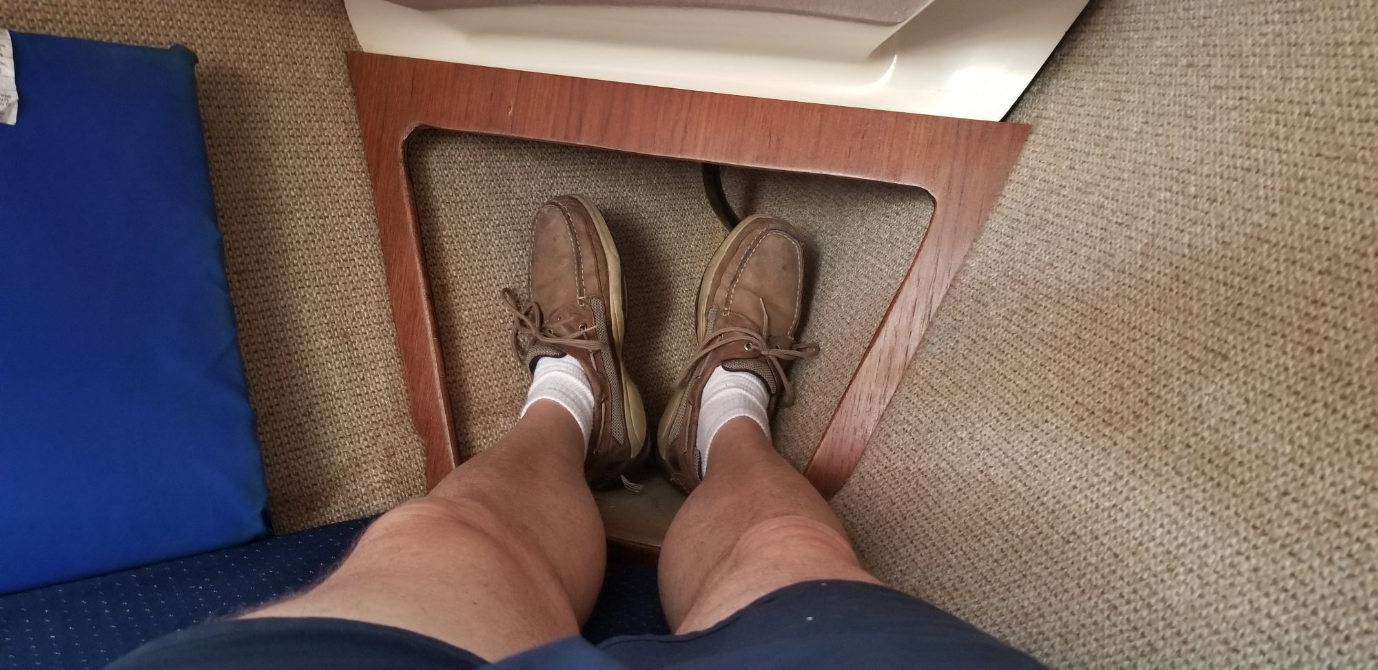

Thanks for this info. I wound up removing the fore peak bulkhead and trimming it down and restoring it. Now, when sleeping in the V Berth, my feet are in the space beyond the fore peak bulkhead giving the V berth length an additional 12 or so inches. What a difference indeed. I maintained the integrity of the bulkhead by adding a ply to it increasing its thickness.

Here's a couple of pictures of what I have done so far. I intend to remove the fabric and replace it with bubble wrap insulation and wooden planking like I did in the main salon. I'll post pics of that when finished. I think I'll fiberglass more structure into the boat up there when I put the furring strips in for the planks. This way I can completely eliminate that pesky bulkhead!
Should be fun! Thanks to all for the great ideas.
