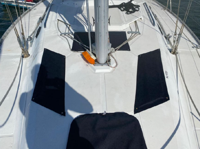

I went to look at a HL37 1987 yesterday.
As usual, the add looks better than the boat in person but it was not that far off.
My girlfriend came with me and noticed the hi humidity inside the boat right away; she told me after we saw the boat.
The broker mentioned a leak or 2.
The big question I have is:
That the owner replaced the foreDeck sealed windows because they were leaking.
He said he could not go EOM because the boat was old and was FLEXED and so EOM would not fit.
He then had a carpenter make custom windows where the frame is of wood.
He also labeled the area around the windows with "No Step".
I asked the broker about the NO STEP as I would certainly be stepping on them or the crew when folding the sail on the boom, putting the cover on the main sail etc etc.
He said that is what the LAZY JACKS are for. Anyhow, I did not argue.
Am I mistaken or is this an oversight on the carpenter/ owner to not have better foredeck windows you can step on?
They lay flat around the MAST almost horizontally.
Also the wood frame looks out out of place as the rest of the deck is white and no wood trim. The Port/window hatch border are black/plastic.
I almost did not notice because they are covered nicely.

I don’t love the idea of the boat having flexed the the point where original equipment windows wouldn’t fit anymore. I’d wonder if leaks around the original windows let the core rot and sag. So those would definitely be areas I’d want a surveyor to check if you move forward.
As you said it would be better to be able to step in those areas when you’re working on the main or just going forward and aft on the deck for docking. But I don’t know if the original glass would’ve been safe for a step or if that was just a design limitation to begin with. Others with Hunters of that size and era may be able to say more about that.

I think Alan summarized it quite eloquently. Using wood as a window frame - Irwin tried that years ago which failed miserably. Some unknown carpenter likely won’t have any better chance.
Find a better maintained boat! And a better broker.

The broker is overloaded with :poop: and has a limited knowledge of sailboats. Replacement of hatch lights is a common procedure and are NOT replaced using wooden frames. We've seen a lot of discussion of this topic here and that is the most likely to fail repair job attempt I've seen to date. Listen to your girlfriend as she's seen what lies ahead with the humidity. Mold, mold, and more mold in hidden spaces which you haven't yet seen.
You NEVER step on the hatch lights or the hatches of a sailboat. If you do, good luck with any boat you should ever own. Stepping on them guarantees leakage in very short order. Sort of like what you're looking at now.
My advice is to RUN, not walk away from this boat. It has been destroyed by the previous owner and the broker is covering up. Buying it will ensure your spending endless dollars to keep it afloat.
Imagine what shape the engine must be in or have you not looked at it yet ?

SURVEY the boat if this is your dream boat. If not continue your search. There are lots of boats available in Florida. Some have been bought to flip after being storm damaged.
The story of the boat sure implies that there has been water damage near the ports in the bow. I would avoid any boats that have water damage in the deck. That is a non starter for me.

Thank guys..
Not in love with the boat but the listing was promising... jajaja
first boat my GF sees with me ... bad experience for her.
Will keep looking and TRY to no Fall in love..
Makes sense that I do not want to step on fix port windows.. I will certainly look for decks with NO PORT lights near the Mast lol.. what a bad design IMO even with OEM port lights.
Couldn't agree more; stepping on acrylic deck lens and acrylic hatches is a sure fire way of causing them to leak prematurely.
Not crazy about using wood frames to replace broken or crazed acrylic lens; the preferred method is to use the old lens as a template and use cast acrylic to fabricate new ones. Adhere with 3M VHB double sided tape & seal with Dow 795 sealant.
Not sure it is idiotic, but it is not what you say to a prospective customer.
If you have a good set of lazy jacks or a dutchman or a stack pack flaking the main and storing it is pretty easy.
Nonetheless the boat is a poorly maintained boat by a poorly informed owner being sold by an ill spoken broker.
