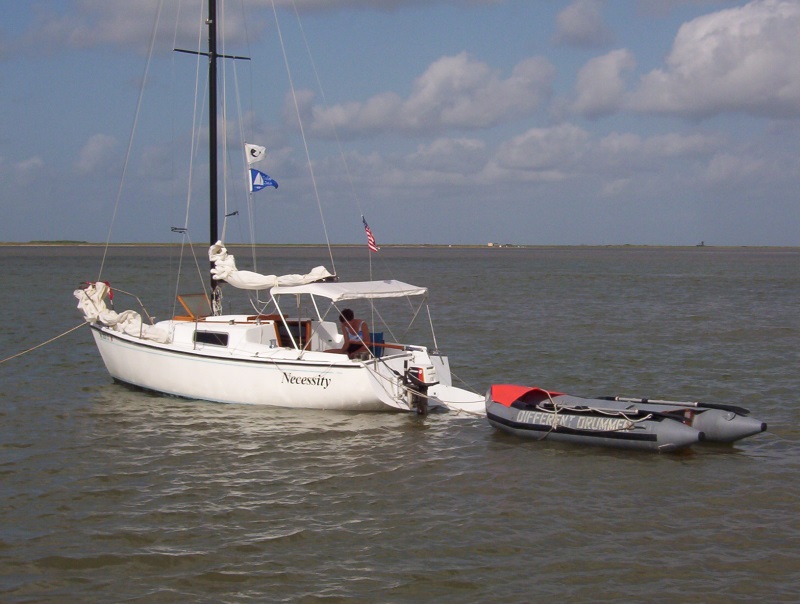

I have sometimes used a small anchor off the stern, but to one side, just to stop, or limit the swing. I would NEVER anchor bow and stern- when that is required i use a Bahama moor- both off the bow, which allows the boat to swing with tidal shifts, or wind change. In this picture there are actually two anchors attached at the bow, but the one led aft is just dropped inside the stern cleat. Bedtime comes, it gets picked up and dropped to the side so the boat can swing. The beach is just out of sight behind the dinghy
