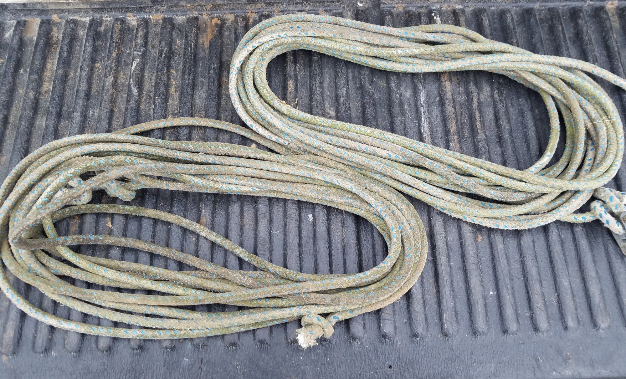

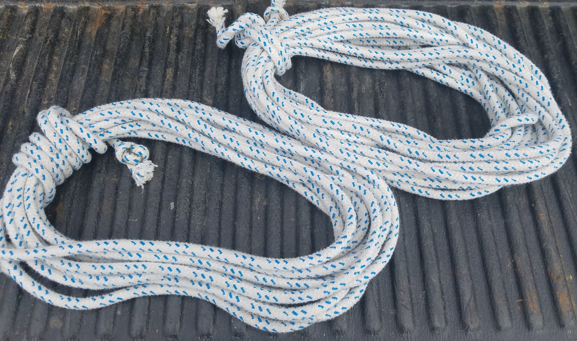

Winter is coming to an end here in Indiana and I am getting Spring Fever. I decided to see if I could use the old cruddy halyards that were still on my mast instead of buying new. I soaked them in a combination of Dove soap and 10% bleach then ran them through the washer on the Heavy Duty cycle. They came out looking great. Soft to the touch too:)

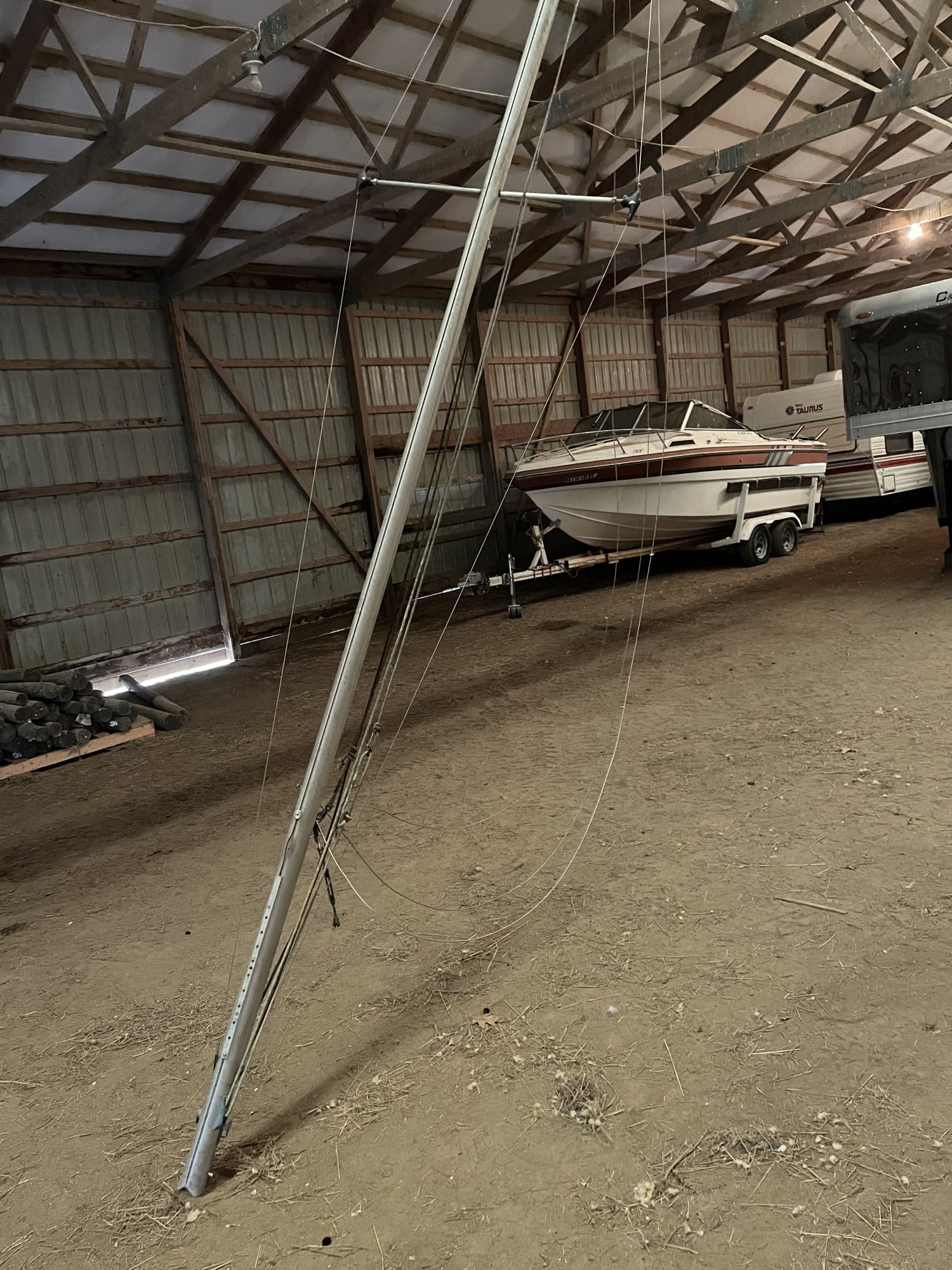

I'm still discovering things about this Ford 20 that I don't understand. In this picture of my mast, you will see that the shrouds going through the spreaders are attached to tangs at the base of the mast. Is this typically the way to run these shrouds?
24,740
Not sure I understand your question.
The shrouds run from the mast head to the side deck of the hull. The spreader functions to fix the angle of the shroud top to bottom and to fix the mast in place ( stop the mast from lateral bending sideways )
The tangs you mention should have a fixture ( chainplate) to connect to on the deck. This connection serves to mange the forces transmitted between the mast and hull.

Yes, that is the way I thought the lower shrouds would attach also. But, on my mast I have two sets of shrouds. One set attaches to chainplates on the each side of the deck. The other set goes through the spreaders and then is attached directly to the mast about 8" from the base. It was explained to me by another FORD20 skipper that this the same as his.
