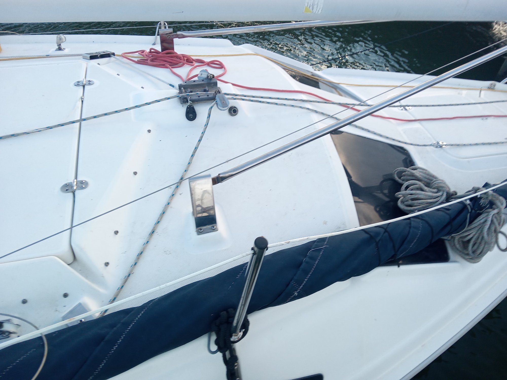

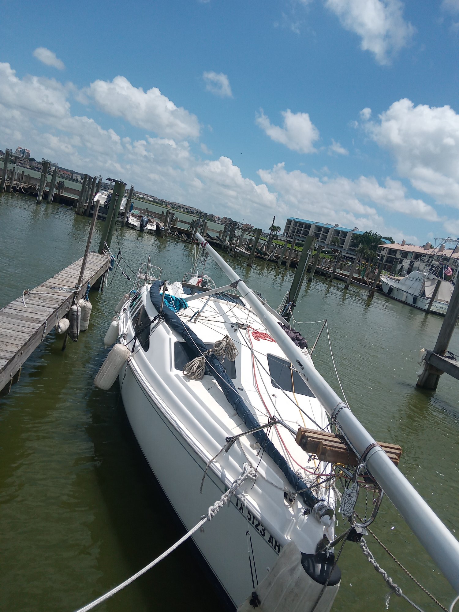

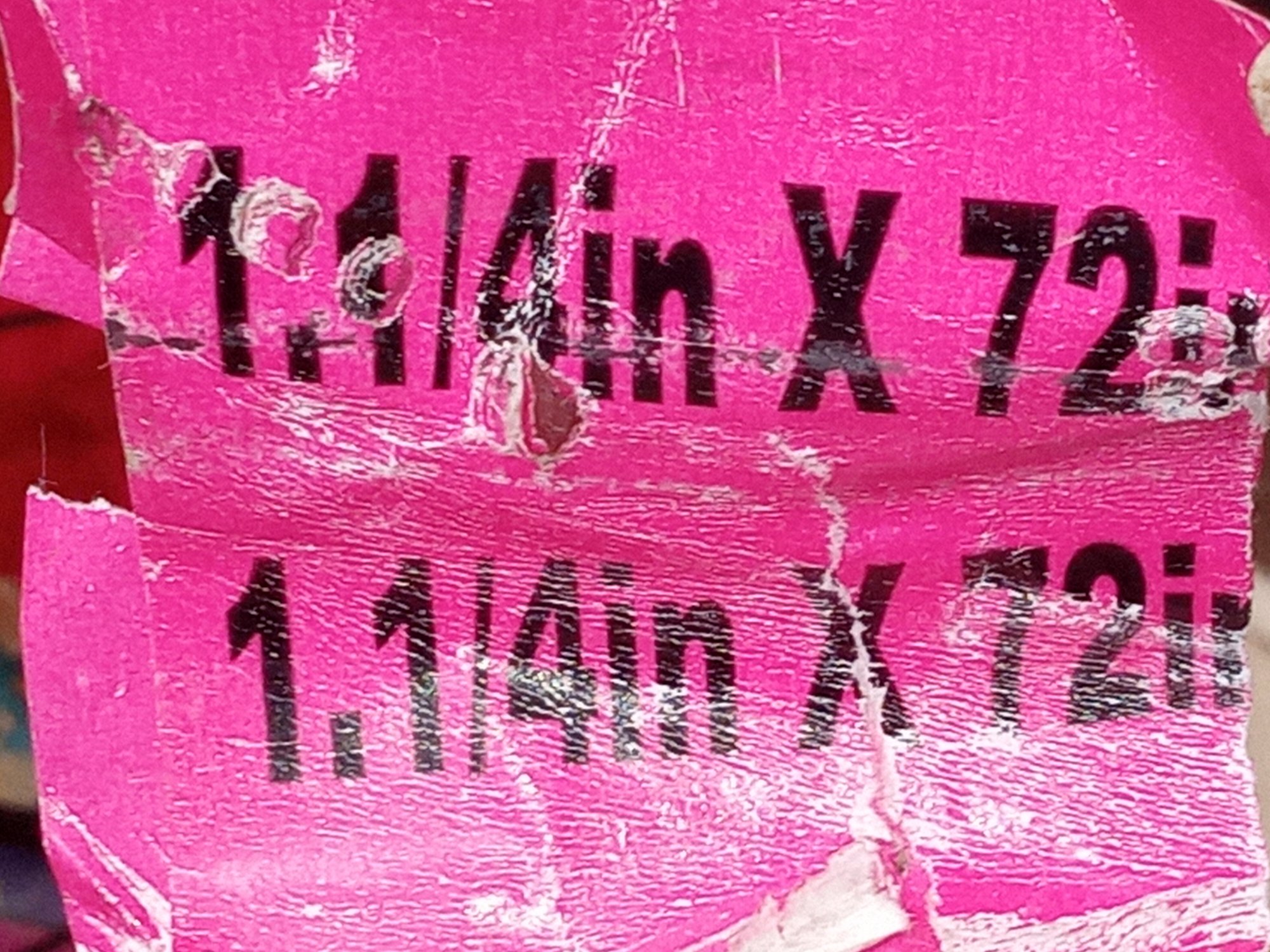

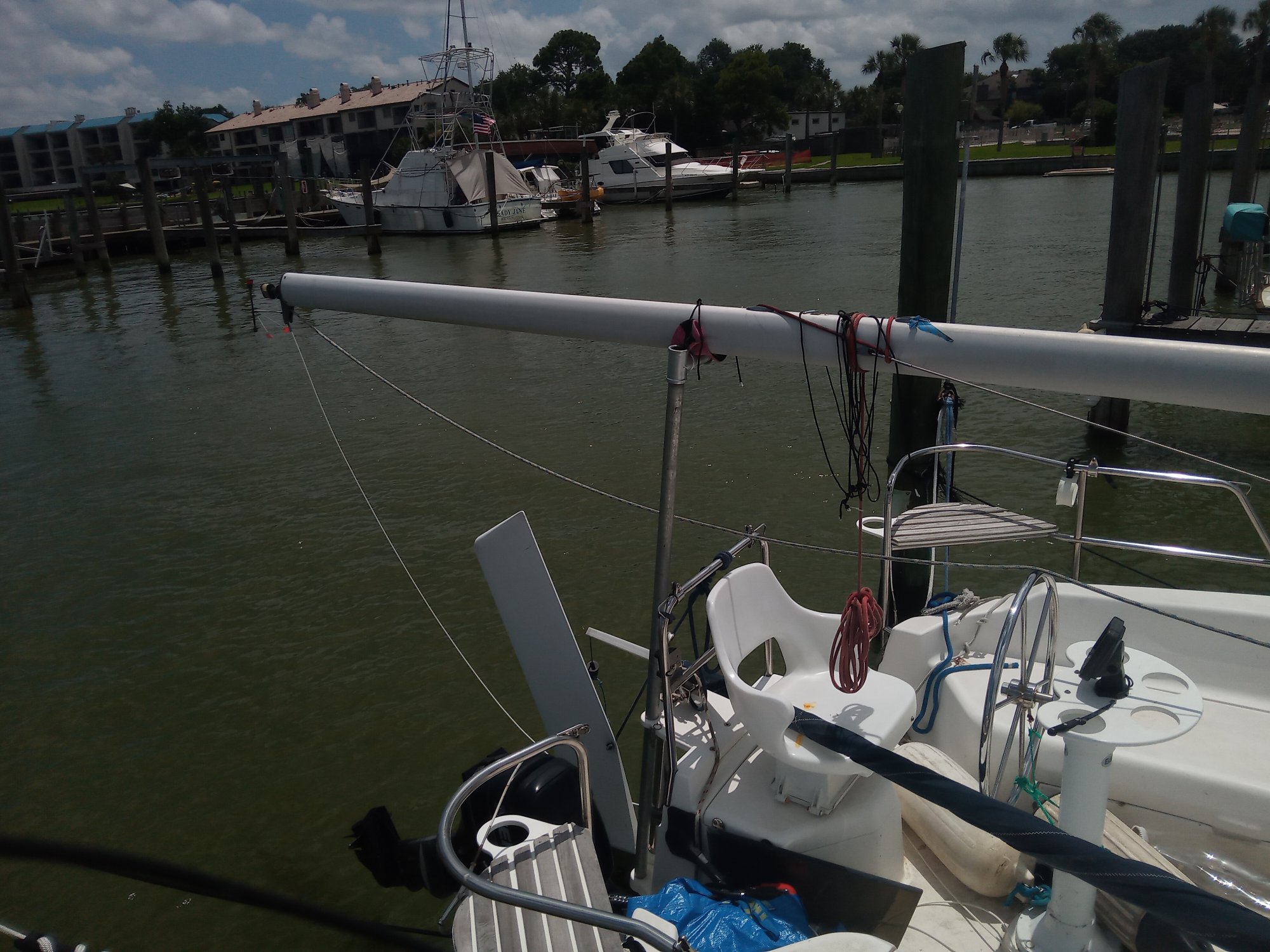

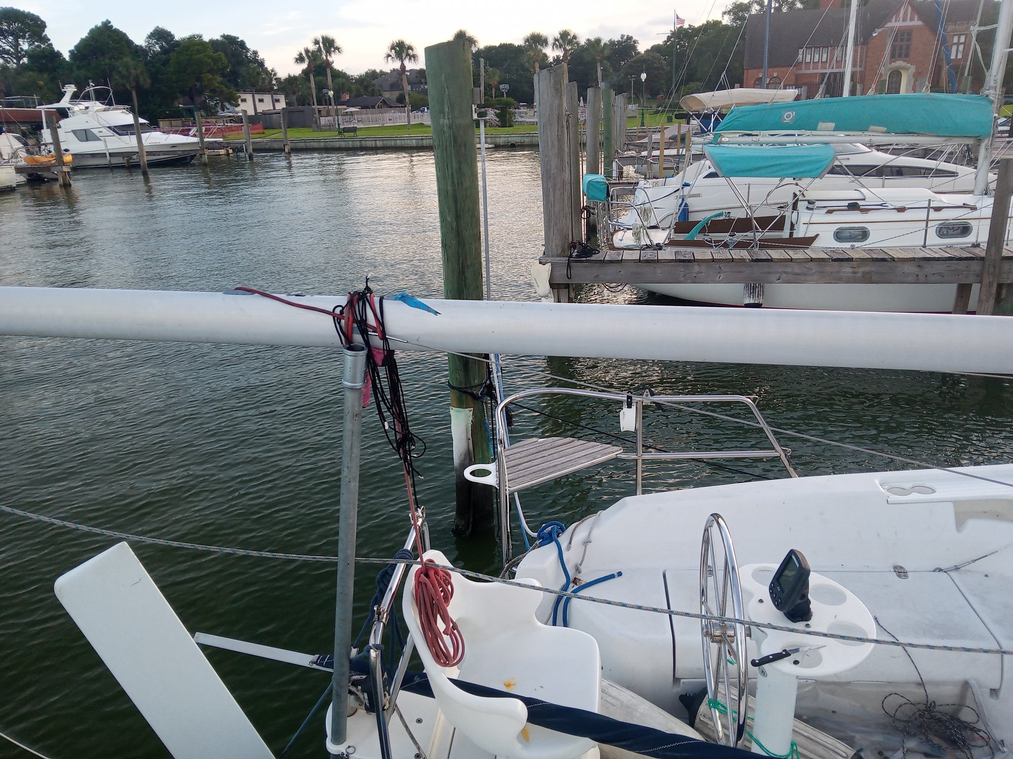

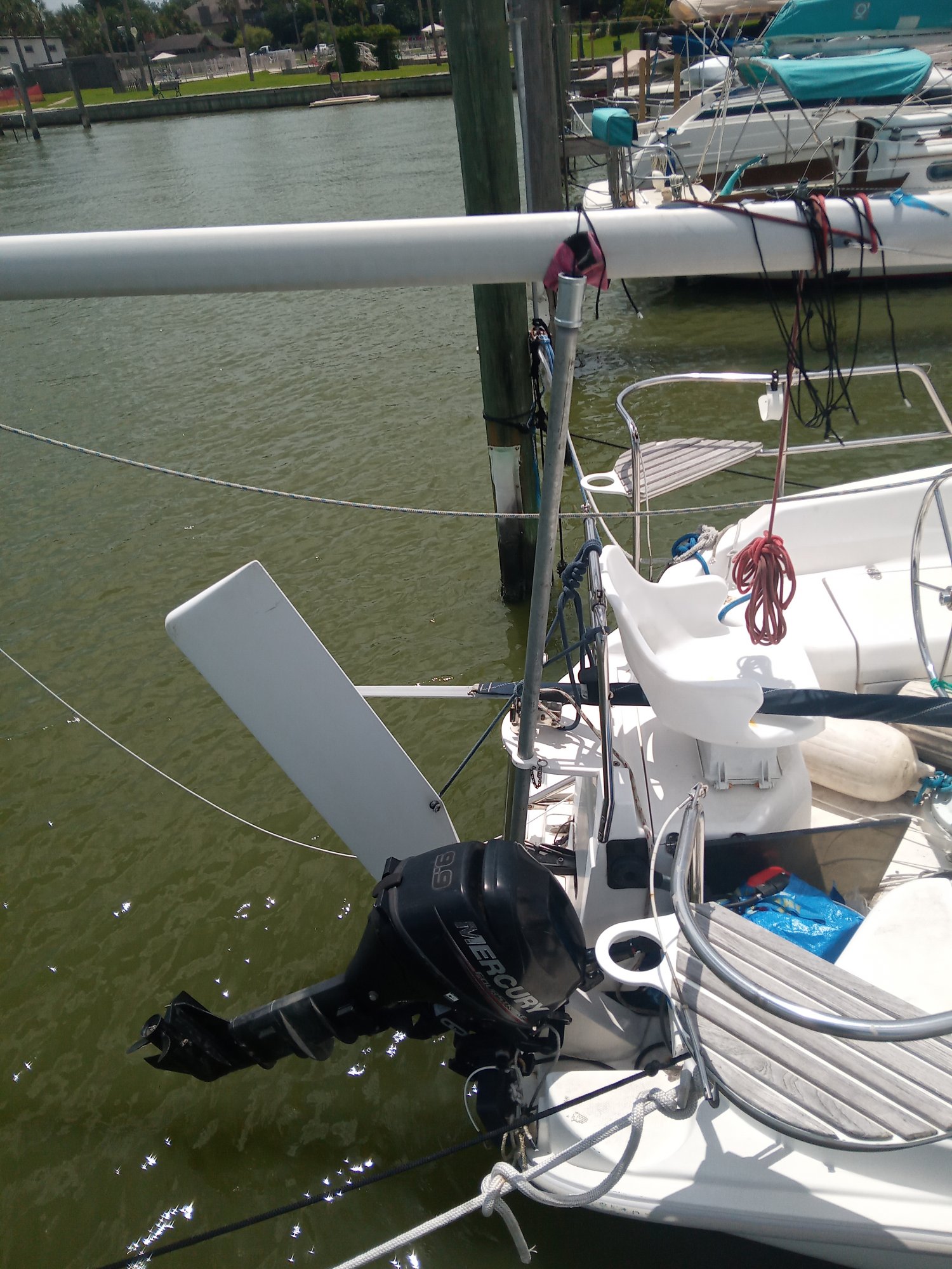

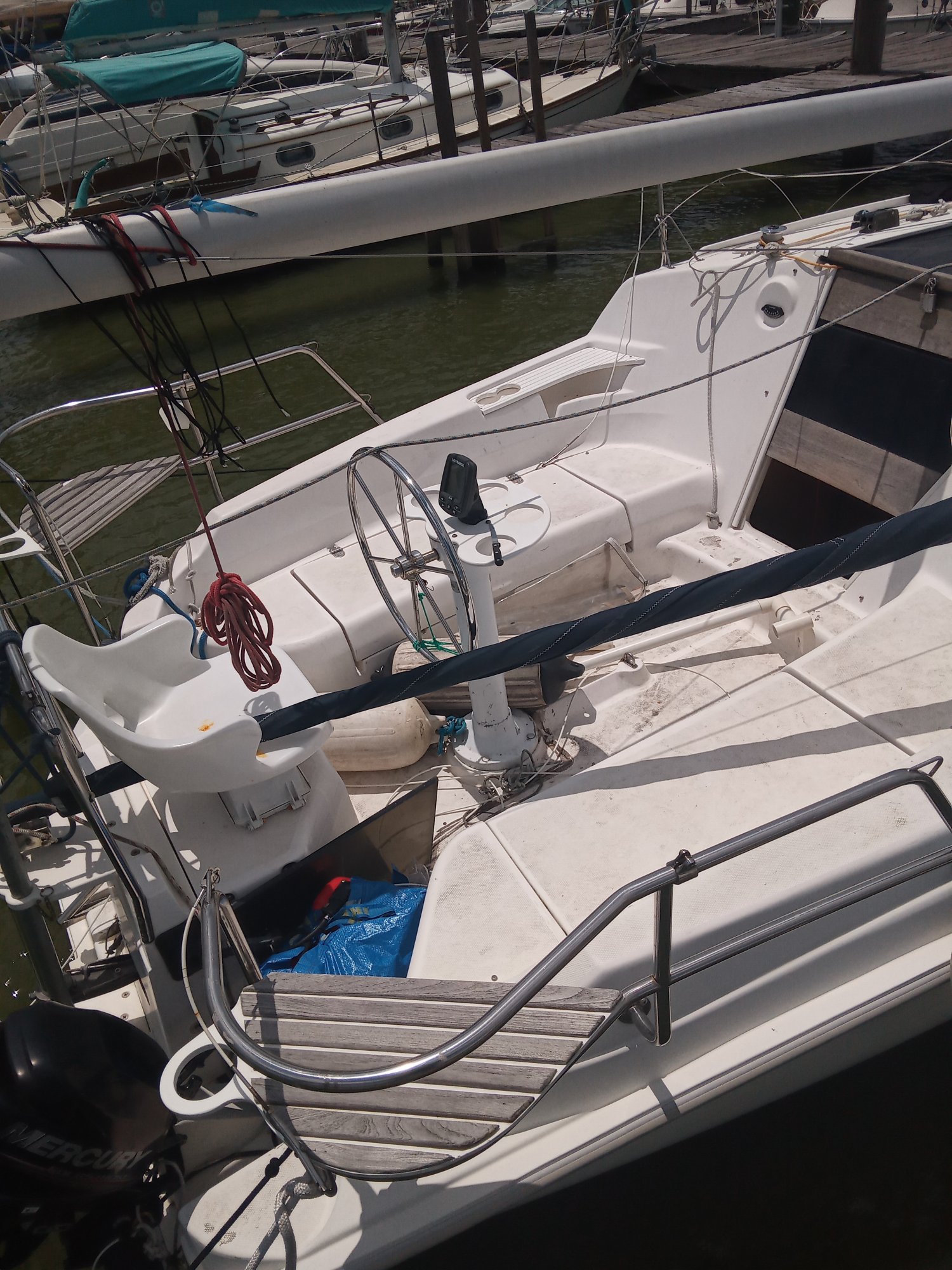

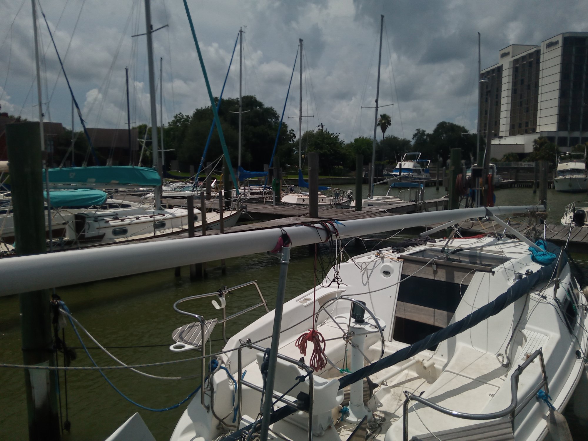

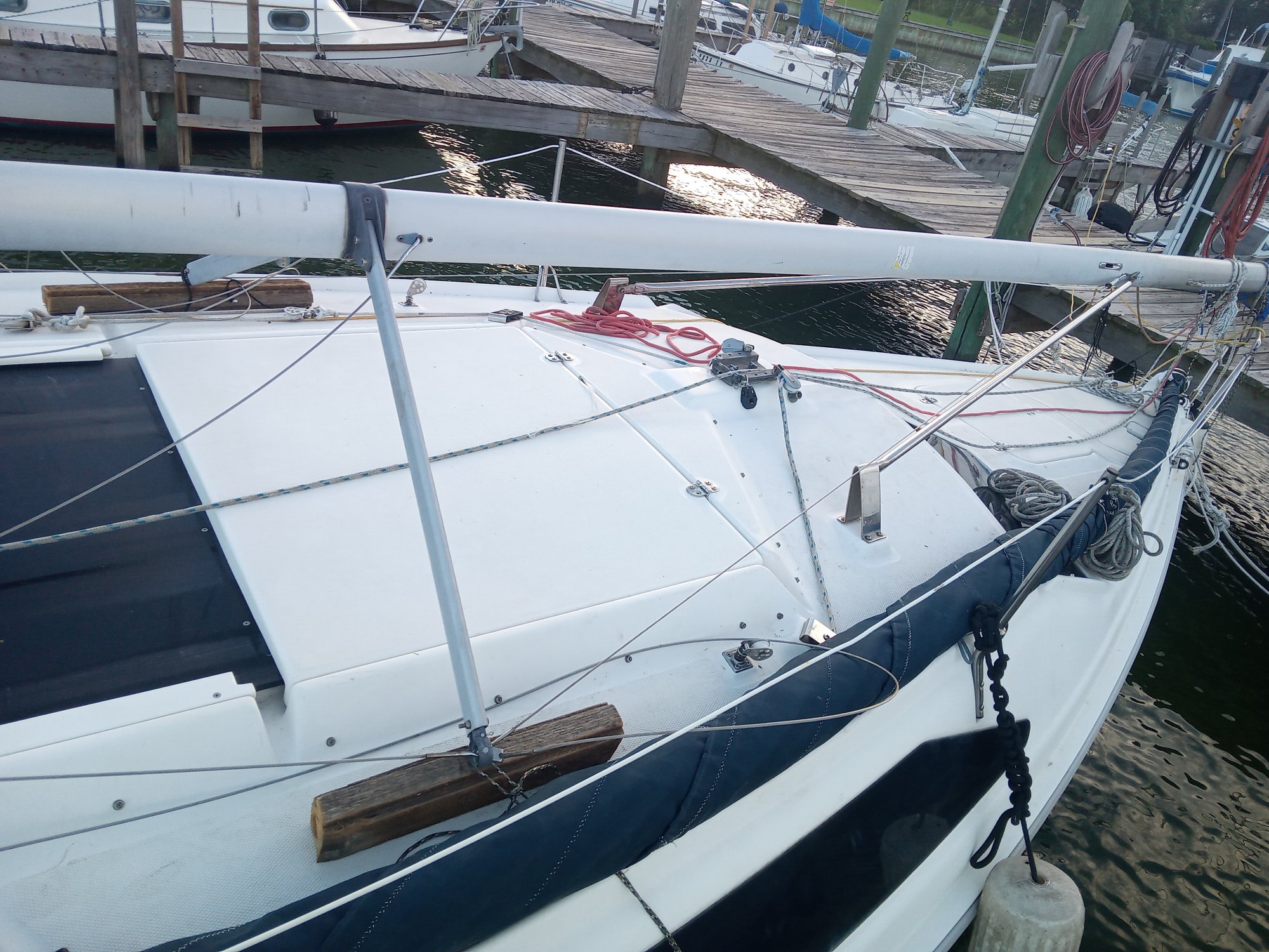

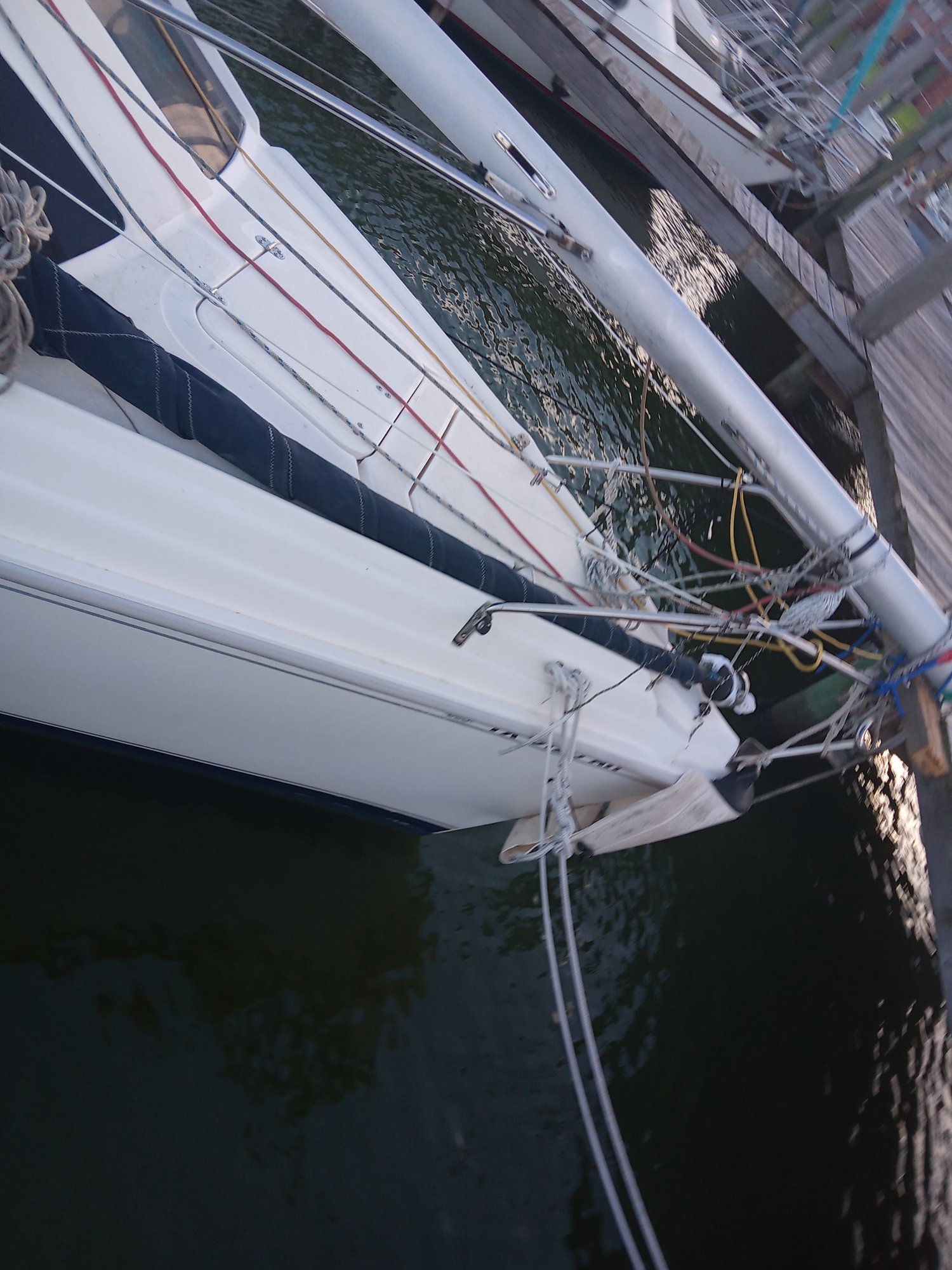

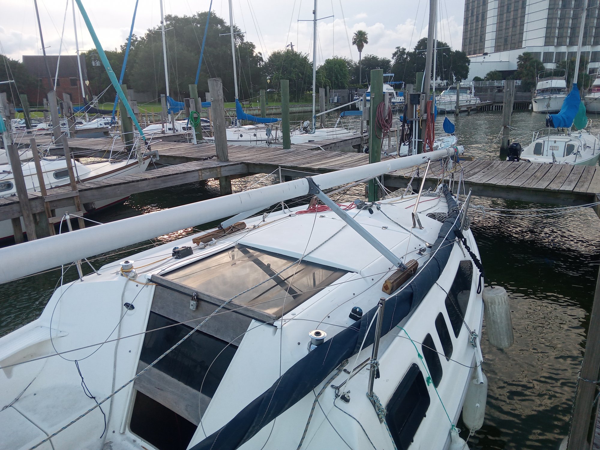

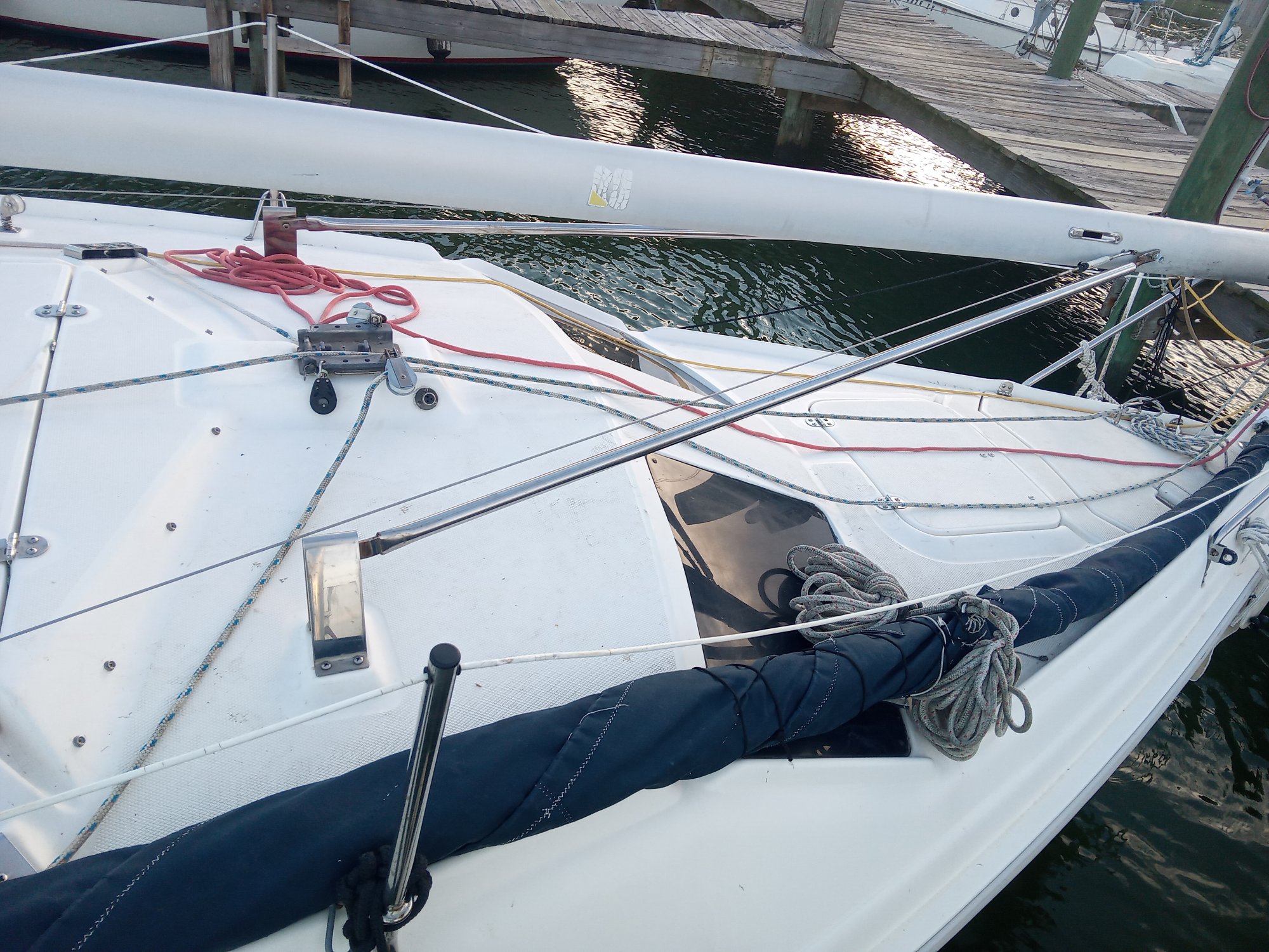

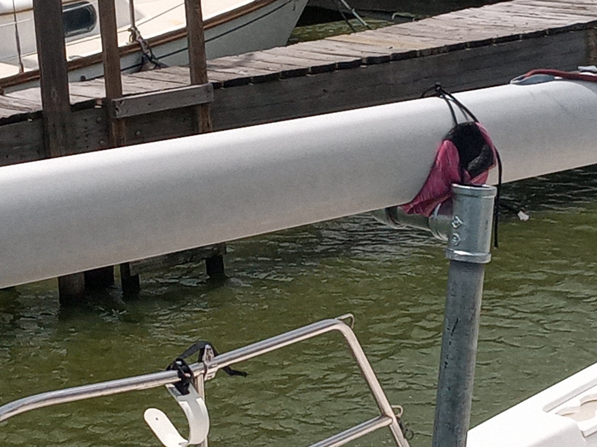

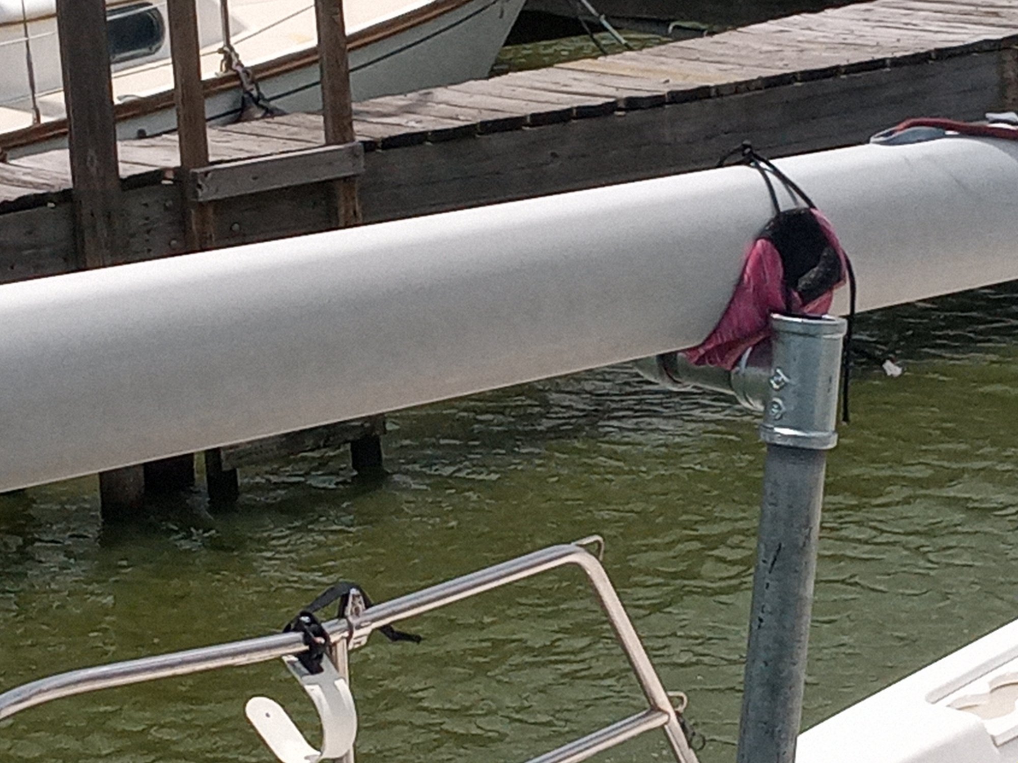

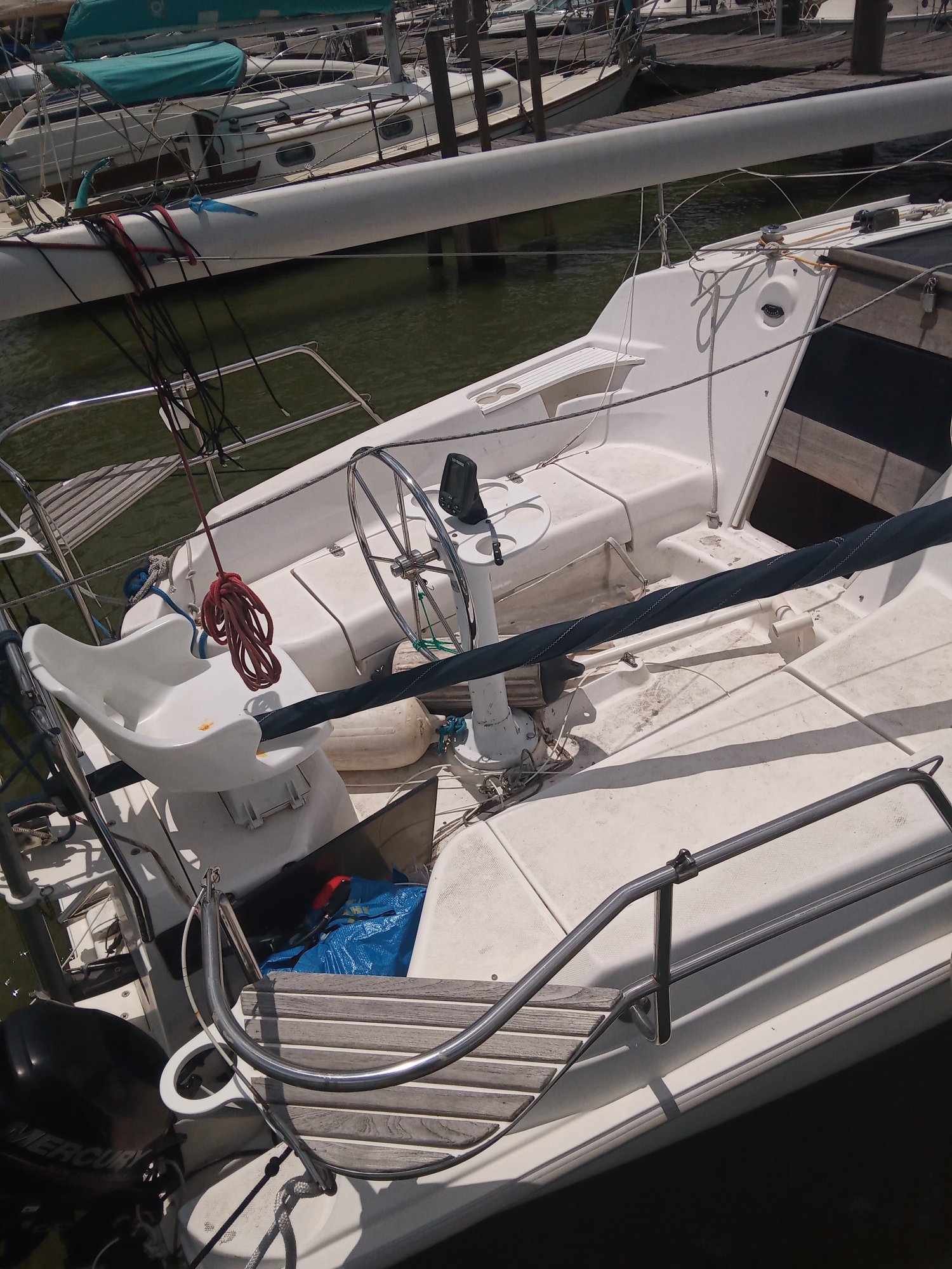

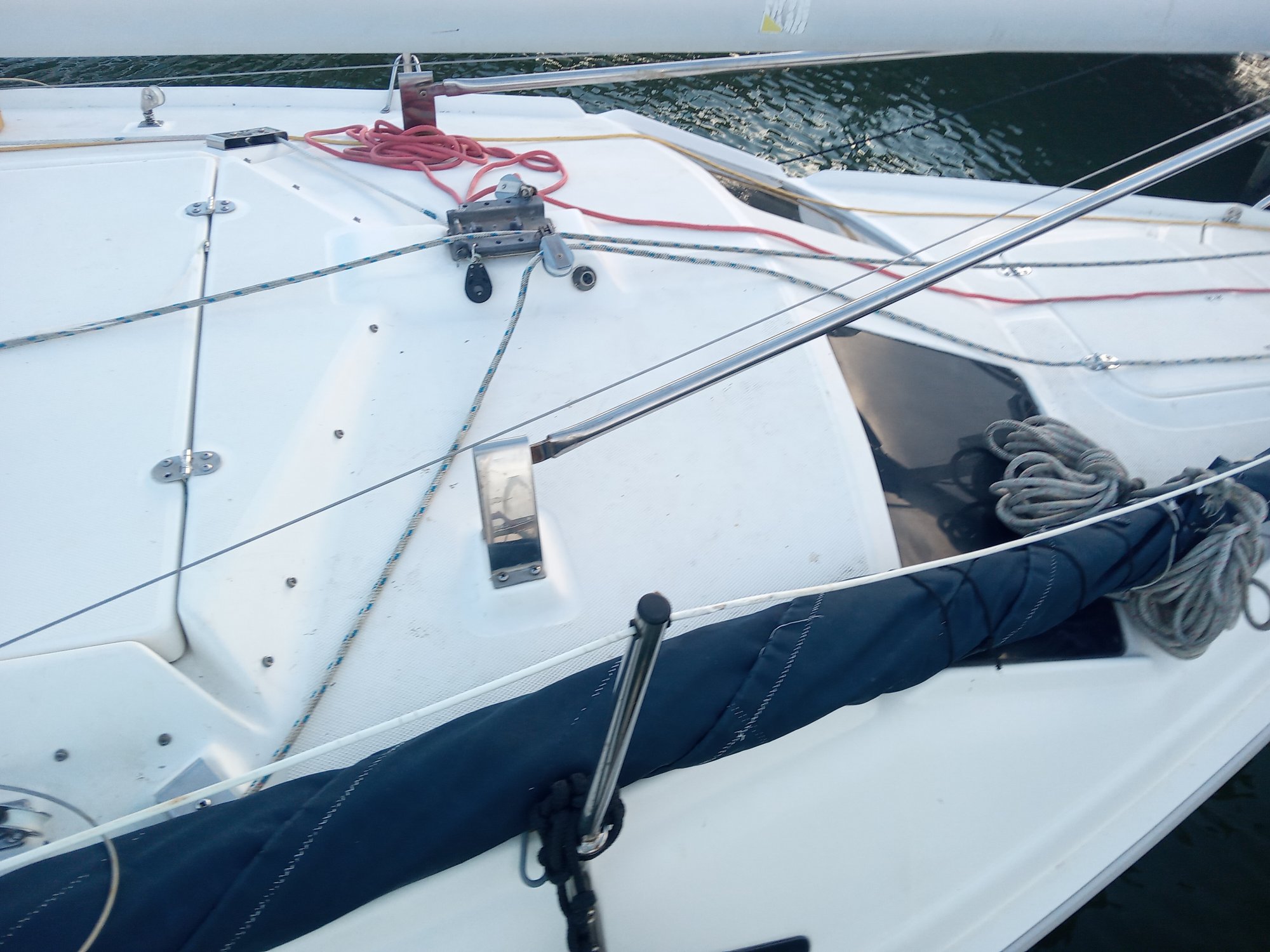

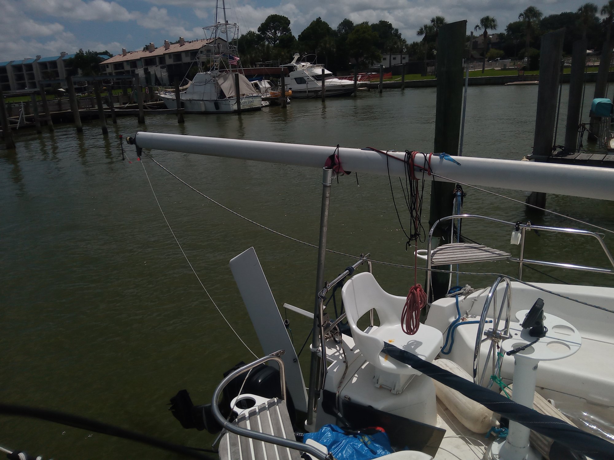

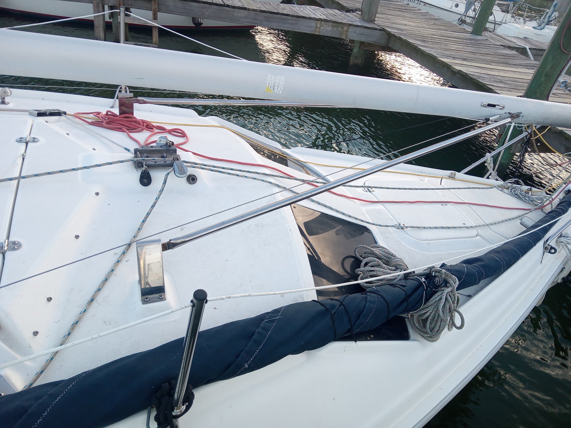

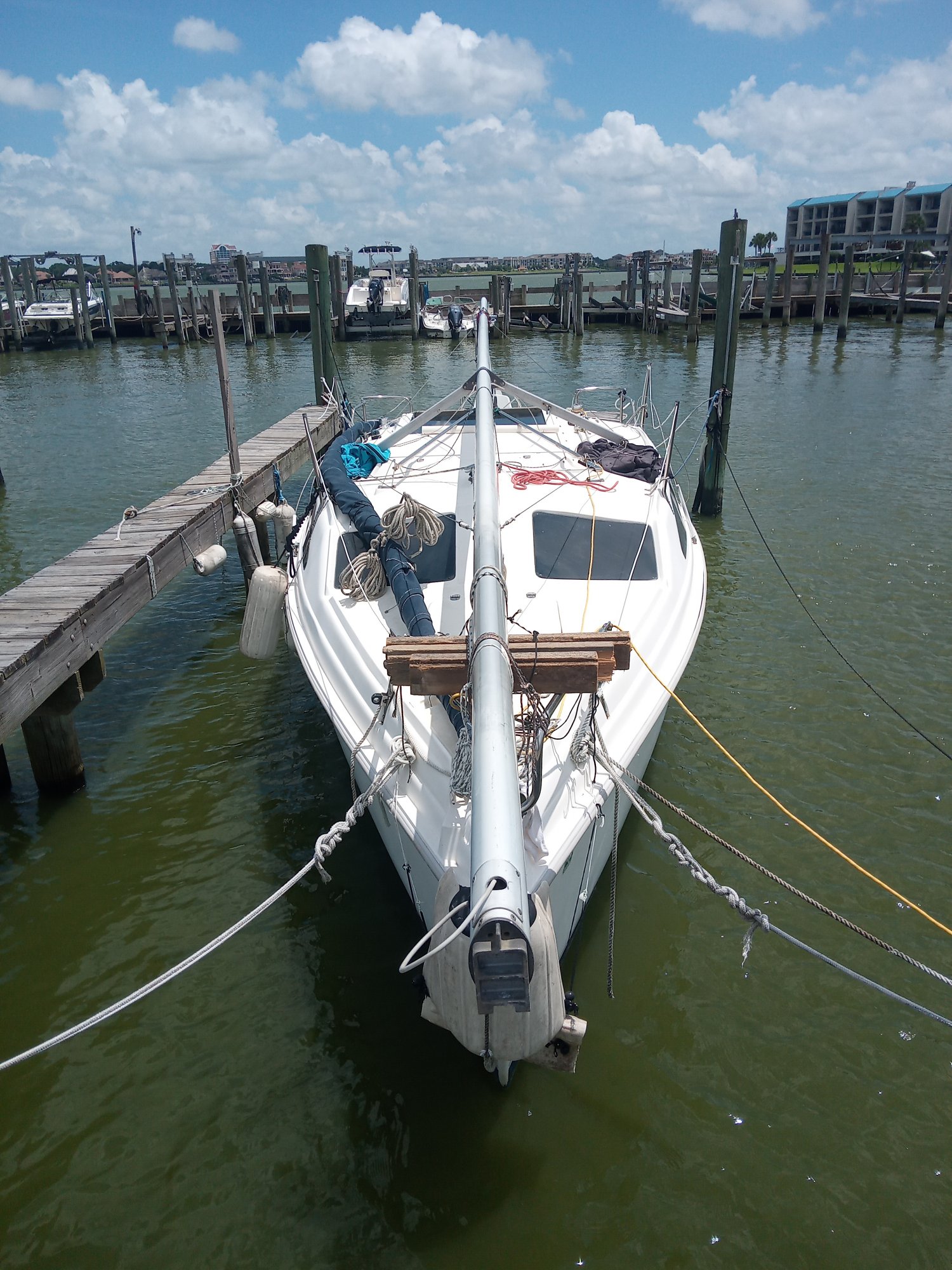

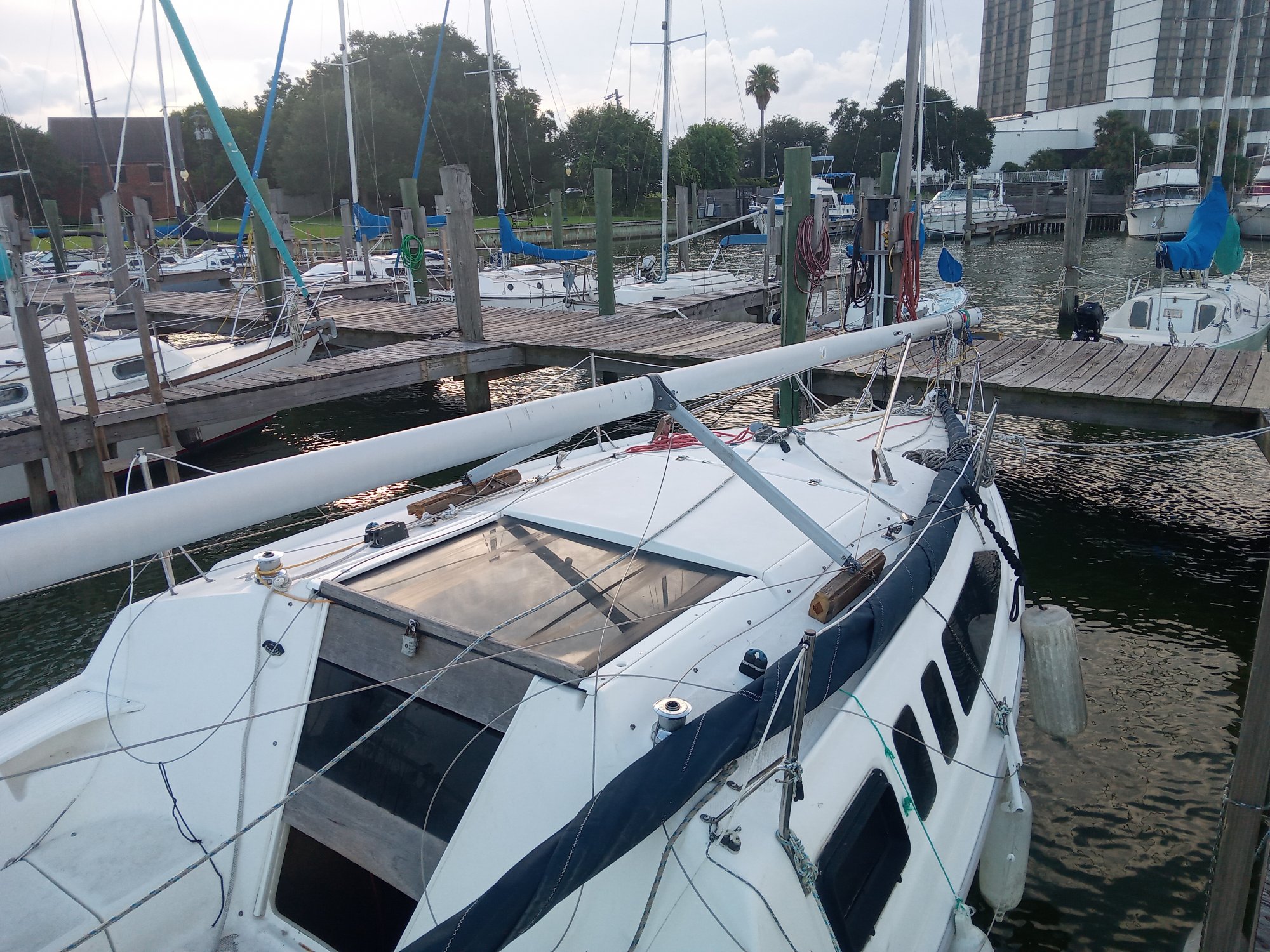

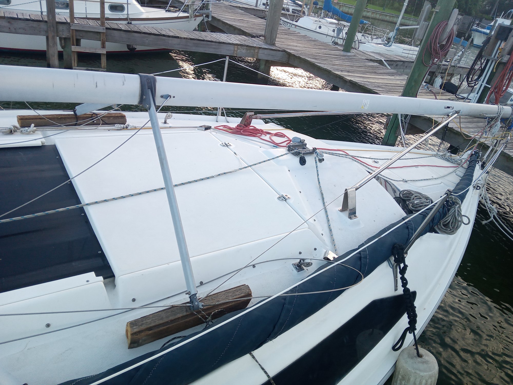

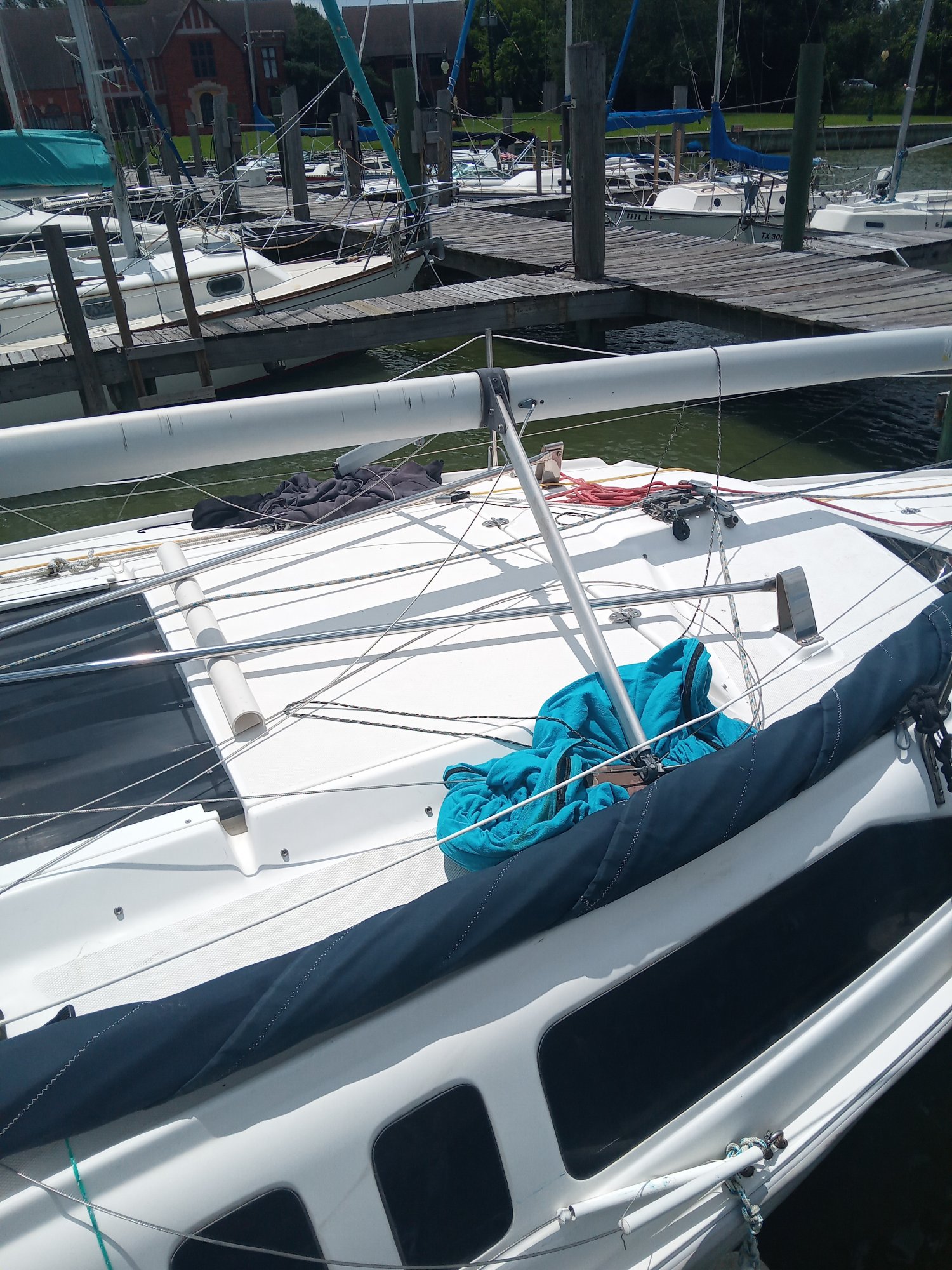

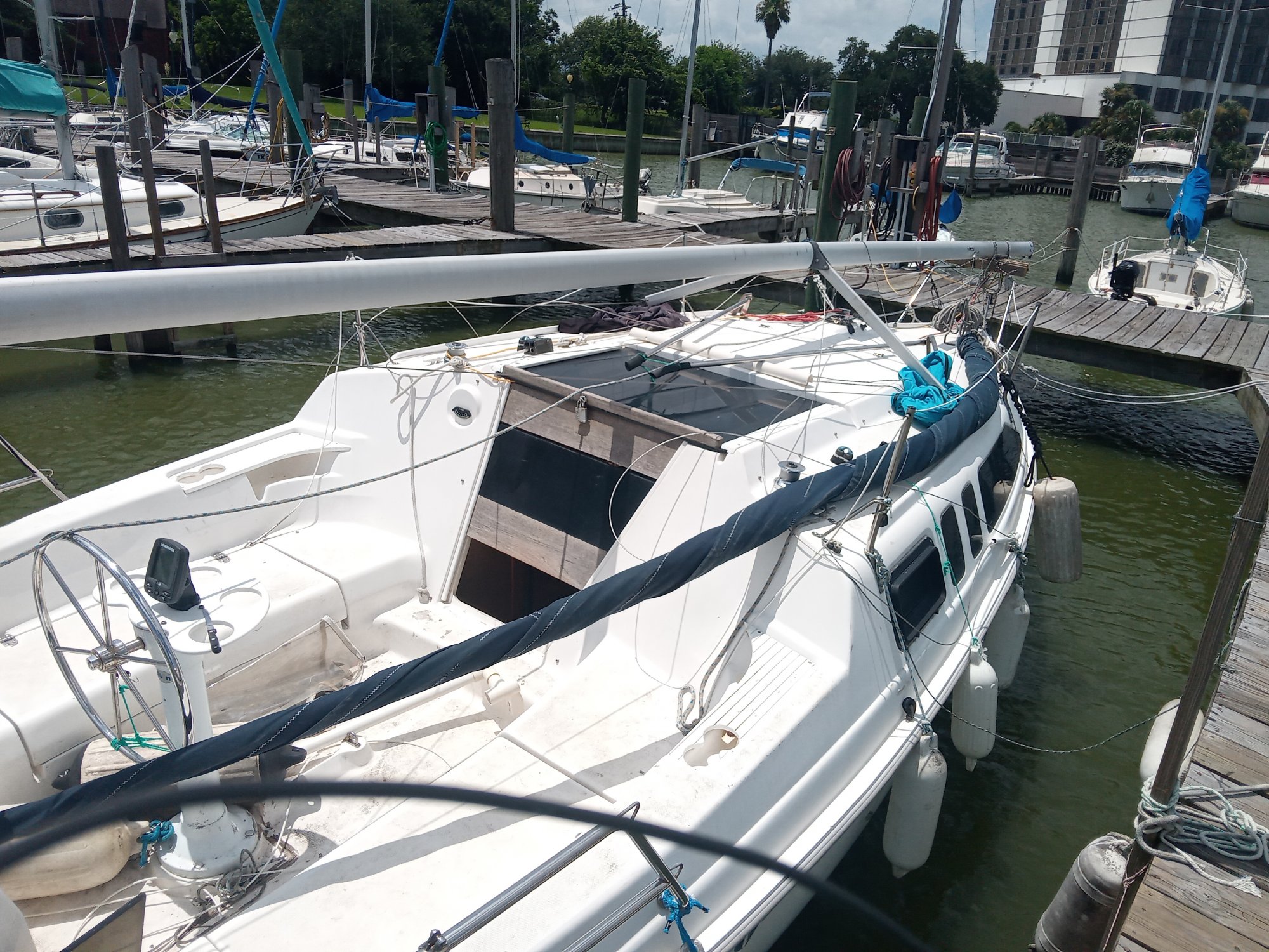

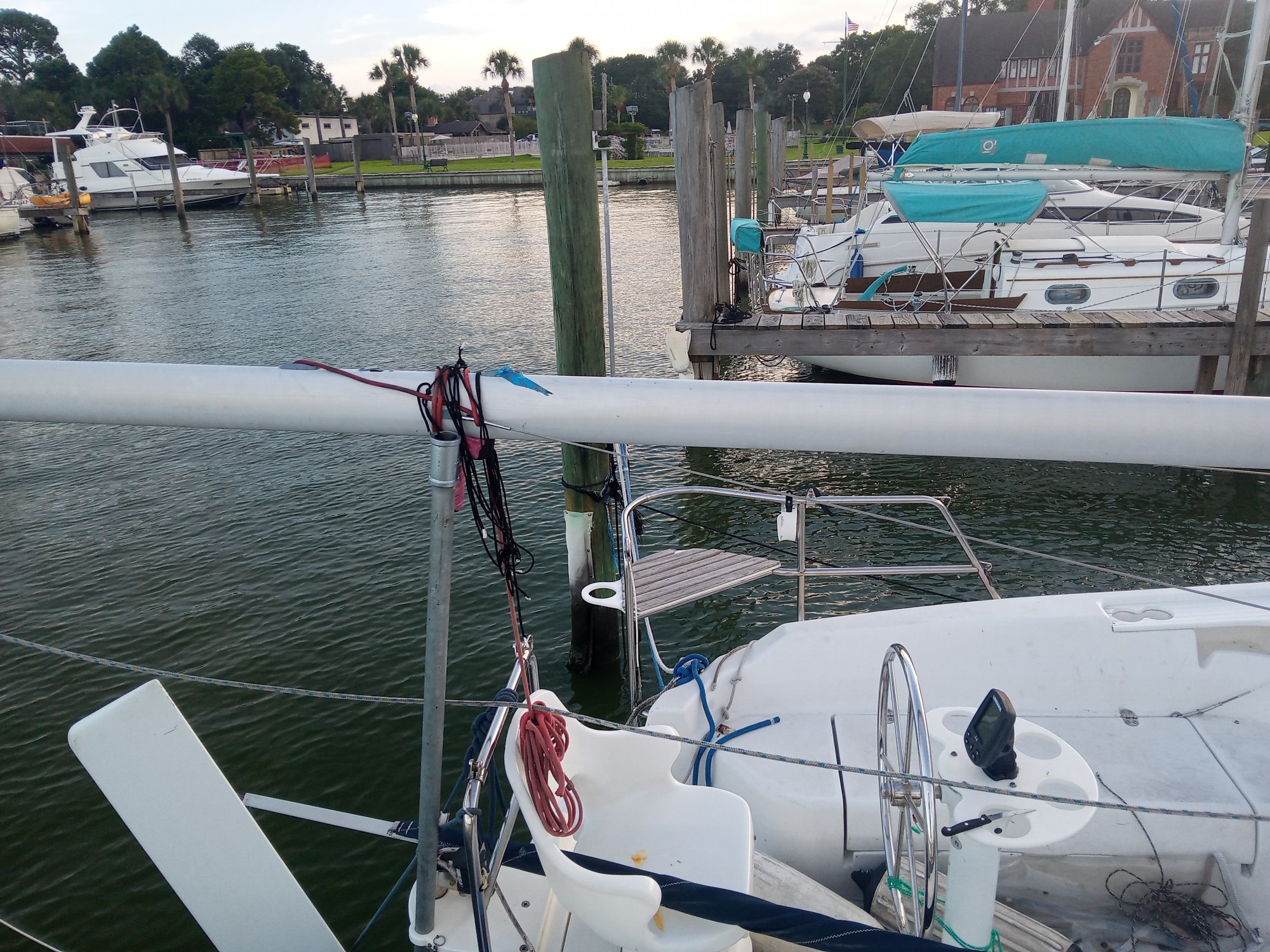

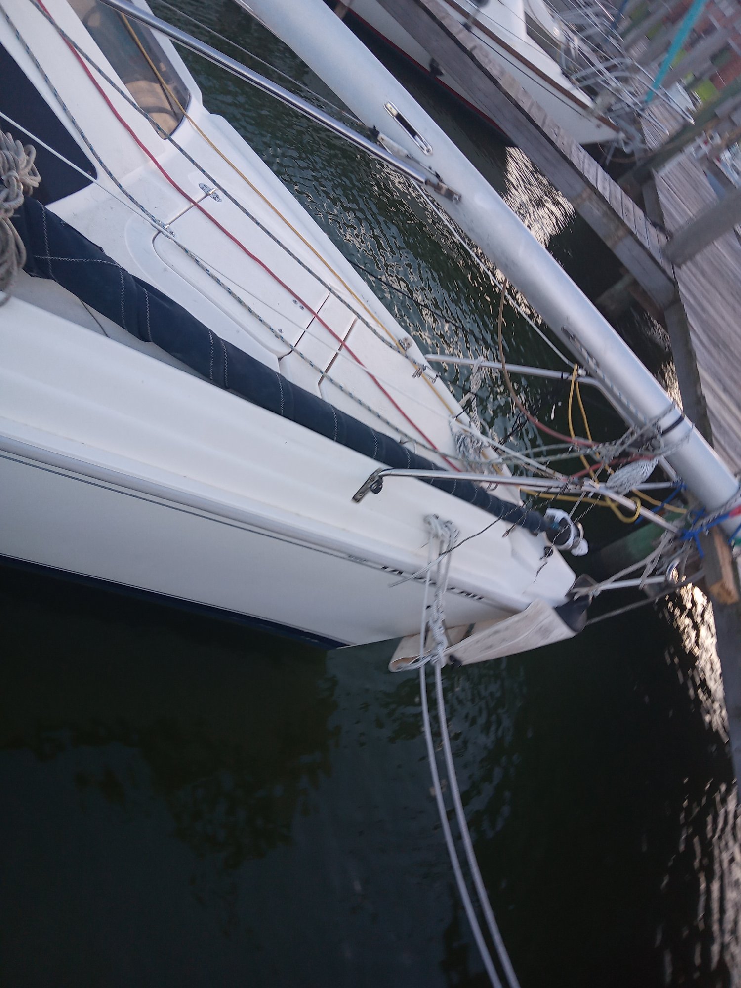

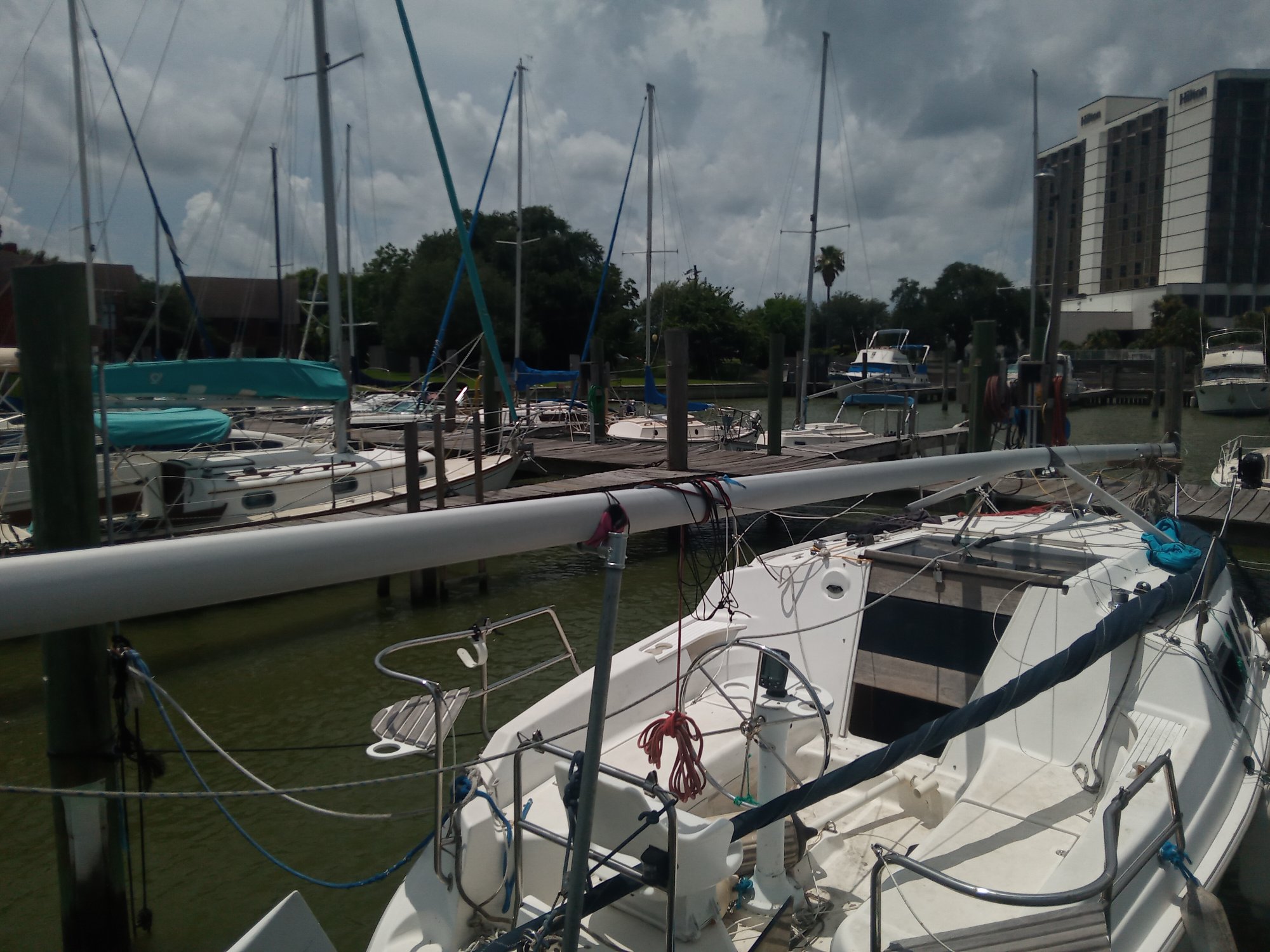

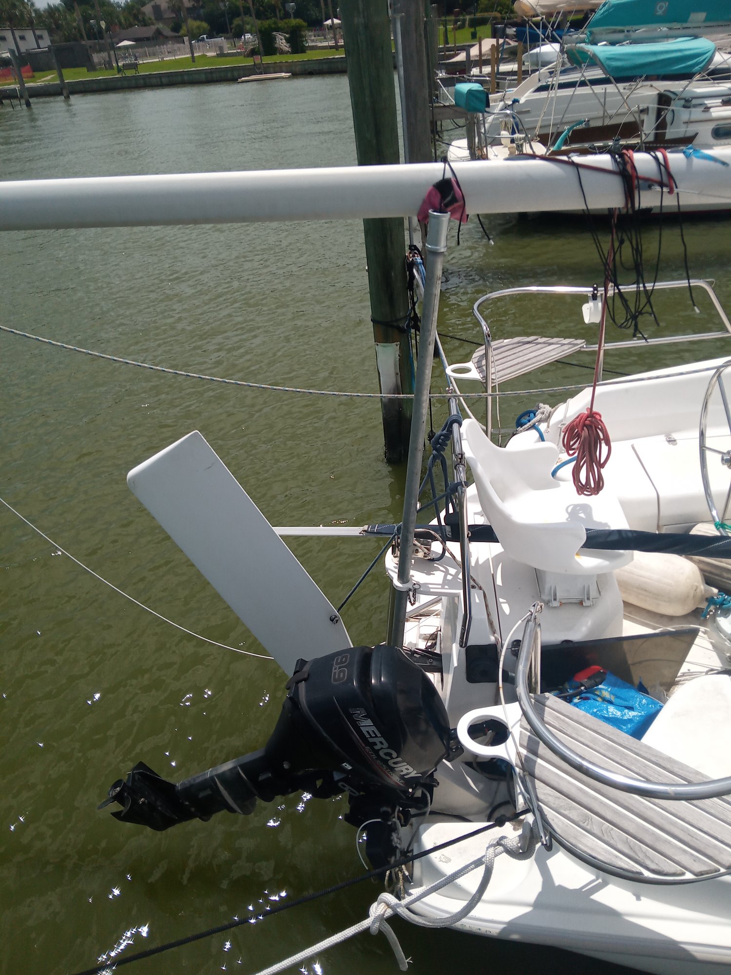

For mast crutch h260, easy to use from Lowes 1 1/4 x 72 inch galvanize pipe and t-head joints. $70. .

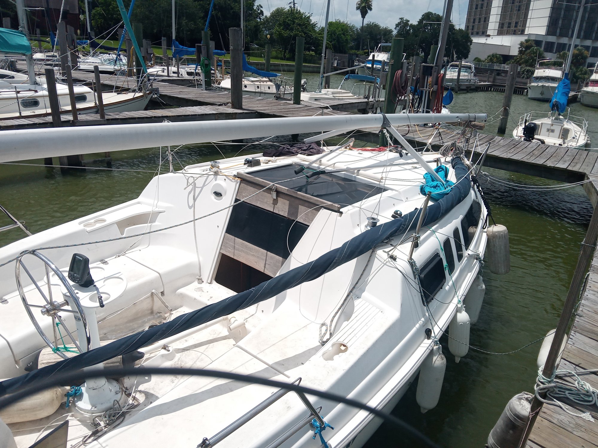

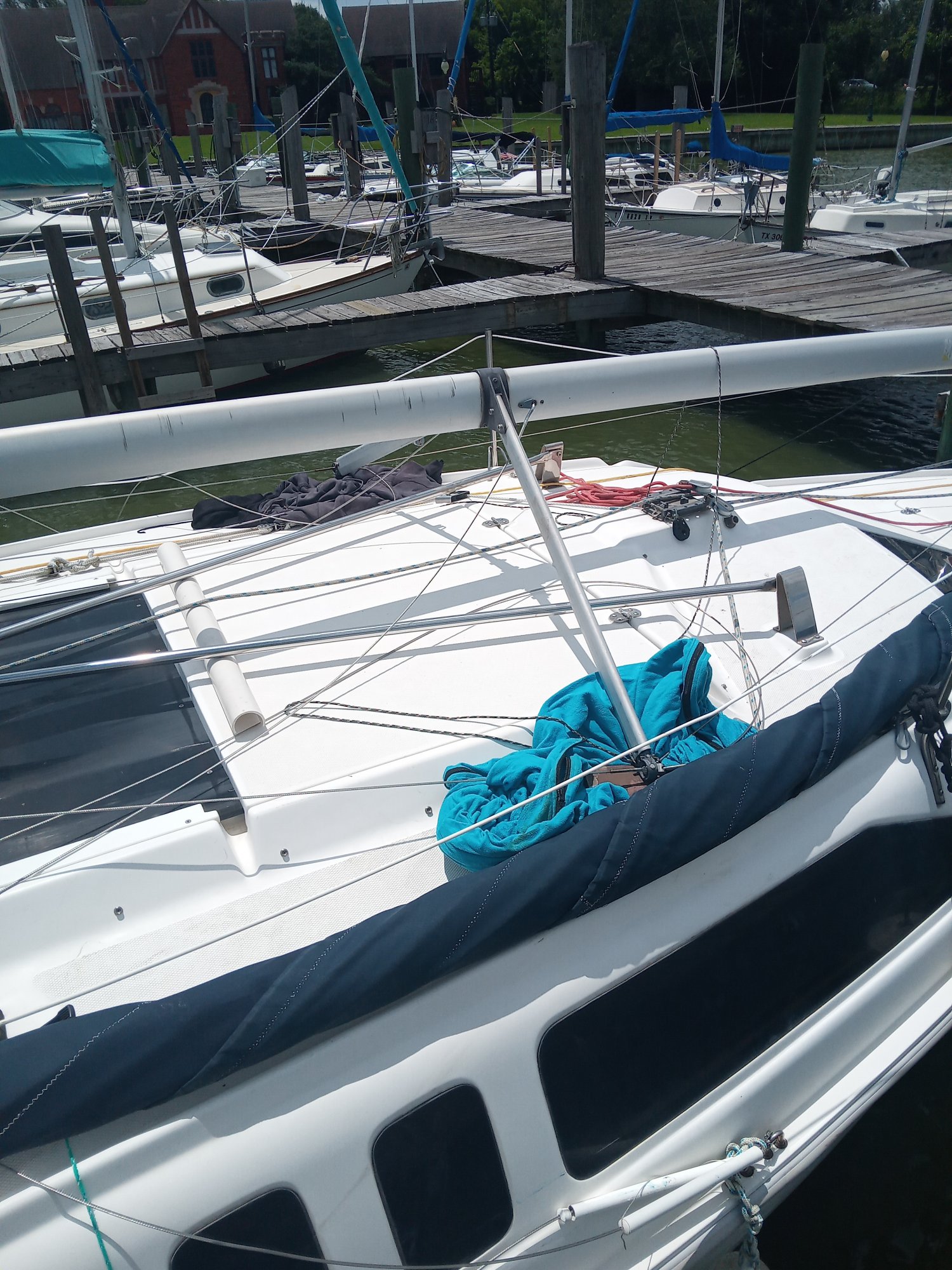

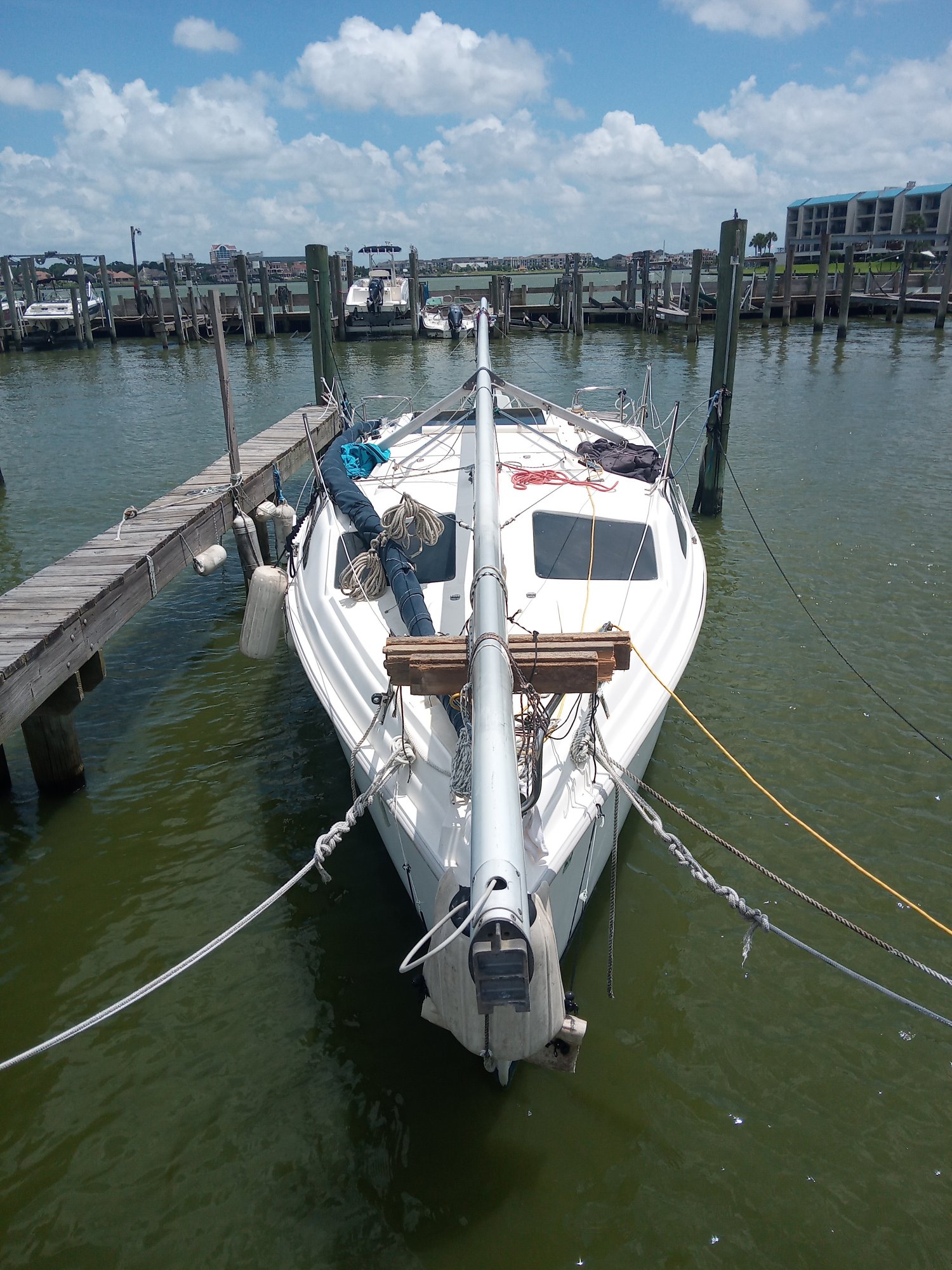

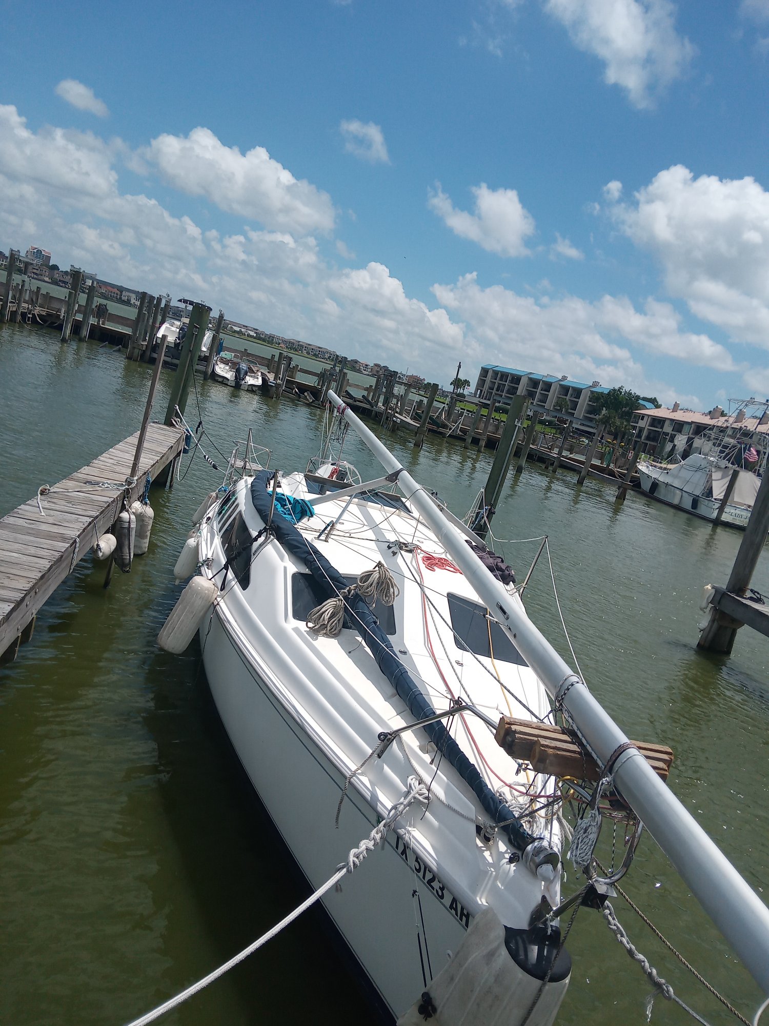

Still tinkering, want mast spreaders to just kiss some plywood and blankets. Will later try sliding a bit to reconnect mast side braces, later. PICS.
