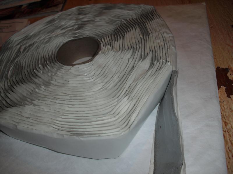

Hi Maine, I posted here cause I could not get a pic to load on your original thread. I have some butyl tape from a previous job, can't remember however, its about 3/4" wide, heavy 1/8" thick, very pliable grey tape. Is this what I should use for bedding deck hardware. Thanks Red

Butyl would be much more appropriate for this purpose. There is a lot of difference in sealing threads on a pipe and filling a moving void.
