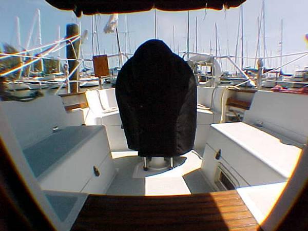

Thanks Rardi, that clears up a lot of preconceptions. It would be interesting to have them side by side for a close inspection. Not sure about the cockpit difference(pic). The links to the two H36s in the other post looked very similar to mine. I can seat three across the back. Two on each side is butt to butt. From a distance, excepting the mid-stay, they look identical with the three larger and two smaller portlights. And of course the Cherubini lines which are probably perfect. :)
P.S. what't that other picture? Found it in my files.

From your pic, it still looks to me that the 37c cockpit has more fore/aft dimension than mine. When I depart from the ski slopes and am back in the nautical environment, I'll take some measurements of my cockpit dimensions so we can more accurately compare.
Sorry, but not sure what you mean by the other picture? If its the second picture attached to your post, hey that's my boat in its Sausalito berth!

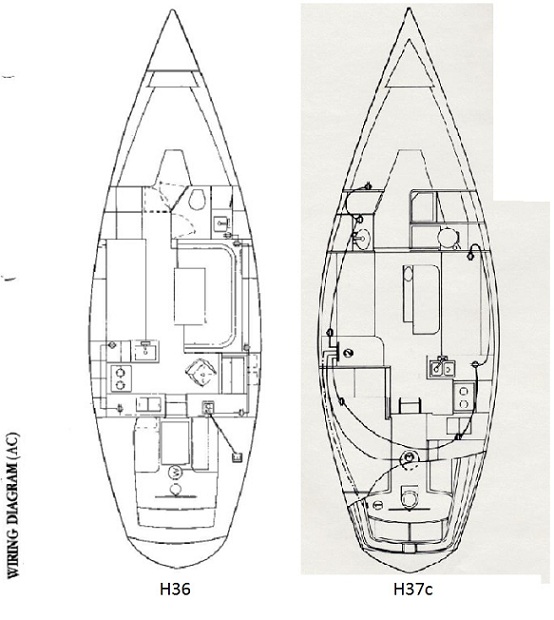

I'd like to correct Rardi on the '36c' label. The c in 37c is for cutter. Our 36's are not cutter rigs, therfore, they are just H36 not H36c.
For comparison of the plans I'm attaching a jpg of the two boats. Scale is iffy, the 37c is 6" longer and 9" wider. I'd be happy on either boat!! The port side lasserette has the house batteries and room to store fenders or what ever you are willing to place above your house batteries.

Neat comparison Jim, thanks. I always knew what Rardi meant with the 'c' designation. Very important distinction that Cherubini label. :)
