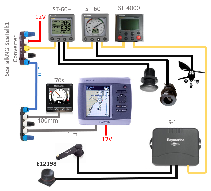

The ITC-5 takes the analog readings from legacy equipment (masthead fly, knot sensor, depth sensor) and converts it directly to SeaTalkNG, where you can display it on any multi-function display.
You will need a Seatalk-SeaTalkNG converter to keep your legacy autopilot and TriData display in the system.
With the state of your system right now, unless you want to eliminate the long runs of analog wiring through your boat, the ITC-5 will do little for you (except maybe give you more room in the tubes for the pedestal guard, since you can replace three analog wires with one seaTalkNG wire). The individual SeaTalk instruments will put it on the SeaTalk network, then the SeaTalk-SeaTalkNG will convert it so it talks to your Axiom.

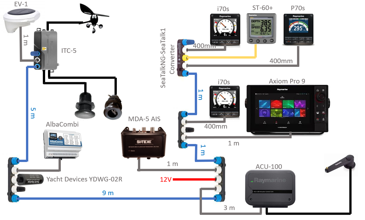

Here is mine after a series of upgrades has almost eliminated the SeaTalkNG converter entirely.
Likes: Johann
Jun 2, 2018
23
Catalina 28 mk ii Port Orchard
This was stage 1 of my update, that more closely resembles your system. Stage 2 was swapping the legacy chartplotter for the Axiom,
Likes: Johann
